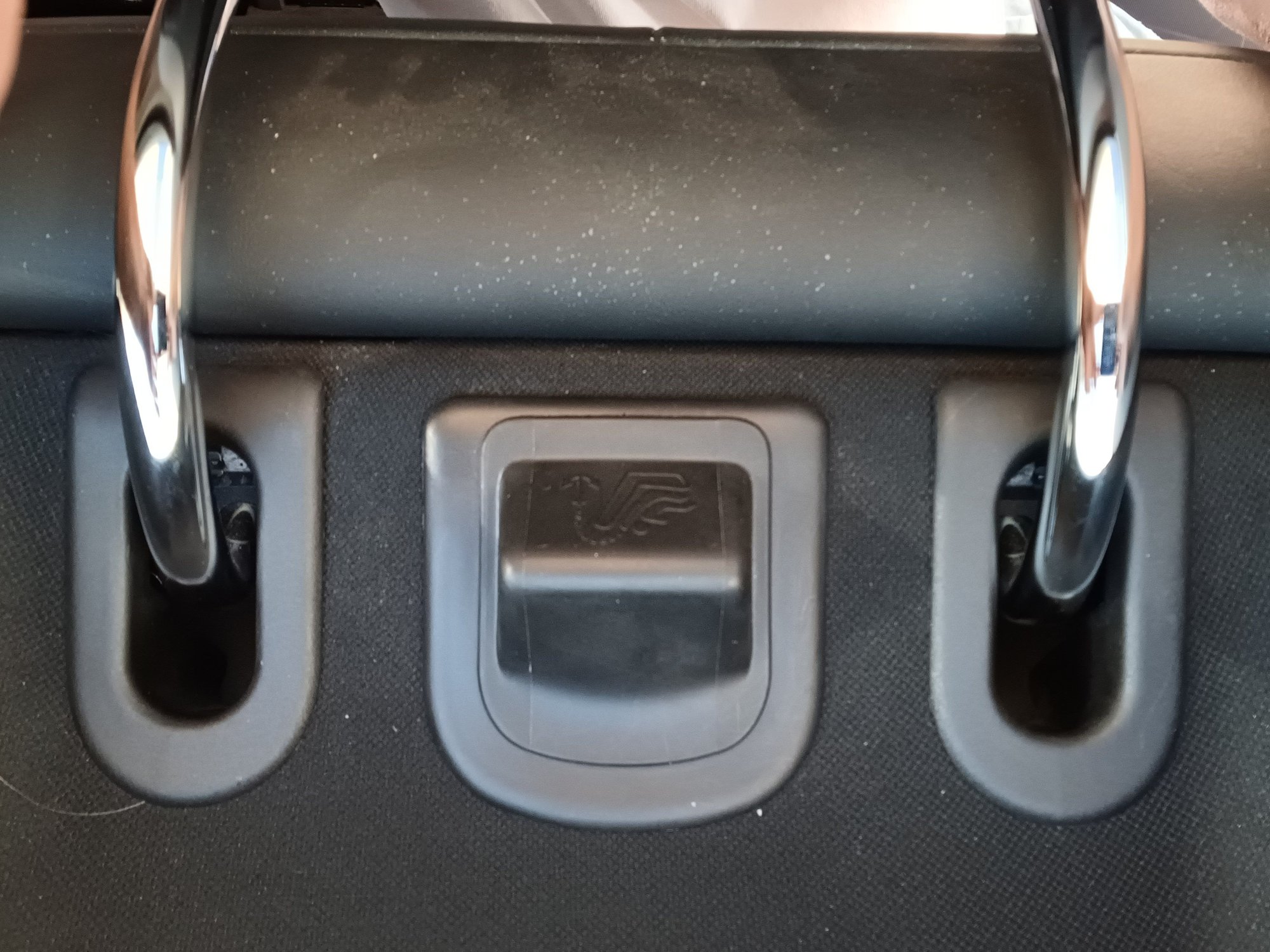

I just looked again at my headrests and don't see any tabs. I've attached a picture of where the headrest supports enter the rear deck. The removable plastic cap between the two supports is the anchor point for a child seat. Would you take a picture of your headrest tabs and post? Thanks, Ed
Base of left outside rear headrest. Center and right are identical.
Have a look at this YouTube video. I exactly as he did to remove his first headrest.
