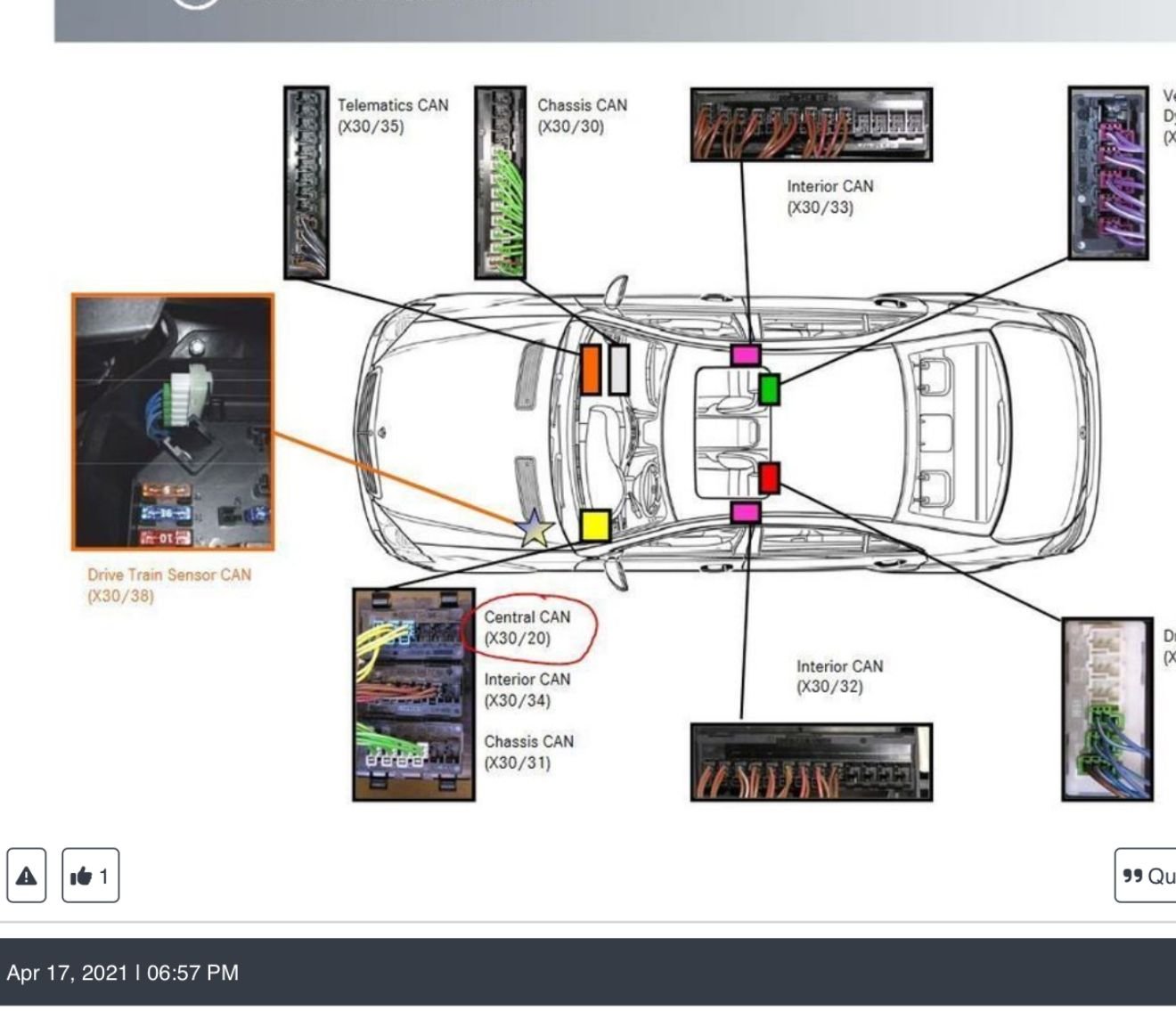

Water has compromised the Canbus distributor blocks under the driver's seat, as confirmed. By removing and repositioning the plugs, I was able to get the car started. I will share a picture from another member's post for illustration. However, cleaning the blocks does not give me full confidence in their functionality, so I have purchased new ones. The replacements include one under the dashboard and two under the seat on the left side, and two under the passenger seat on the right side. I still need to obtain part numbers for the Telematics Canbus block and Chassis Canbus block in the passenger side footwell and passenger floor.
I am interested in determining whether replacing the chassis CAN bus will resolve the issue with my electronic parking brake, for which I installed a new module two years ago but still does not operate. Additionally, I hope to correct the issue with my heating system, which is not functioning despite having a working air conditioning system. I have replaced the change valve for heat and all other components involved in the HVAC heating system, yet I still get no heat. A new radiator was installed five months ago, along with modules. I have also included a picture and would appreciate it if anyone could provide the part numbers for CAN bus telematics X30/35 and chassis CAN bus X30/30. Furthermore, I have cleared the issue of water leaking in by cleaning the rear sunroof drains, which can only be done with the headliner off.

How does water from the rear drains creep to the front seats?
Old Aug 9, 2025 | 07:56 AM
  #43
BOTUS's Avatar
Joined: Aug 2014
Posts: 5,322
Likes: 1,678
S500
you design specific capillary action in to the sound deadening material used in the carpeting (and of course place all the critical canbus junctions near the puddles)
it all comes from very technical engineering know how, including how much debris builds up in x years - so we get the water to reach the canbus just outside the legislation period
there is absolutely no doubt the level engineering and dedication around the design and build of these cars - its just for the last 35 years none of it has been to help customers

Here is the answer. When blockages occur in the front and rear sunroof drains, water flows between the front and rear, leading to its descent down the B-pillars. Water inherently seeks its own path. During the radiator replacement process, my Mercedes mechanic identified signs of water ingress, including moisture under the front two seats. However, as starting the car did not pose an issue at the time, he did not conduct a more in-depth examination of the CAN bus blocks. Following the removal of my headliner install the stars, the installer cleaned both front and rear sunroof drains, and it became apparent that this water issue has been present for some time. Fortunately, I have identified this issue in a timely manner and will perform the necessary cleaning and part replacements. It is fortunate that this vehicle is not used on a daily basis, as I have other vehicles available. One advantage of the W221 model is the ease of obtaining replacement parts.
QUOTE=Senecat;9198742]How does water from the rear drains creep to the front seats?[/QUOTE]

I've discovered a minor issue with one of the brown wires, which appears to be partially damaged. While awaiting the arrival of the CANbus blocks, I intend to perform a repair. Can I simply restore the wire's integrity with a small amount of solder? My proposed solution involves cleaning the affected area and either soldering it or utilizing waterproof heat-shrink butt connectors. Hopefully, the combination of the new central gateway and CANbus blocks will resolve the issues, allowing me to enjoy my vehicle. I've acquired the latest part number for the central gateway, which was successfully provided by Ninjabenz.

On today’s episode of w221 won’t start, I detected further corrosion on the pins situated near the CANbus block's circuit board. Despite meticulous cleaning, the issue persists, failing to attain 100% resolution. This morning, the vehicle started without issue. However, after shutting down and remaining stationary, it failed to restart. I observed that repositioning the plugs on the CANbus block eliminated certain error messages. My theory suggests that the chips or resistors on the board are malfunctioning, causing the CANbus block to lose communication with the central gateway due to overheating. Consequently, the vehicle likely remains in 'drive' mode, preventing a restart. Hopefully, obtaining replacement parts will rectify this problem. Additionally, I successfully placed a dehumidifier within the vehicle to remove moisture from beneath the carpet.
