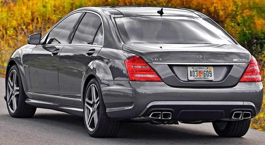

Hi all. I have ordered a set of clear led taillights for my 2008 Mercedes s550 4matic. I didn’t realize the wiring was different as these ones were meant for a newer year version of the w221. What wires would I need to swap/cut and solder in place of each other to make it all work? They currently turn on but seems the brake lights are illuminating the daytime running lights and vise versa with daytime running illuminating the running lights

Man that is ugly as sin.
I hope the taillight on the photo are the ones you are replacing.
Anyways... search for "w221 facelift taillight retrofit" and you will find loads of information.

Originally Posted by Proling
Jaap how is this any better - anyway we need to see with the lights on
