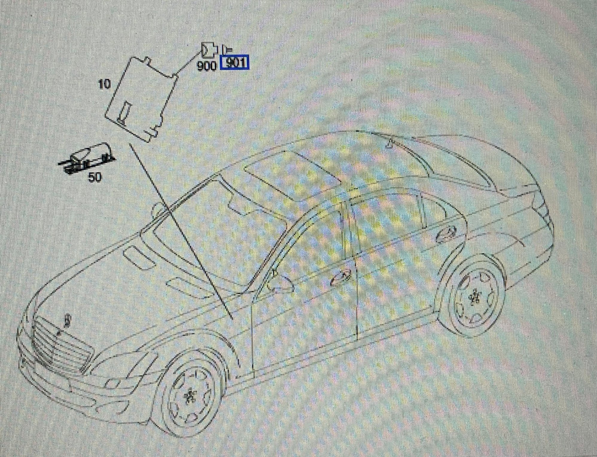

Originally Posted by BOTUS
just worked out why you think its not above the throttle pedal - if you are LHD, your steering wheel is in the wrong place - which also means the pedals are in the wrong place
Ha, ha, ha…I think you have them in the wrong place. So in UK the throttle is still under right foot though everything else is reversed? This explains why your CGW is above gas pedal while in the CORRECTLY MADE CARS it is above the left foot😜.
But google search still says in the 2006 model it is below floor under the seat.
If OP has it like in mine he should be checking it before spending time with anything else.
well I checked the EPC for my car and it also shows near or under the dashboard left side with a part number A2219006702. I see there is a condensor A0009820404 with it, could this also cause faults without showing?
Thanks for keeping your attention on the CGW and will definately check it as well.
Even if at the end it turns out not the be the cause of my "short to positive", its a valuable info to have it in mind for any other erratic faults!
Just disconnect/reconnect it to see if it changes anything. If it does you have loose pins.
