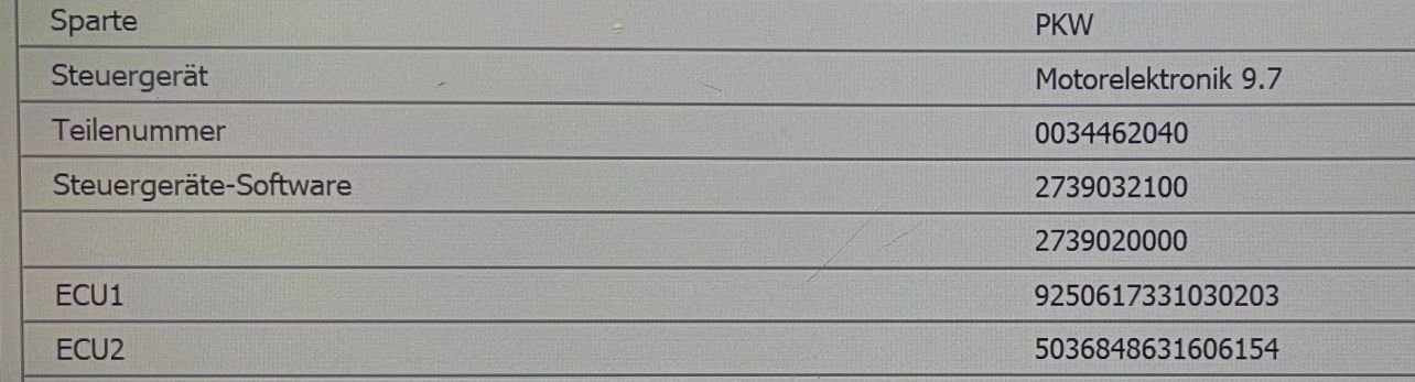

enclosed is a picture of ECU data. I guess that is the next step. They have shops here that repair ECU (if possible) and will send it there to have a look.
I have a used ECU as well, they might be able to clone it if necessary....

quick scan - then press F8 you get a nice printable doc of all modules on the car with Part number, Hardware, Software versions and dates - delete the junk errors or printout will be twice as long and full of lies

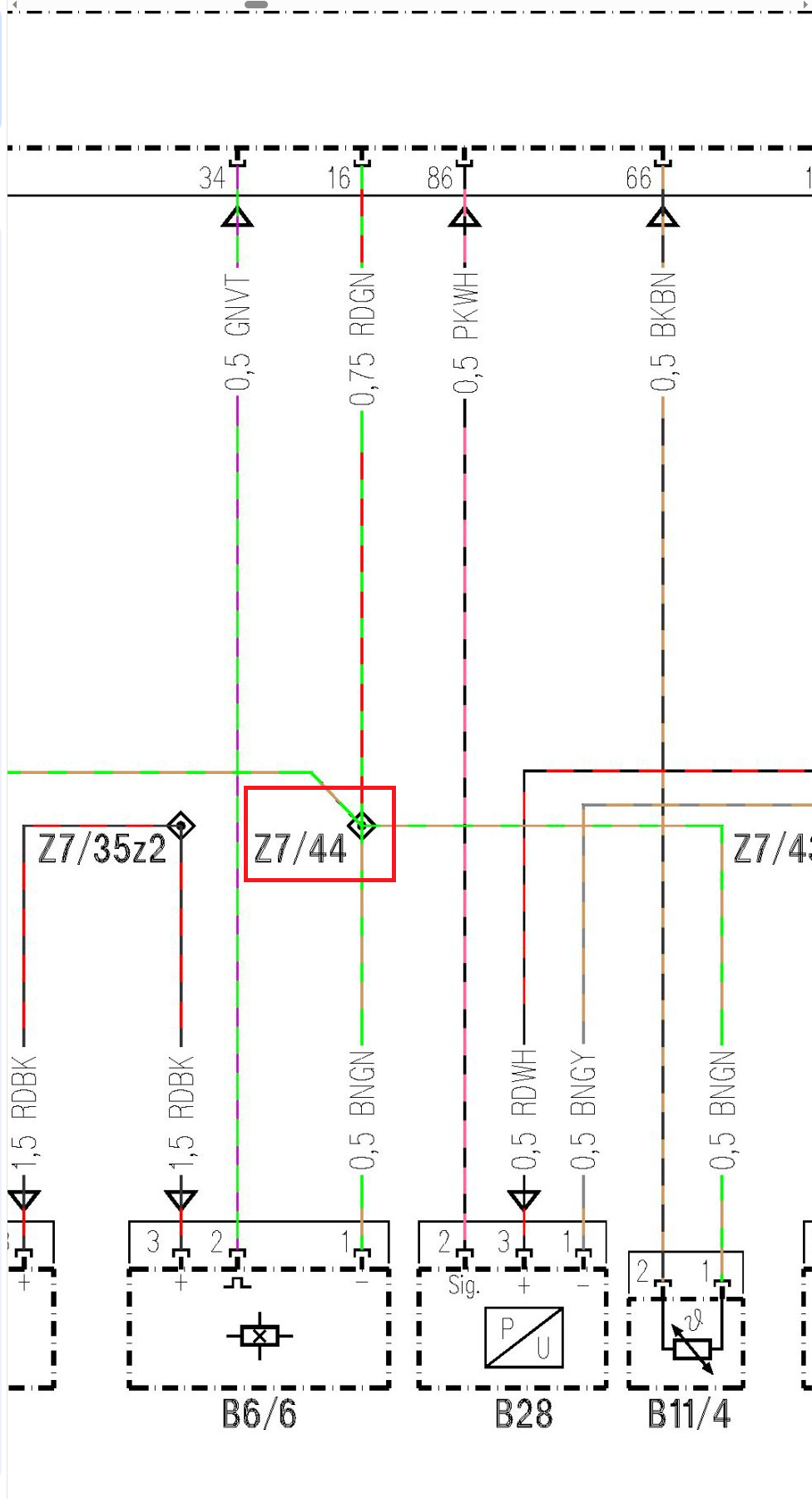

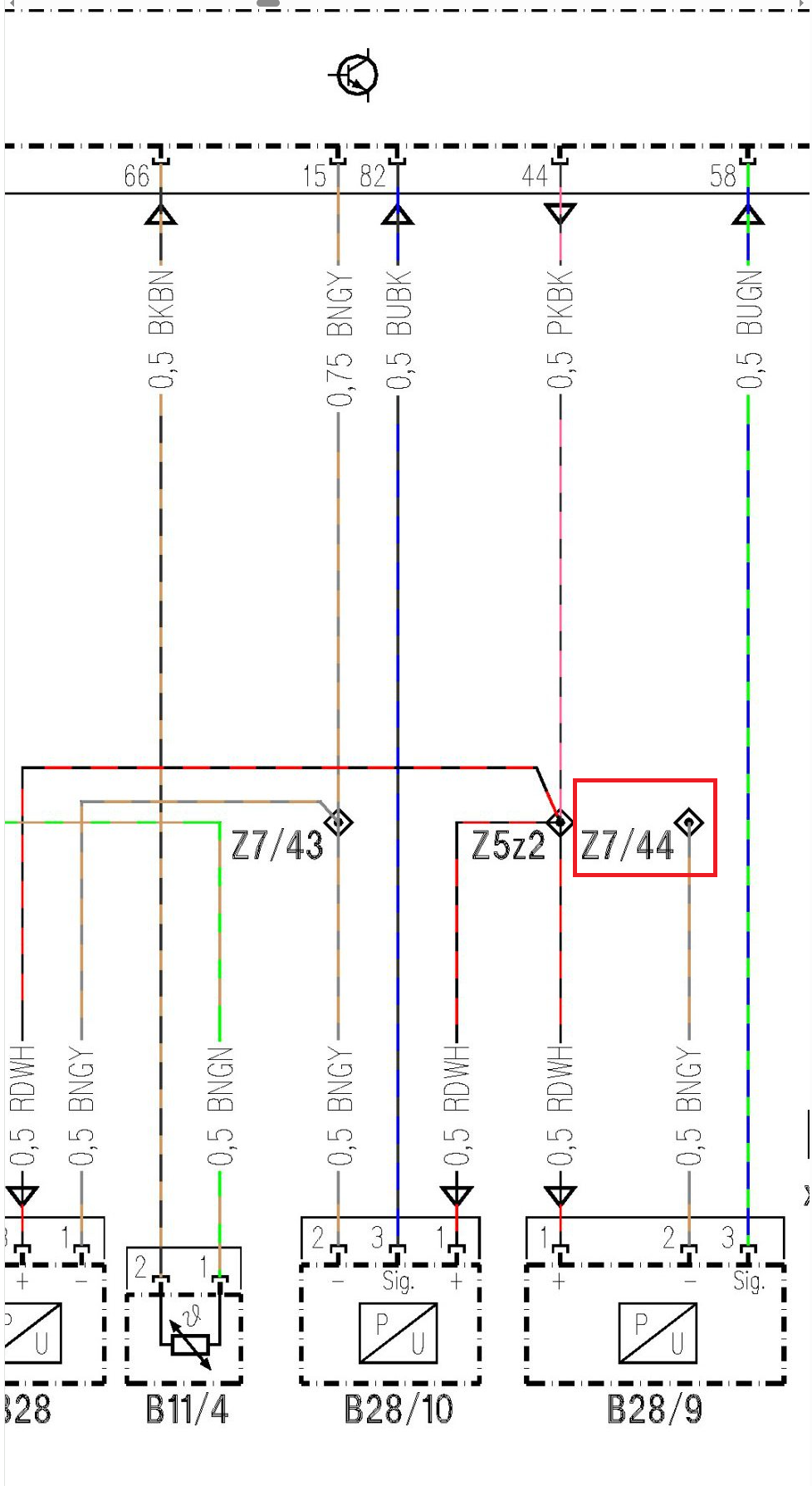

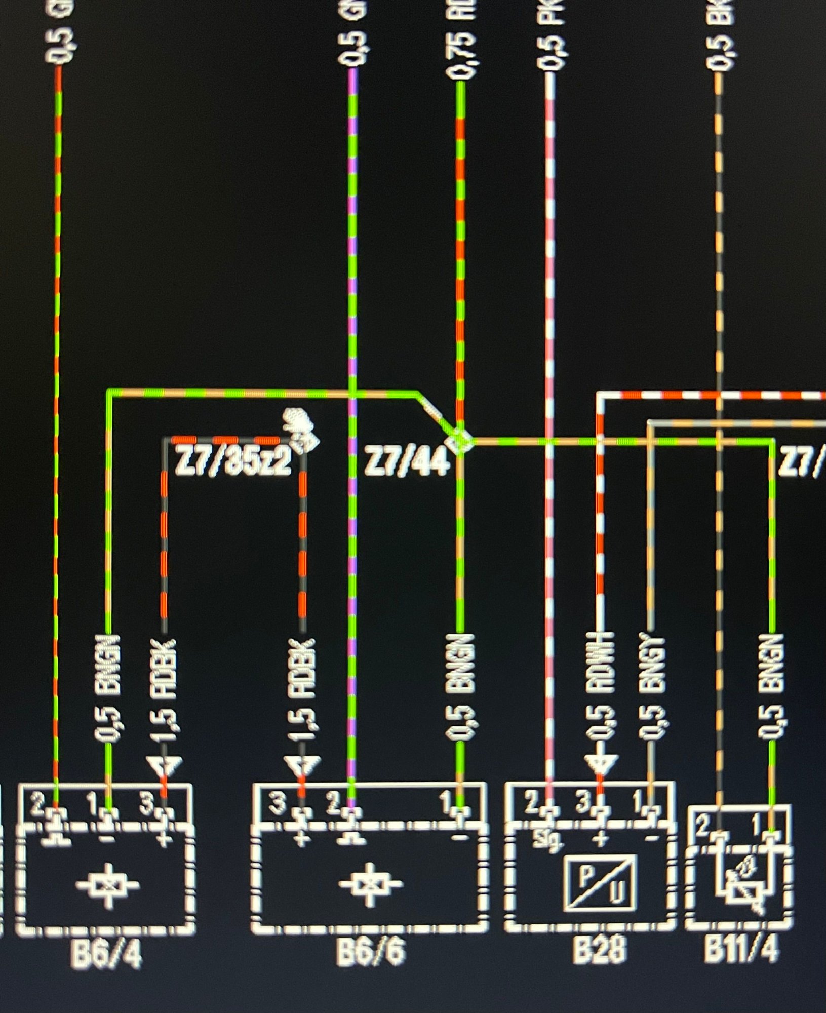

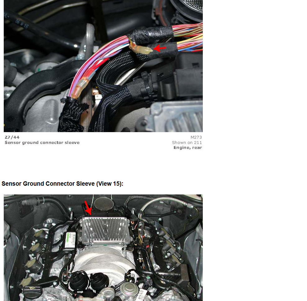

I mentioned in the other thread how the cam sensors, coolant temp sensor, and one of the tumble flap sensors all have the Z7/44 Sensor Ground Connector Sleeve in common.

I have one more idea, what do you think of it?
- the fault codes seem erratic and came quickly within one day.
- They quickly come back after deleting the fault codes, especially the coolant temperature sensor P0118 (with a permanent running fan) allready starts upon ignition.
- all of them in the engine area within the same ground (as mentioned by TimC300)
- the engine runs smoothly and normal, temperature is shown as always.

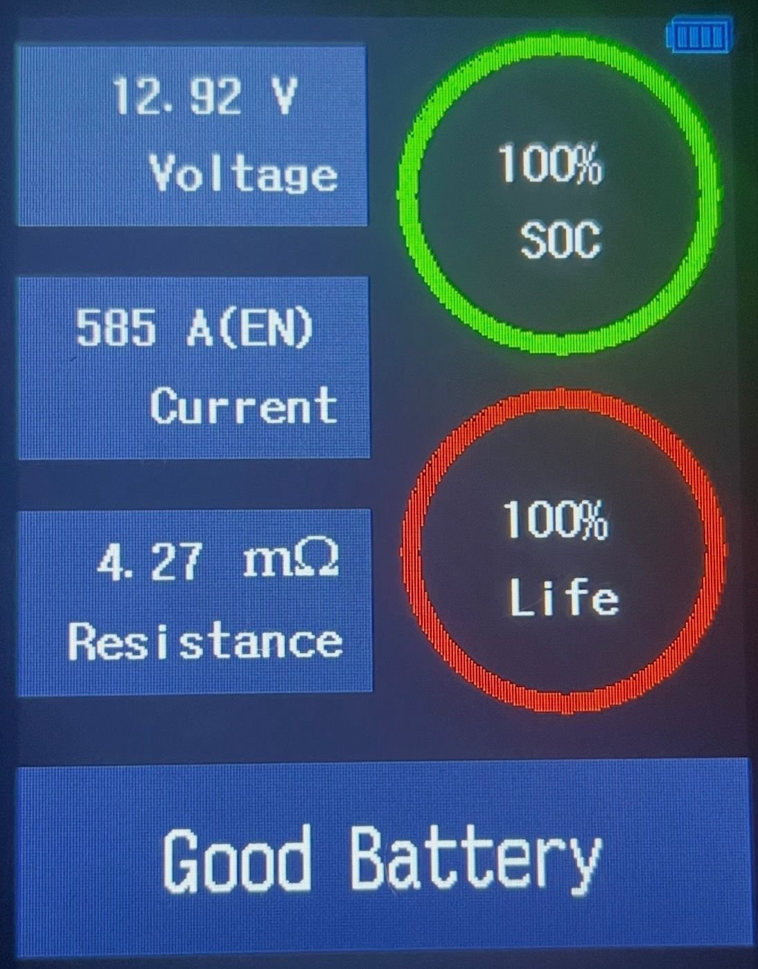

Could a defective starter battery trigger those erratic codes upon starting, as the engine works normal after that. I do not have a special tool to check the battery more closely, from voltage its in the lower end of OK.
Could the i.e. ground be interrupted or impaired upon ignition due to defective starter battery and trigger those faults? I just want to rule out anything else before I cut through the harness.
thanks for the detailed and valuable info!
So you recommend to get to that cable and check if it is worn/torn or has other issues? Wouldn't there be something noticeable in the engine or sensors running bad or so if a permanent ground problem was there? I am just a little hesitant to go into the harness but will do so if necessary.
I first thought of getting a new starter battery to rule out anything from there (as engine runs normal and sensors show normal ratings in xentry). But had a chance to check with a tester and it seems OK.

Starter battery starts the car and basically nothing else, box of trick above rear battery manages whats going on re charging / support in odd situations
Duff rear battery will often cause the whole car to get a muddle on
20 mins key on interior blower motor off, exterior lights off, is enough to kill and brand new fully charged 100 amp hr rear battery

so CGW is accessed from the side or under the dashboard?. I went with some part number to find out what it is, well what I found seems something else under the driver seat. Does anyone have a CGW part number so I can find the reference to my car?
for now I will check the ground Z7/44 as it is connected to all sensors with the short to plus fault. I might have pulled to hard on that ground cable when I changed the plug 64/4 recently and soldered it a bit for now.
Next will be CGW and ECU....
