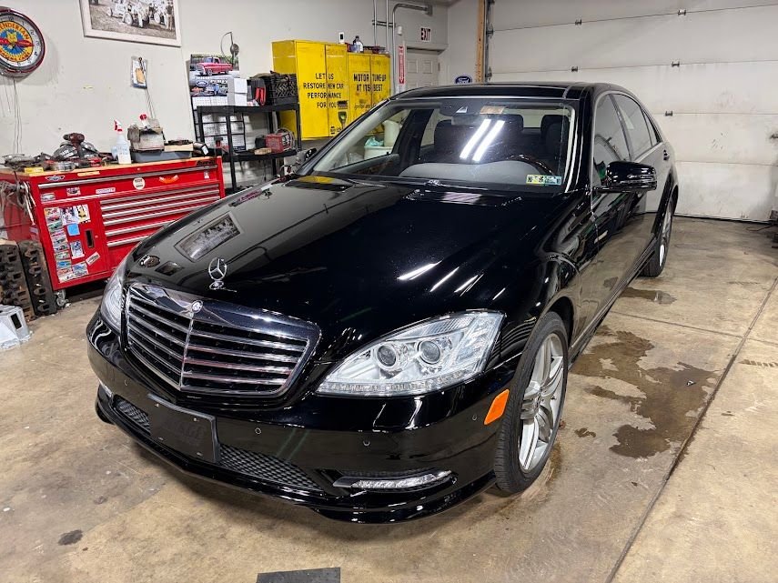

Btw, how the hell did you find a '13 with so few miles? What was out the door price? Any pics?
Clean car!

Awesome info. Thank you for sharing that! Helps me a ton! I have been looking for YEARS.... finally found one locally. Will post some pics!
