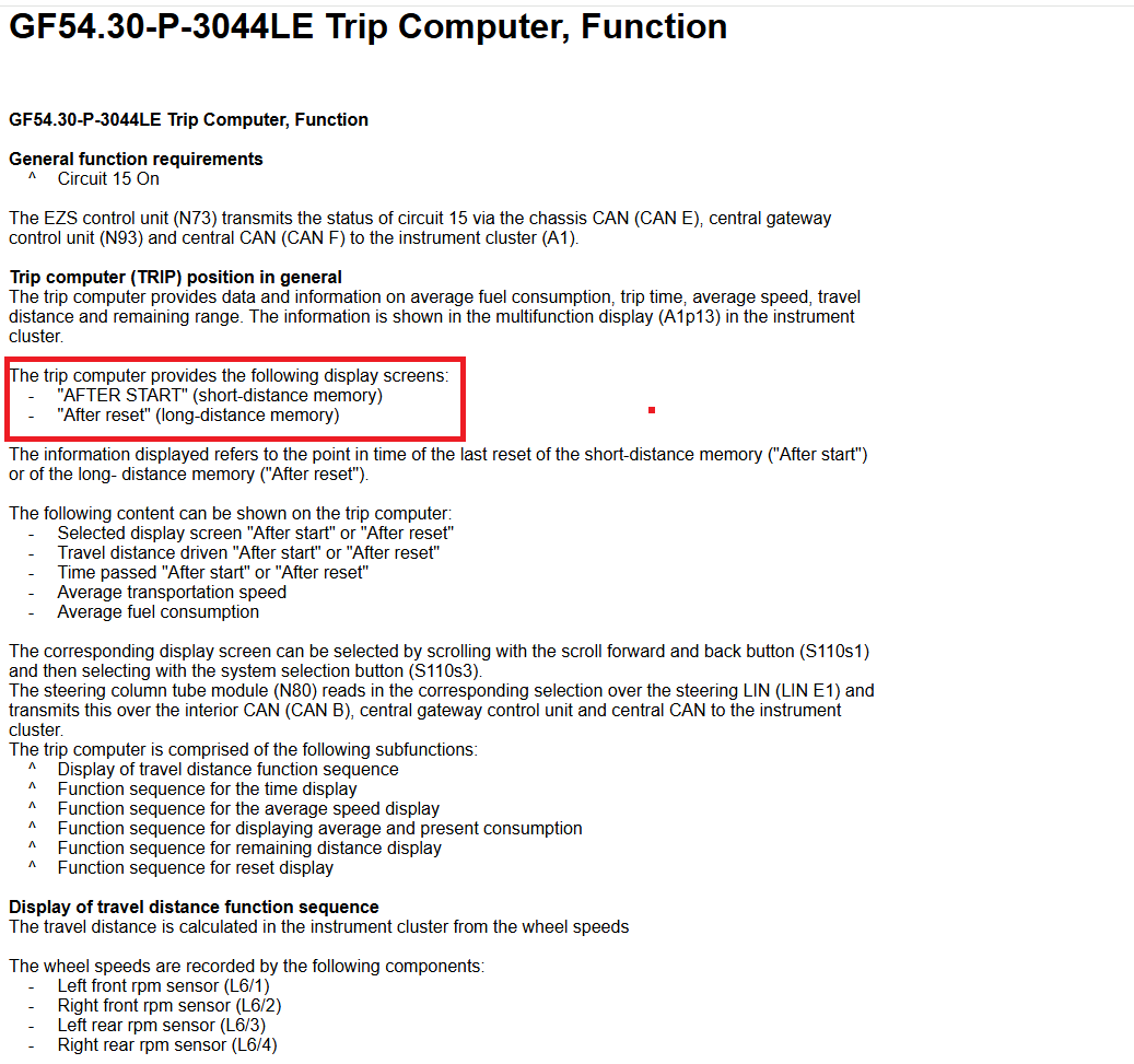

there is the overall odometer - storing the total distance the vehicle has covered - without factoring fiddly fingers or replacement with secondhand parts (this is also stored in a number of other components and where legit all should match).
then you have two separate trip recorders you can reset independently - these record the current trip and carry on counting again for this trip if you do key out for less then x (about 2 hrs)
if you never reset the display of the short term trip you are using (1 or2) - as shown below the odometer - it will be a cumulative result for ave mpg and distance etc.

There should be two. After start and after reset. Are you saying you are seeing a 3rd trip counter?

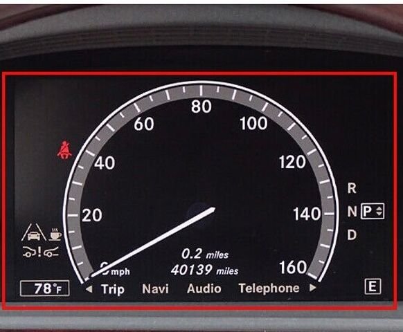

I am talking about the after reset display and the trip display below showing 0.2 miles. This is a generic photo, not from my car. I am talking about numbers above 1 mile. They are different mileages after resetting at the same time.
