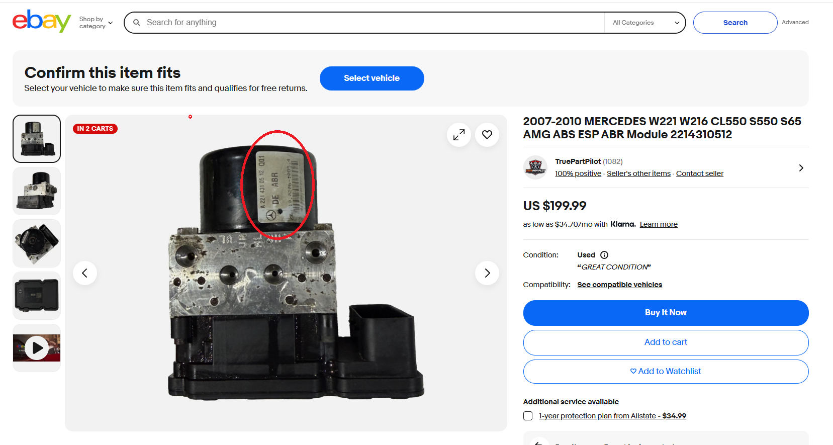

i had previously reached out to garageman on ebay and provided VIN and they replied they did not have a unit for that VIN. Would any unit work? I am trying to not have to recode the unit. I wont be able to and at the point will just be swapping one dash warning for another if it throws a VIN mismatch, correct?
For this one, it is possible it doesnt need to be coded, but also possible it may need it?
Says its for 4matic, but i know its VIN associated, correct?
2007-2010 MERCEDES W221 W216 CL550 S550 S65 AMG ABS ESP ABR Module 2214310512 | eBay
Old Mar 6, 2026 | 05:42 AM
  #42
AL5461's Avatar
Joined: Oct 2023
Posts: 622
Likes: 211
W221 S500
Without knowing your VIN, and therefore using EPC for ALL the options for 550 4matic, that unit doesn't match any of the numbers on the part you linked to.
GarageMan (and others) all clearly state that electronic components may require programming.
All the ECUs are created equal with the same software. The various parts numbers essentially refer to the boxes ticked within that software... ie 4matic/Distronic/Armoured/engine size/wheel size etc.
Even if you bought one from MB for your exact VIN, yes it would be box ticked appropriately for the exact configuration your car, it would still need to be plugged in for it's initial installation coding and software update check. A used unit is also going to be full of fault codes just from being disconnected. So if you think you'll get away with fitting a unit and it working 100%, you're dreaming.
Any vendor will say it doesn't match your VIN because they simply don't want the responsibility for getting it wrong.
That one from Iowa will almost certainly work, but it looks like ****.
Personally, as it's relatively local and as you're going to ignore my advice regarding using a second hand hydraulic unit, I would buy this one:
https://www.ebay.com/itm/257390548246
The reasons are simple:
1. It's easily one of the cleanest units for sale.
2. All the lines are fully crimped closed meaning it won't have been sat open to atmosphere at all, so might actually still function.
3. Just fit the electronic part to your unit and fit your dead electronic unit back onto this hydraulic block to protect it. Then, in the extremely unlikely event you actually need the hydraulic unit, you have a decent one ready to go.
4. It's in the same state, so less chance of it getting smashed to bits during shipping.
If you want an accurate selection of parts numbers I need your VIN, and there's a chance I will be in Cali twice in April, if you say approximately where you are, I can adjust my schedule accordingly. If not, I'll be sat by a pool drinking Margaritas in Vegas.
Whatever part you buy, please at least use your eyes when making the decision.
You're throwing darts blindfolded here. To get the correct part number for your car, the VIN is required. Without the part number, you're setting yourself up for failure searching for things on eBay. The other thing is that the same part number can run software for a rear wheel drive, 4Matic or other variations. You may have the right part number but the software may not be the same. This means in addition to the part number that corresponds to your VIN you also need to know what software your current module is running which is something you use DAS/Xentry to determine, though other diagnostics tools may provide that information. I use DAS/Xentry and I'm not familiar with other diagnostic software that can used with these cars.
To summarize...
1. You need your VIN to get the correct part number
2. You need to interrogate your current module to determine what software it is running which will be different depending on how your car is optioned
3. With the information from 1 and 2 you can begin searching for a used part.
Are those the part #'s that you have in your car?
When I was having the abs warnings pop up in mine I was thinking about either getting a used unit or send mine out. I used the part #'s to get pricing. I also noticed my foxwell scanner let me go into the abs and get the part #, which is just the same thats on the label.
