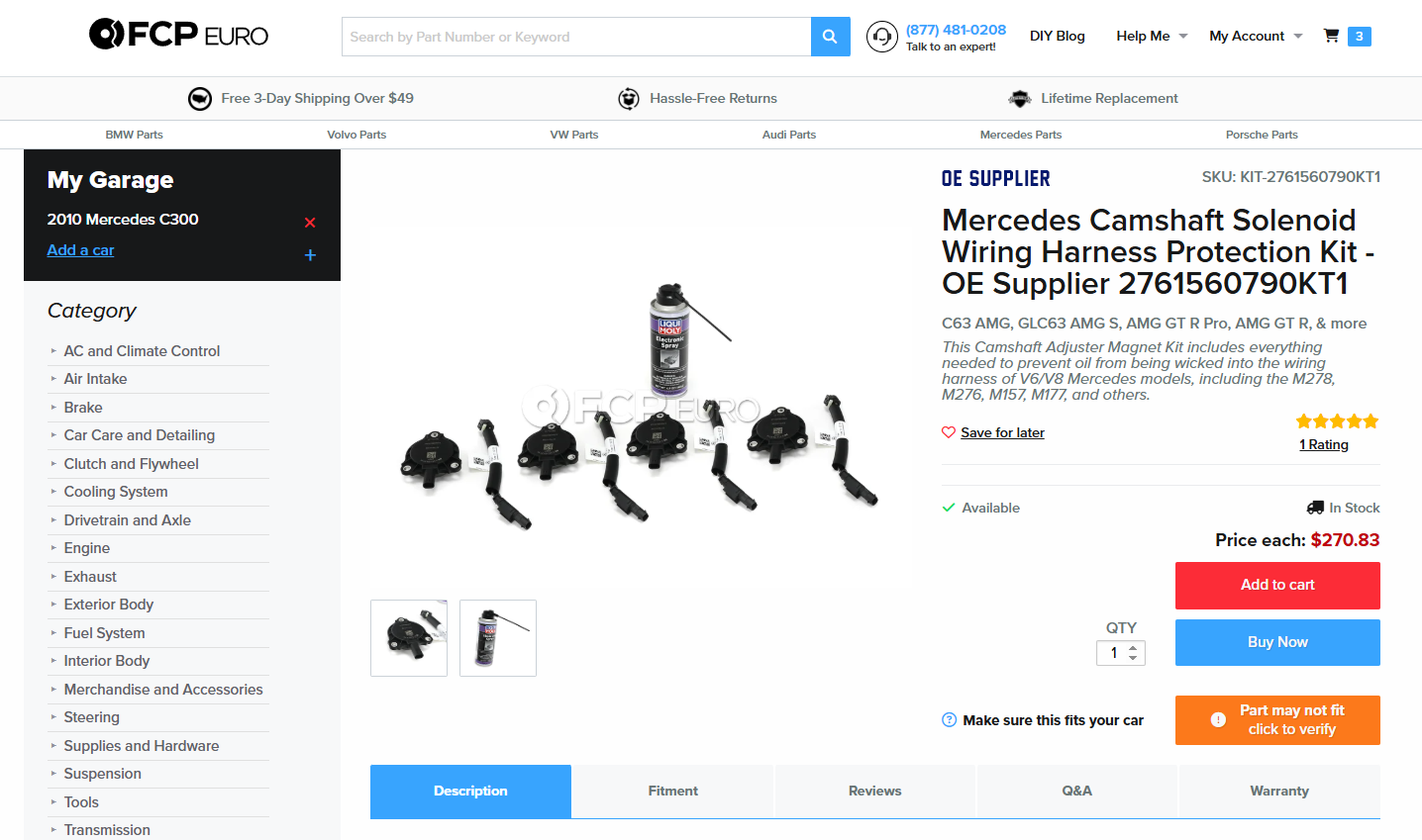

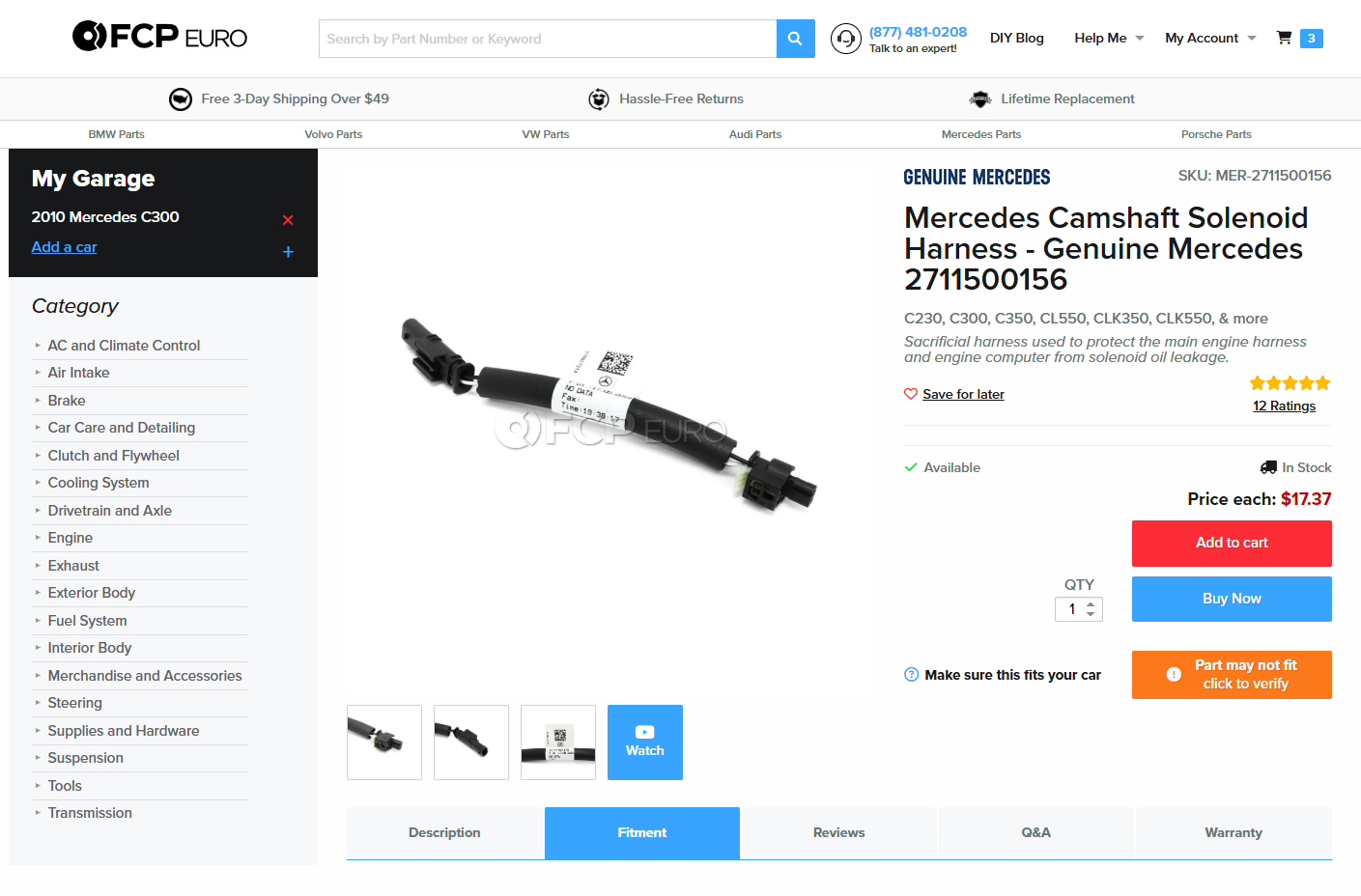

Do you see signs of oil in the camshaft position sensor harness or in the camshaft adjuster harness?
There was a "fix" with the M272/273 where an additional harness was added to the camshaft adjuster harness. Im not sure about the camshaft position sensors.
It looks like its the same harness for multiple engines, 272, 273, 276 etc.
What engine is in the S350, M276?
