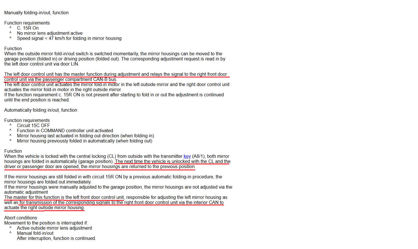

Looks like the drivers side front door control unit is responsible for transmitting the signal over to the passenger side front door control unit telling it to open/close the mirror.
Have to figure out where the issue is. Is the drivers door control unit sending the signal, is the passenger side control unit receiving the signal and not doing anything with it?
I dont have electric folding mirrors so i cant check. But i do have heated mirrors and with my Foxwell obd scanner im able to function test them.
I have limited electrical experience though know how to test for voltage. I'm unsure how to test for can-bus signals.
