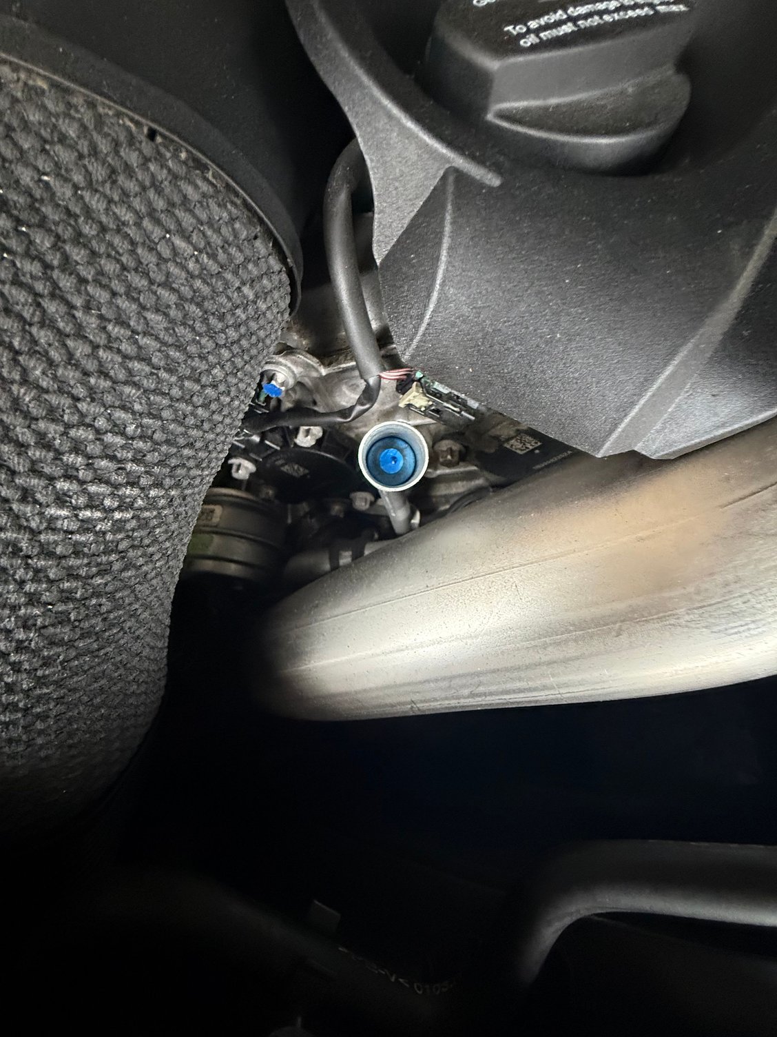

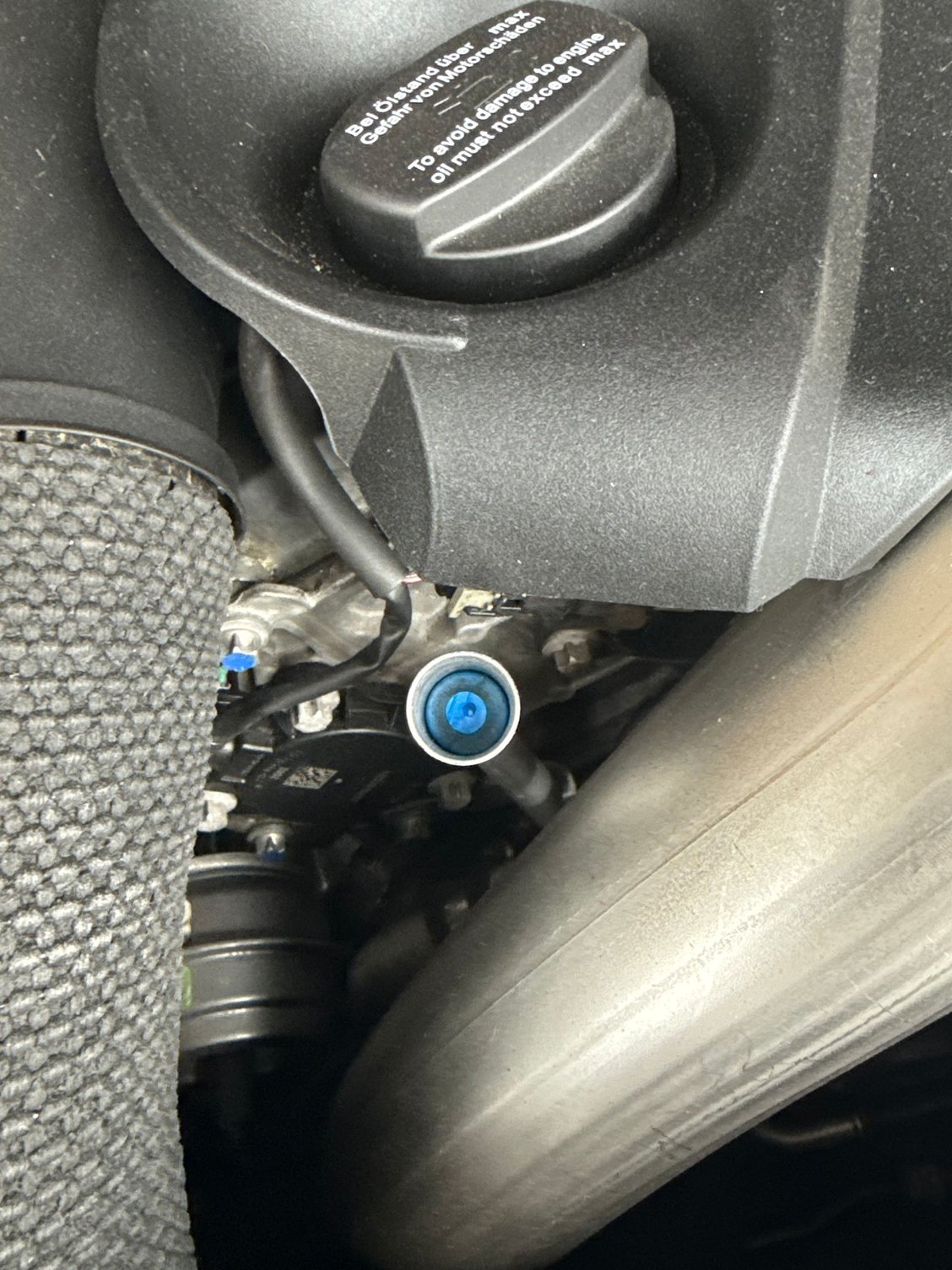

2. Broken Oil Dipstick: This is the most annoying part. I went to check the oil and the handle is completely snapped off. Not only that, but the rest of the stick is shoved all the way down into the tube so I can’t even pull it out. I looked it up and it’s a $100 part. It feels like someone was just being reckless under the hood.

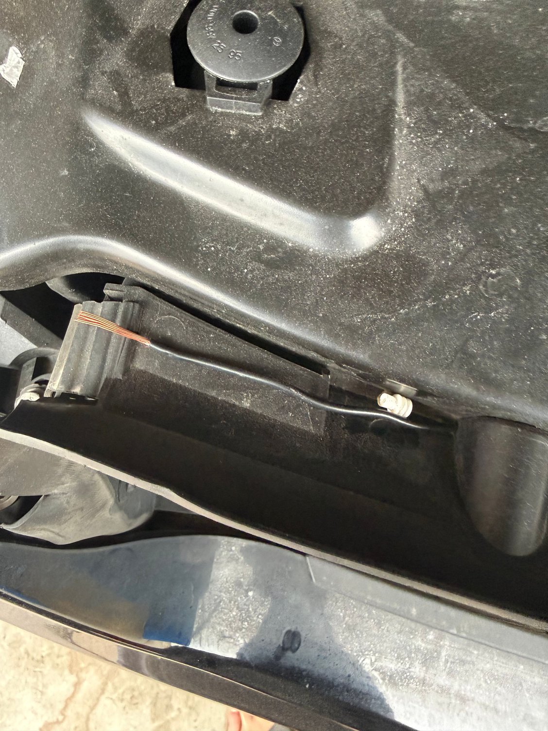

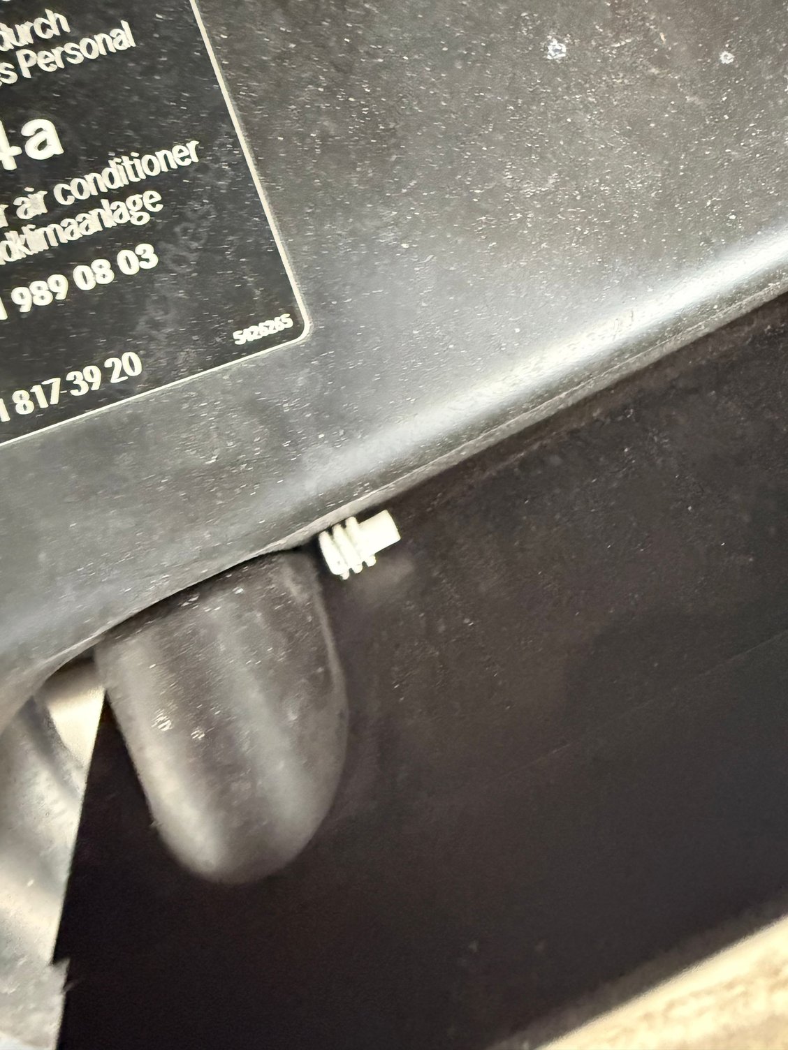

3. Cut Wires and Loose Screws: I popped the hood and found a wire that was clearly cut, just sitting on top of the radiator support, along with a couple of loose screws. I have no idea what it went to, but finding "extra" screws and cut wires after a "professional" inspection is a huge red flag for me.

Your car has many components made of plastic. What you ask happens to plastic with age and many heat cycles? I’ll help... It gets brittle.
Your fifteen year old dipstick broke.

What is the wire? Looks like what remains of a brake wear sensor that got replaced during a brake job.

That is the most creative placement of a used brake wear sensor I have seen in a long time.

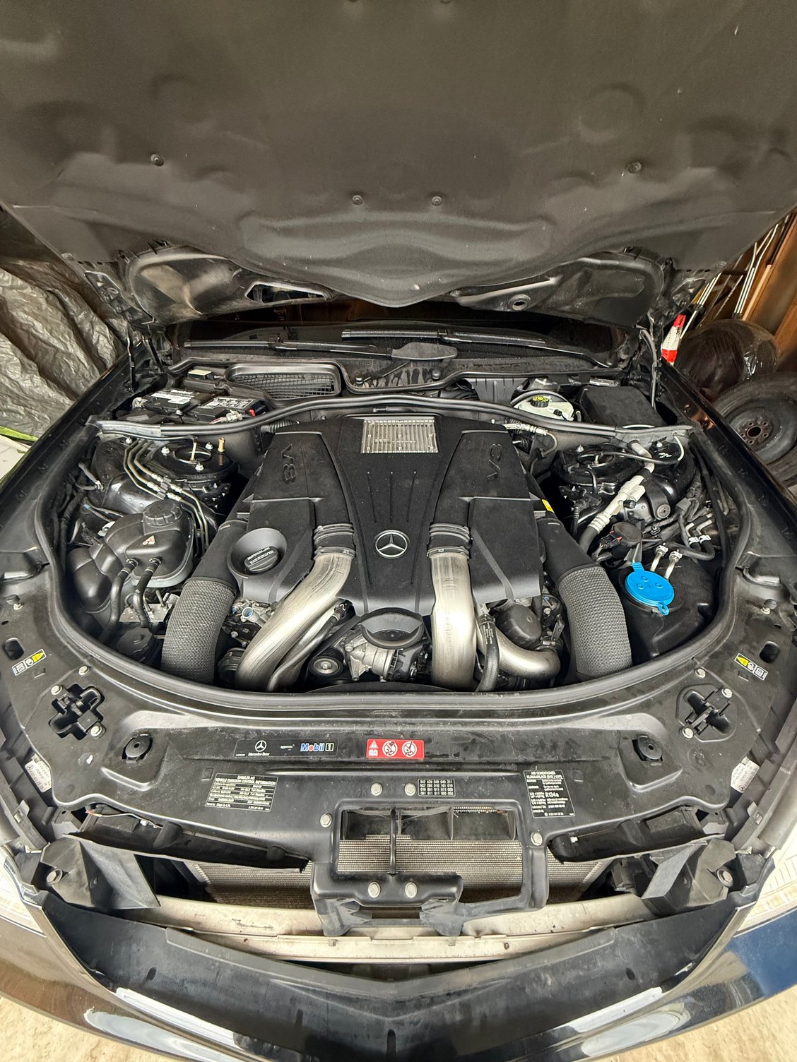

Orange liquid on the turbo V8 could easily be coolant.
Those white things could easily be the weather seals for electrical plugs.
