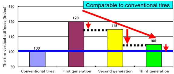

Anybody know what "2nd generation" run flat tires means?
Have they changed them for 2015?

I just clipped this off the Bridgestone Corporate site.
When Bridgestone started mass production of run-flat tires in 1987, the tires tended to give a hard ride comparable to conventional tires because the sidewalls were thick and somewhat inflexible. In 2005, Bridgestone introduced its second generation run-flat tire that featured improved riding comfort through an improved sidewall-reinforced rubber.
Bridgestone's third-generation run-flat tires have adopted new technologies that further improve riding comfort. By application of these new technologies, the third-generation run-flat tires can reduce vertical stiffness deflection index* more than the second-generation run-flat tires and achieve riding comfort comparable to conventional tires. Moreover, they enable the development of run-flat tires in a wide range of sizes, including sizes that were previously difficult to develop.
Comparison of the riding comfort of run-flat tires by generation
The indices for each generation take the tire vertical stiffness deflection index of conventional tires as 100. Riding comfort improves as the value of the indices decreases. (Tire size: 245/40R18 93W.) Third-generation run-flat tires in this comparison incorporate new sidewall-reinforced rubber and new ply.
Wonder why Mercedes isn't using the third generation ???
