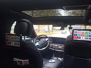

Hi Guys,
I own a W222 as a private driver in the Netherlands. Since the interface of the media in the car is disastrous and i didn't want to pay €1800 for a aftermarket tvset i've been waiting for the new apple tv to come out. It gives my passengers certain extra's during the ride. Play a game, watch a movie, documentary of my country or connect their iphone with airplay to listening their own music. All made really easy with the apple tv interface. Today i connected everything as a test setup and i'm glad it works Although i came to some things what i don't understand.
1. I would like to see that the command screen and the 2 screens in the back are showing the same thing. Is it possible to make that work ?

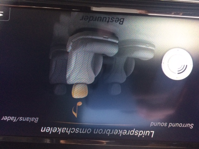

2. also it seems that when i am using the screens in the back the sound isn't connected to the command system. is that also possible that i don't have to switch between sources (see attachment)
3. when i turn of the screen in the back and turn it back on it doesn't go back in to full screen mode automatically. is there a possibility to fix that ? maybe a company who can alter everything mentioned above.
Thanks !

I wonder how did you connect the Apple TV to the rear entertainment system,since it doesn't have HDMI port and Apple TV can be connected using HDMI only.
Old Nov 7, 2015 | 10:18 AM
daveku's Avatar
Joined: Dec 2014
Posts: 5
S class 2014
Marmitek connect HA 13 av converter.
Old Nov 7, 2015 | 10:45 AM
Alishami's Avatar
Joined: Jul 2014
Posts: 77
S500 2015
What about power ?
Old Nov 7, 2015 | 11:37 AM
daveku's Avatar
Joined: Dec 2014
Posts: 5
S class 2014
Originally Posted by Alishami
What about power ?
The av Hdmi unit goes with a usb.
Right now the apple tv with a 220v converter. I'ts a test setting. Still need to find out where to build in

By default, Apple TV Audio output is based on the source audio; stereo for music and surround sound for movies/games.
A DA converter will not convert surround sound to stereo, so no audio will be output from movies or games, just music.
You can disable Dolby Digital but I am not sure if that does it.
That conversion to Stereo requires a Decoder to down mix the sound. Something like this (http://www.intelix.com/intlx_prod_de...item=DIGI-HDAC)
There are cheap ones but these typically cost more than the Apple TV.
