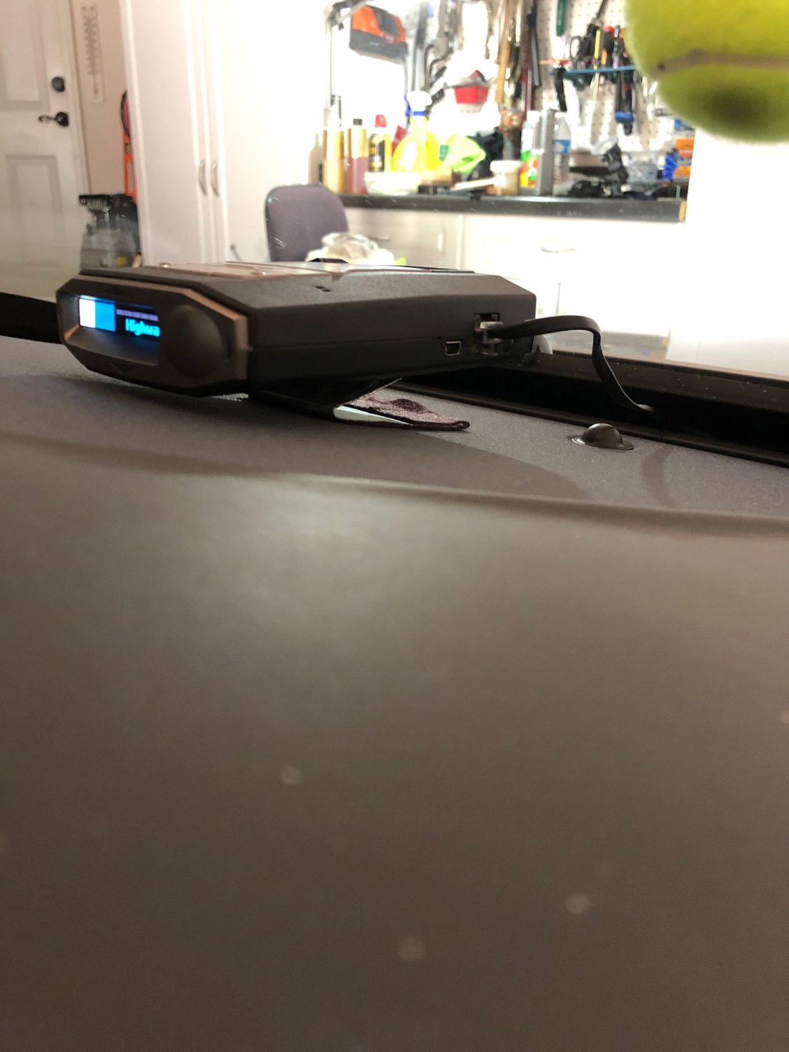

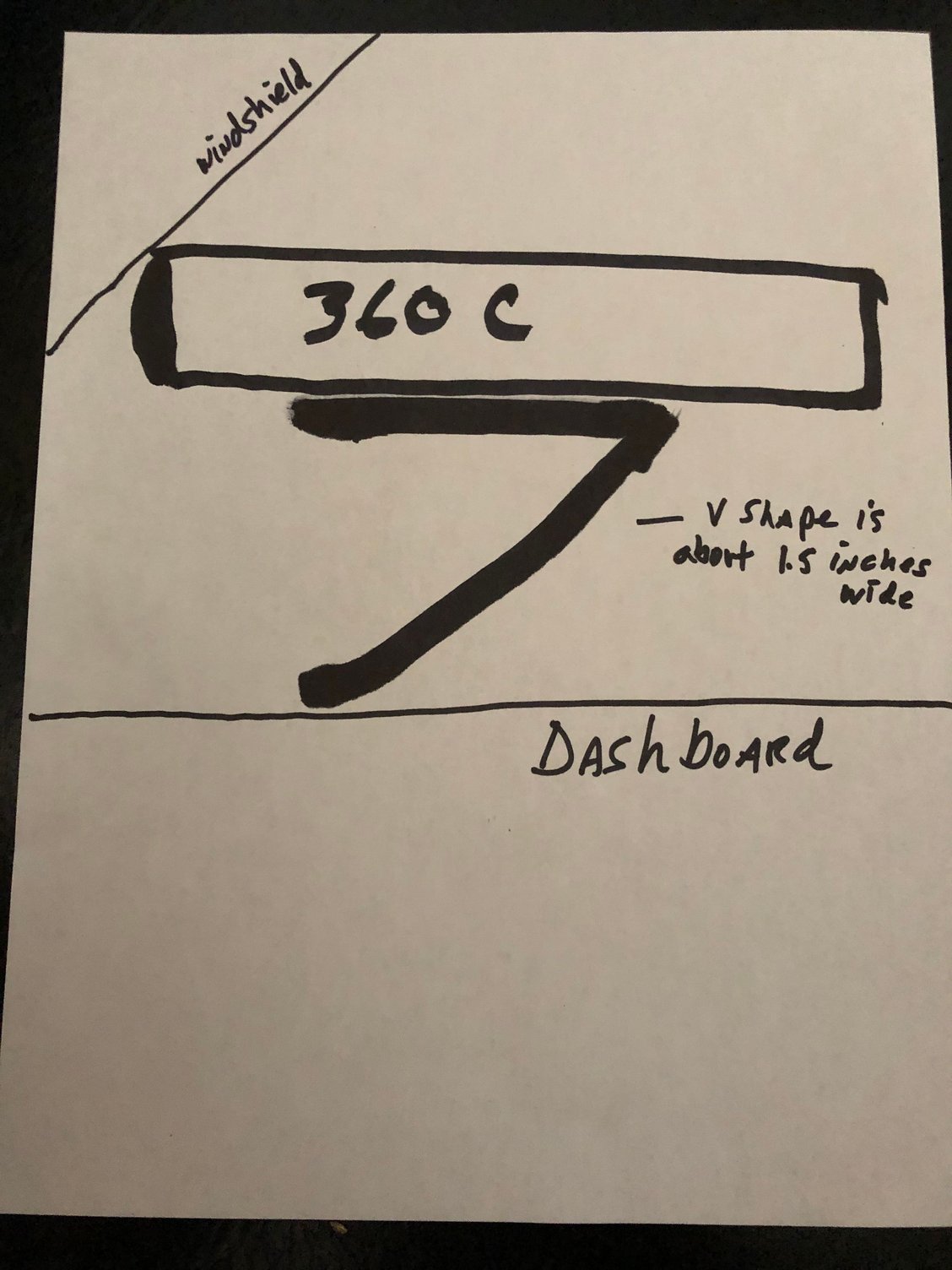

Max 360C Dash Mount (Lower Windshield/Centered)
Gents,
I'm a new '17 W222 owner, first MB, and loving it. Loved my LS460L that I just had too. I'm also VERY appreciative of all the advice on the various topics posted, it's excellent.
Like many, I've struggled with mounting my Escort Max 360C, think I have a nice work around and wanted to share considering all the tribal knowledge I've taken in.
For me, lower/center part of windshield was my only option, and I had it hard wired to the fuse block on the left side of Dashboard.
Trying to use any kind of suction cup holder wouldn't work for me, since the dash height and windshield angle made it tough to get the detector 'in the rectangular zone' to receive signals.
I had some thin and somewhat rigid metal in the garage, so I cut some of it into a rectangular shape with some tin snips. Then bent it into a V shape, and double stick taped it to the bottom side of the detector. I used really good double sided tape that came with my BlackVue dash cam. That stuff is amazing, and will DEFINITELY stick.
So, it would look something like this: > ......being stuck to bottom of detector. Pics below.....
Then, I covered the bare metal with some of that adhesive felt that you would use on the bottom of a vase, with fine furniture. This made it not so shiny, and also provided some grip to the dash material, so it would not slide around while making turns and such. There is nothing sticky touching the dash material, just felt.
The nice thing about this kind of solution, is that the metal is somewhat rigid, but flexible enough so when you put the radar detector up to the windshield, it creates a tension between the dash/detector/windshield and keeps itself in place. Maybe you could call it a 'tensioning wedge'....
This was something I just 'fashioned up' with stuff I had in the garage. As the old adage goes.... "necessity is the mother of all invention"....
I've tried this for about 1.5 weeks now, and felt it was worthy enough to share, and it works. Probably took about 25 mins to do the whole thing, and bend the metal to create the right amount of tension...
Hope this works for someone!!!
And thanks again for all the tribal knowledge... especially regarding brake dust, wifi speed, leatherique leather cleaner, run flat tire advice, etc etc etc.... I've loved it all. So helpful !!!!
With everything going on, stay safe everyone !!!!
Jeff
Detector is level, and within the rectangular zone...the back of the detector is actually touching the windshield....
Just a side view....clean looking install....
Picture demonstrating how the V shaped wedge, creates a tension between windshield and dashboard.... and covering it with felt, stopped it from sliding around....
