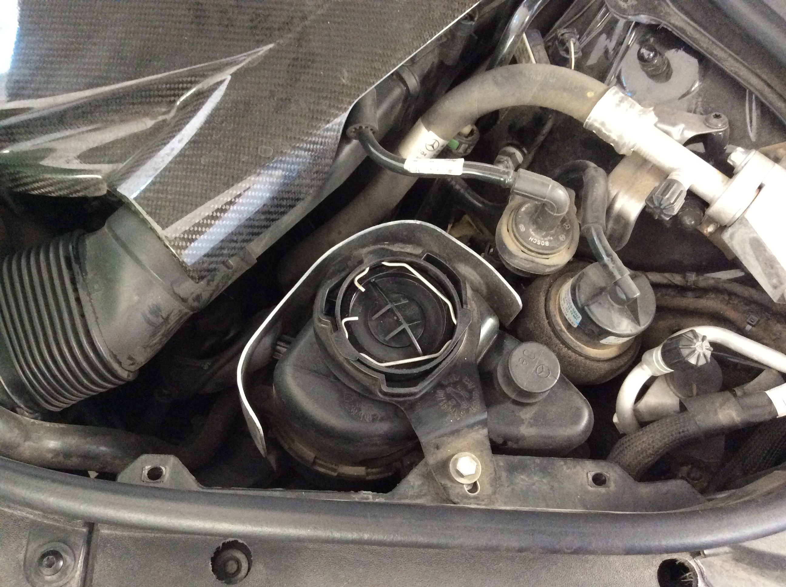

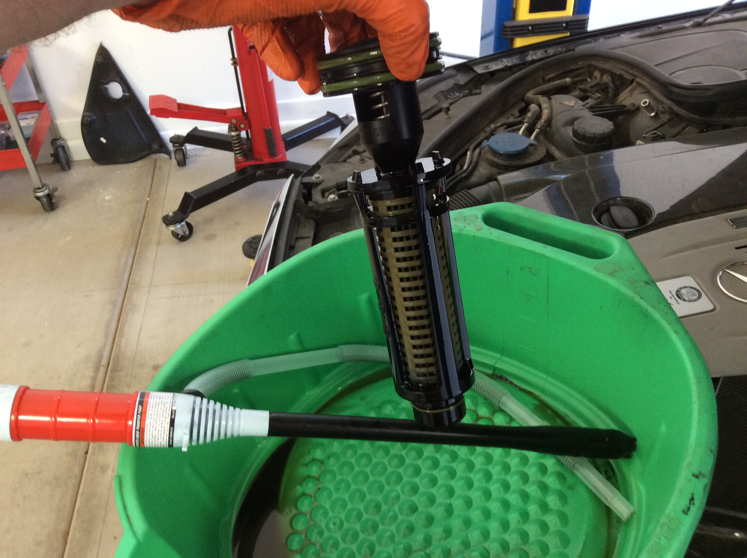

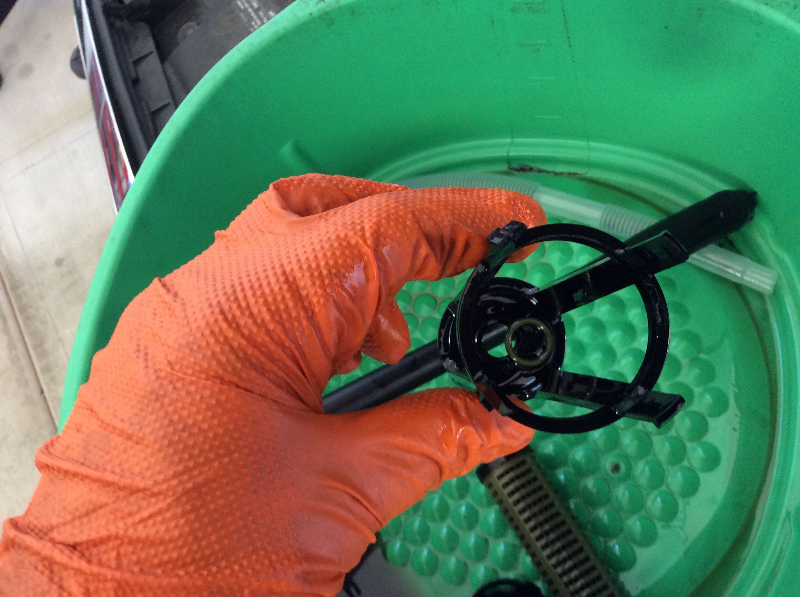

MBC filter replacement... 10 minutes start to finish with sucking out the 1.4 (or so) liter of fluid in the reservoir and refilling.
Clip comes off the top of the reservoir. Clean up around the cap. Don’t need any dirt getting in the oil. Two pair of pliers to twist and pull the filter housing out. Pair of green O-Rings at top of it to seal.
There are O -rings on both ends of the filter that nestle into the plastic guy around the filter.
Very easy. Yes; the filter is available separately.
Attached Thumbnails Magic Body Control-0a978c0f-b6a4-4ef4-b16a-65ab62490868.jpeg   Magic Body Control-9fe05af0-ba43-4485-864e-7c1fbe5e362d.jpeg   Magic Body Control-fb478d13-930e-49d6-ada0-ac0c9c5bd710.jpeg   Magic Body Control-a7a49116-155c-43d2-a3c6-7e4d683fe2f4.jpeg

Great post and pics, thanks! BTW, what's the other pic in there (#5) that looks like a cracks in glass ??
I’m not seeing what you are Tom.

Hmmm me neither, is it the same thread we are talking about, OP only posted 3 images right?

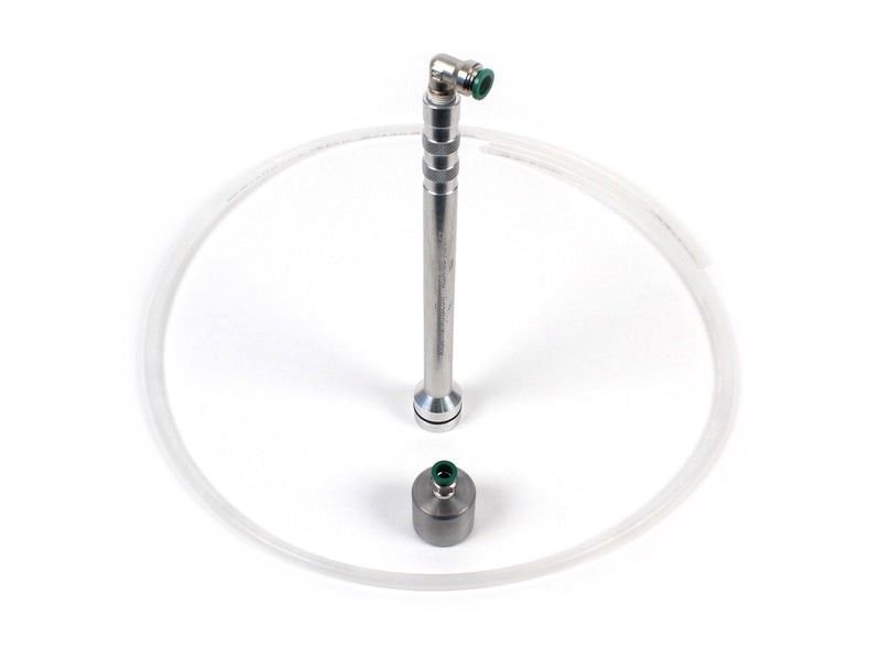

Someone alerted the forum to a sale on the CHF 11S fluid earlier this summer from Petroleum Service Company. I ordered a case (smallest quantity) which is 6 liter cans for $90 with tax and shipping included. Cans arrived in good condition with quality packaging. The price has gone back to around $100 but still pretty low compared to scamazon. https://petroleumservicecompany.com/...titan-chf-11s/
I also found this tool I'm going to purchase and use to completley flush the fluid. Appears to be a quality product to perform an improved method of fluid maintenance.
https://agatools.com/products/aga-mb-abc-ft
I have no experience with the AGA company but it appears to have some interesting and useful tools everyone might want to check out.

There's a filter on the W222 that should be replaced. Scroll up and look at the post from @JohnLane, he shows a pic of the filter and the part number.
Also, watch the video from AGA for the instructions on the MBC tool. You must remove the filter and insert the tool where the filter is normally located. This is what allows the fluid to be replaced without bleeding each line.
