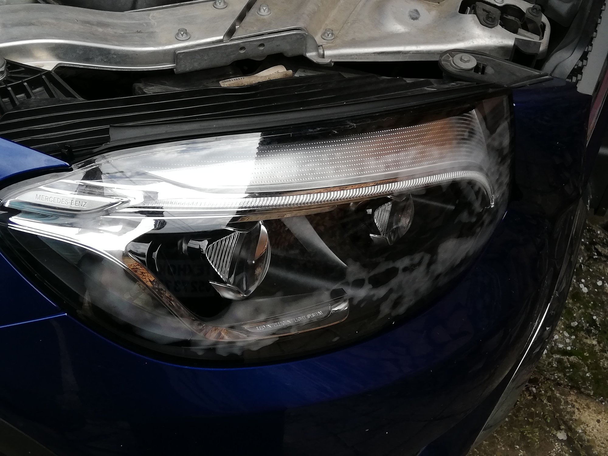

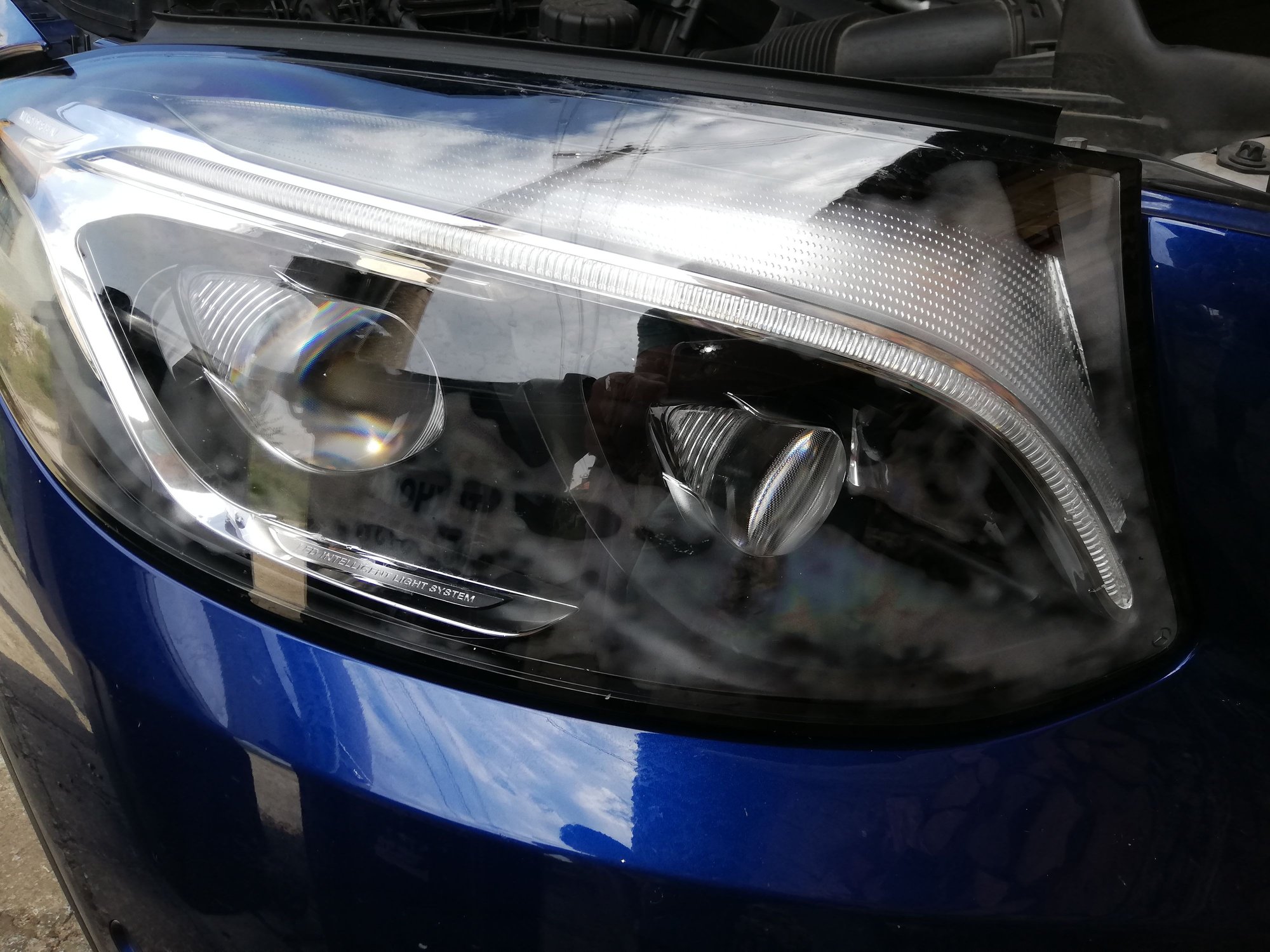

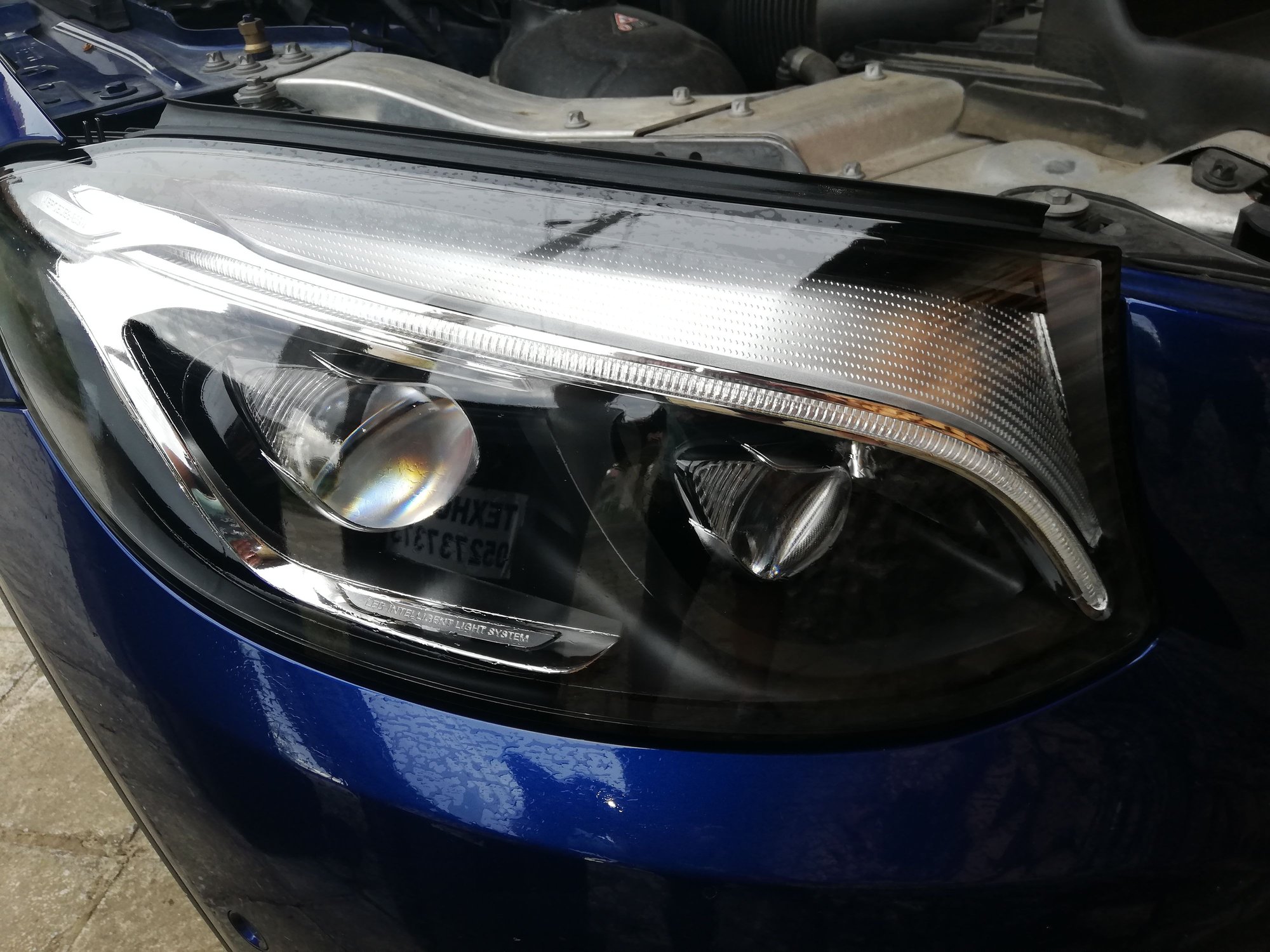

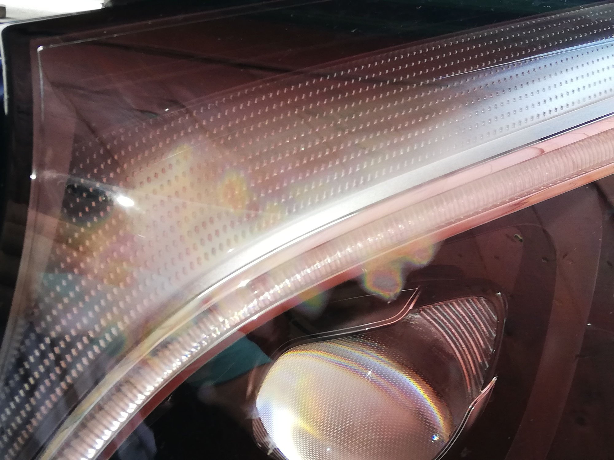

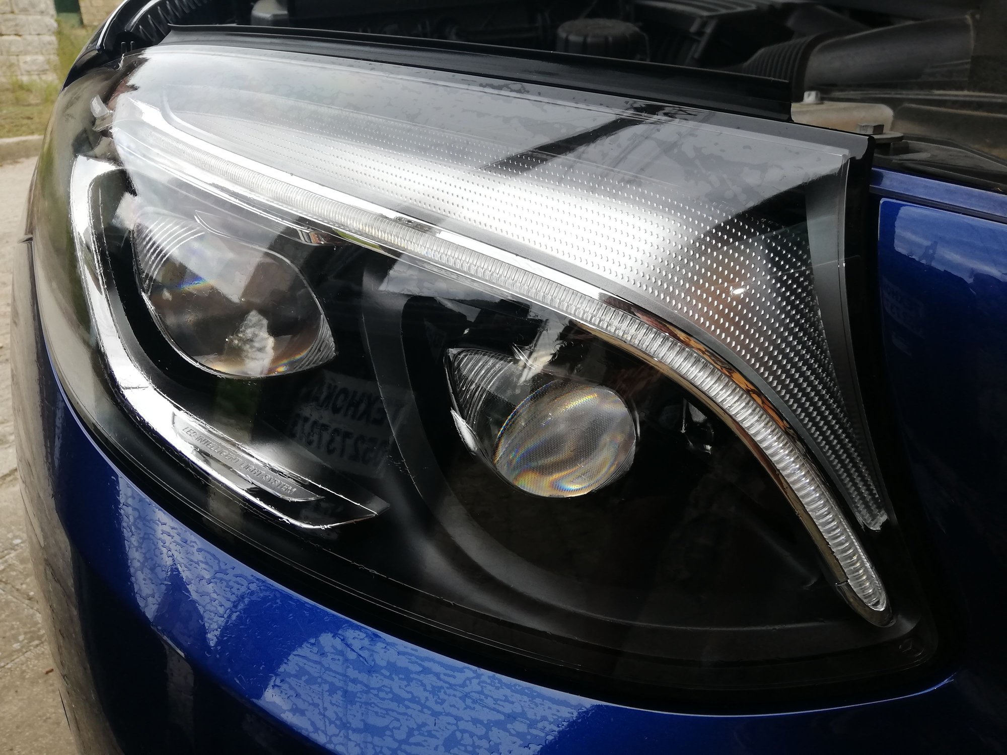

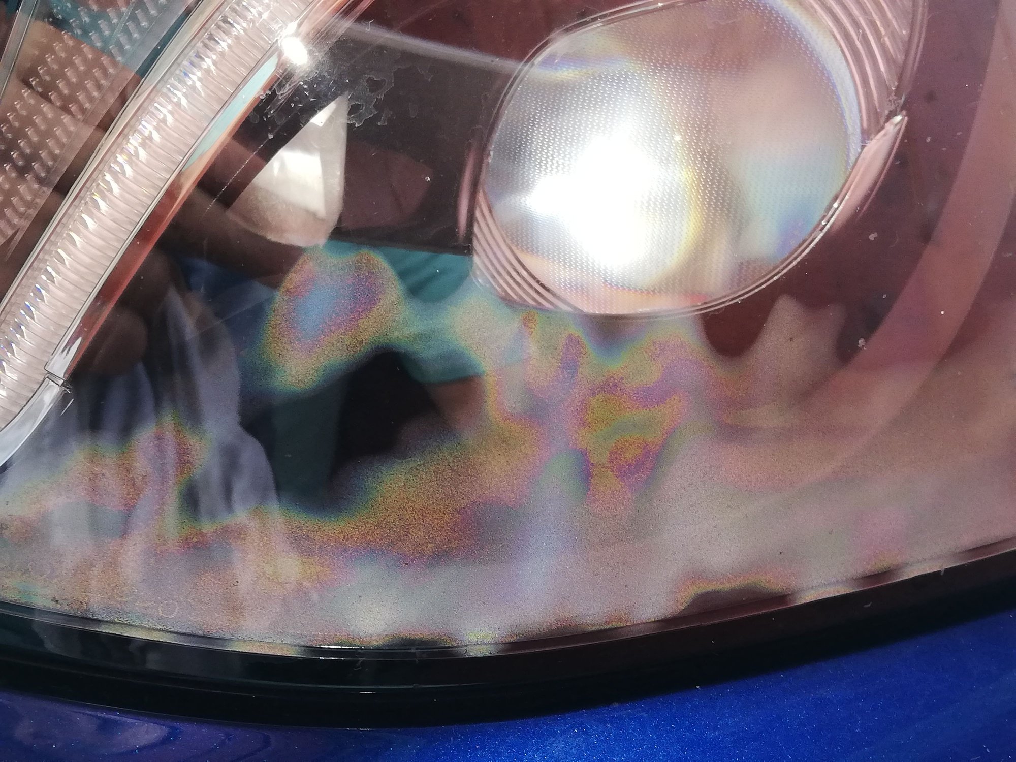

Hi.
Again for headlight condensation.
It was noted by my side, that many car brands are not so severely affected by this problem, rather than some MB models. Even some other brands have same headlight manufacturer(AL company). All this means, that there are some specific factors present in MB, which boost subject issue. My understanding tells, that the main reason is heat exchange of headlight housing. Heat emission from engine in engine compartment combined with minor overpressure there passing through PTFE membrane, rises temparature of headlight housing internal air, additionally LED modules give further kick. The air inside housing is preheated considerably.
Following simulation was performed:
Part I(Hot part)
1. The car was driven almost 2 hrs, including 20 minutes highway drive with 150 km/h.
2. The car was stopped and 15 mins was parked.

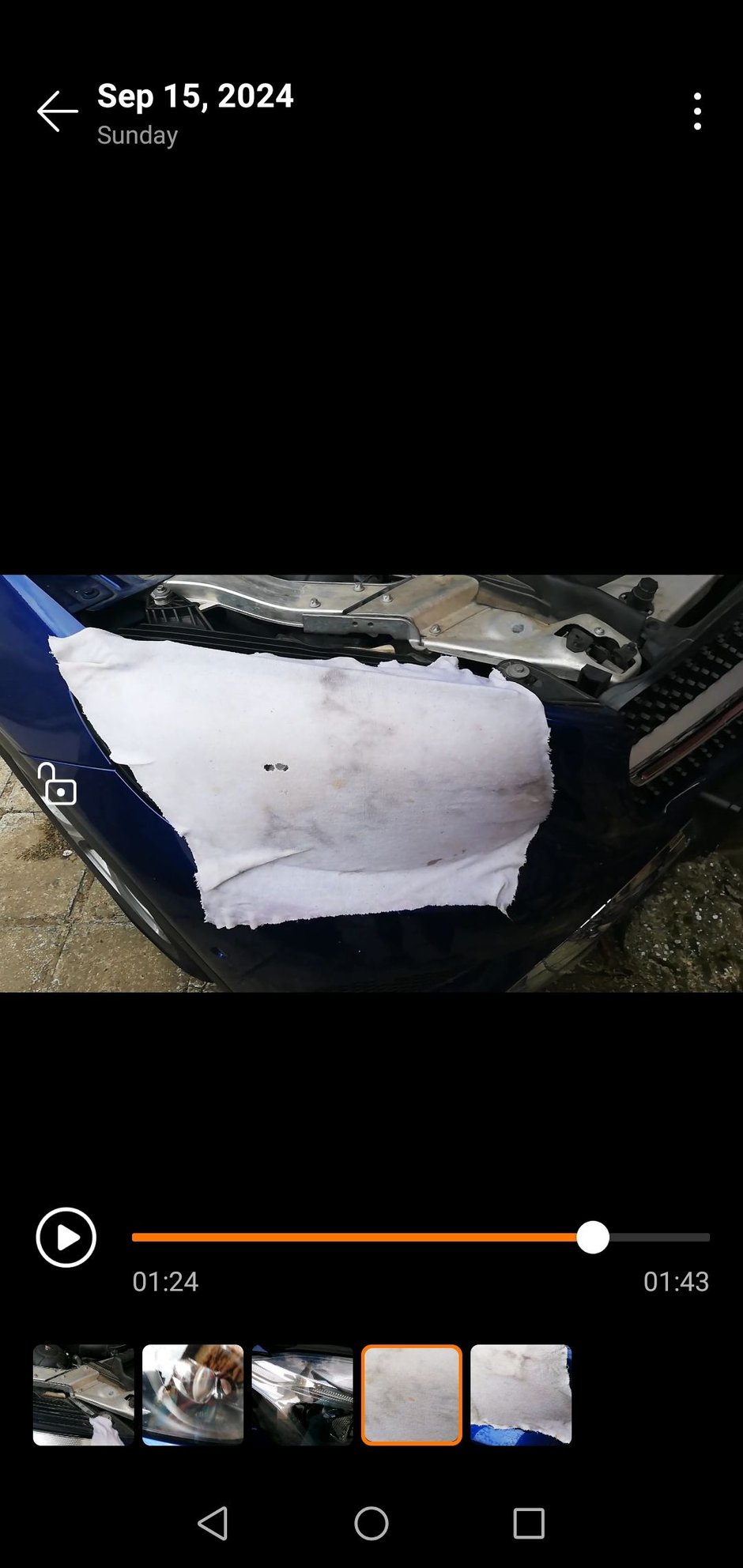

3. Cotton rag poured with cold water was applied over front lens just for 3-4 mins.
4. Result - considerable presence of condensation of both headlights.
See videos and pictures.
Part II(Cold part)
1. The car was stopped and parked for abt 4 hrs.
2. All parts in engine bay including headlight housing were with ambient temparature - abt 23 deg °C.
3. Cotton rag poured with cold water was applied over front lens just for 5-6 mins plus switching on low beam in order to activate internal cooling fans.
4. Result - NO any presence of condensation in both headlights.
Weather conditions during both simulations:
Ambient temp abt 23-24 deg
Relative Humidity abt 45-60%
Sunny
Verdict:
If headlight housings are relativly cold and insulated some how(even the top visible part) the internal heat vector in housing could be deflected to front lens and thus the heat exchange could be modified so the air in cavity space of the headlight to be NOT so hot.
It is basic phisics, that hotter air is, more water it contains.
It also should be noted, that all processes concerning this issue and its final result are described by complicated non-linear interconnections, so even very minor change of temparature could give considerable reduction of condensation.
It should be stopped to consider cracks and other mechanical damages as reason for condensation.
Brgds.(soon when wi-fi avail Will upload and videos)

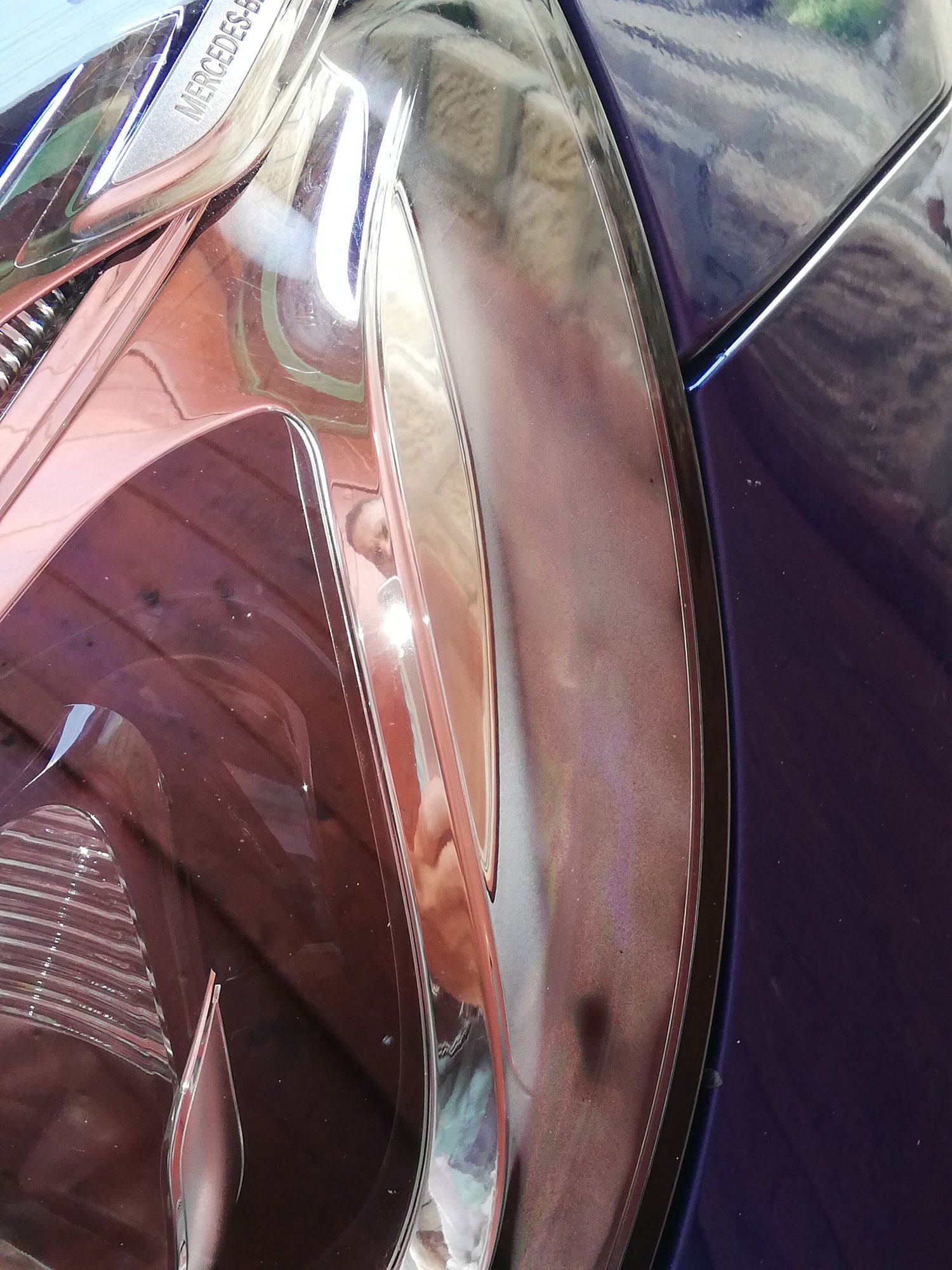

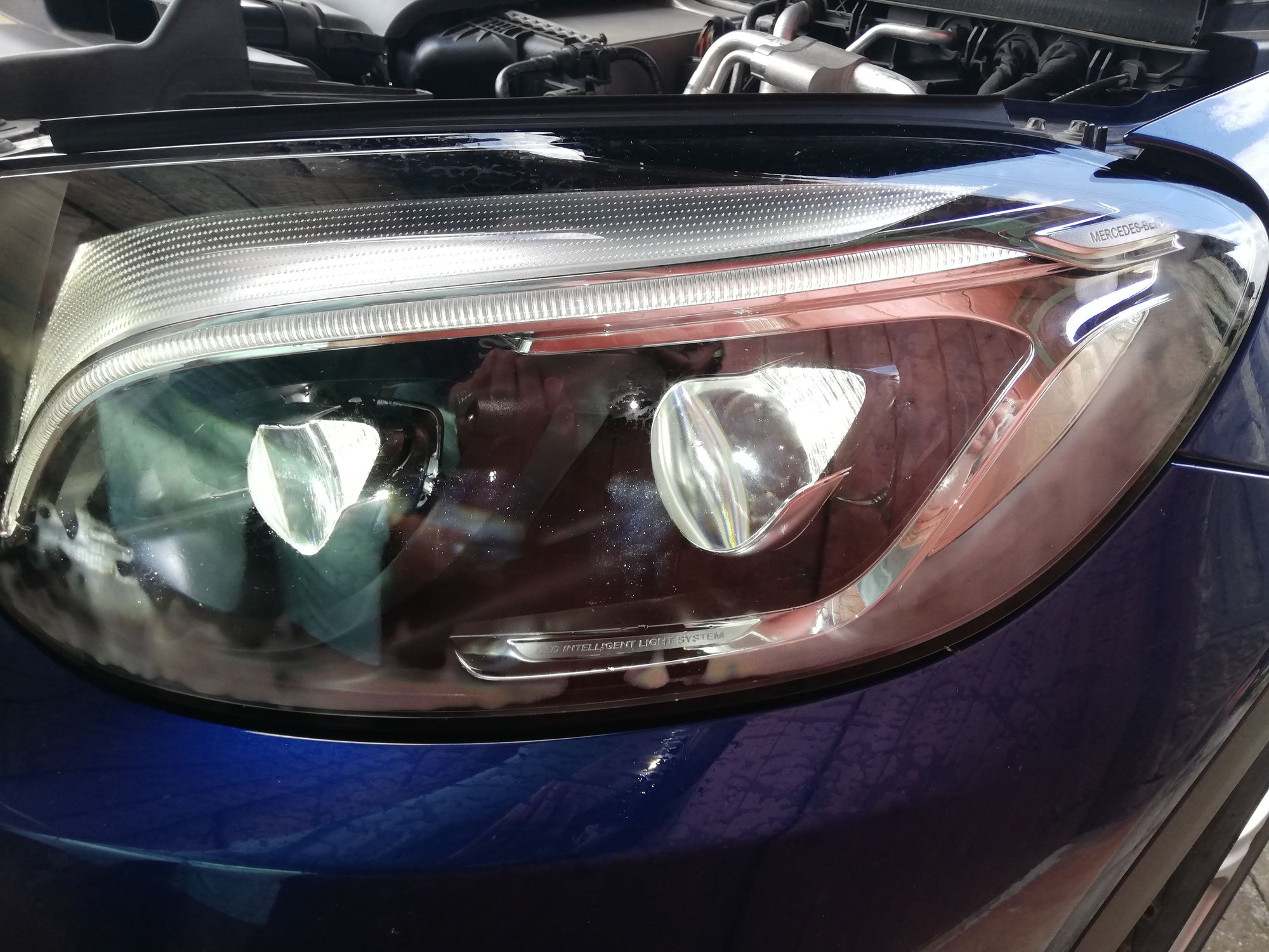

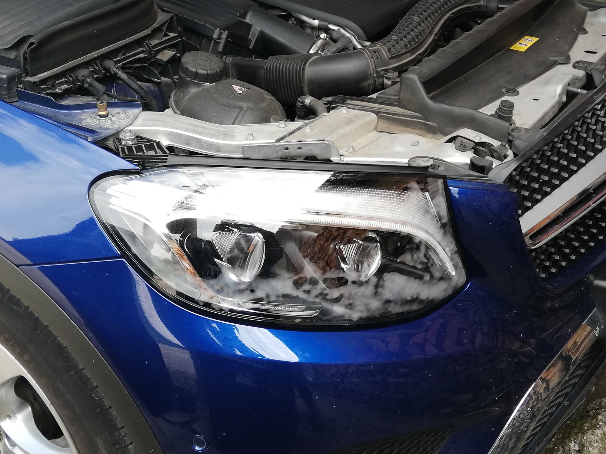

Additional pictures to my post #121.
Not possible to upload videos due to size/extension, so there are some photos explaining simplicity of simulation.
