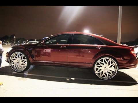

I’ve used this analogy before, so please forgive me if you have heard it here previously. An S Class, riding on 20” and larger wheels, is like a beautiful woman wearing 6” stilettos. She looks fantastic, but don’t ask her to walk anywhere. A truly beautiful woman, knows that a 3” heel looks great. A 4” heel if you are going to basically sit and look pretty. Anything over that is just ridiculous and cheap looking. Same goes for huge diameter wheels on an S Class.
I CALL THOSE CLOWN CARS.
