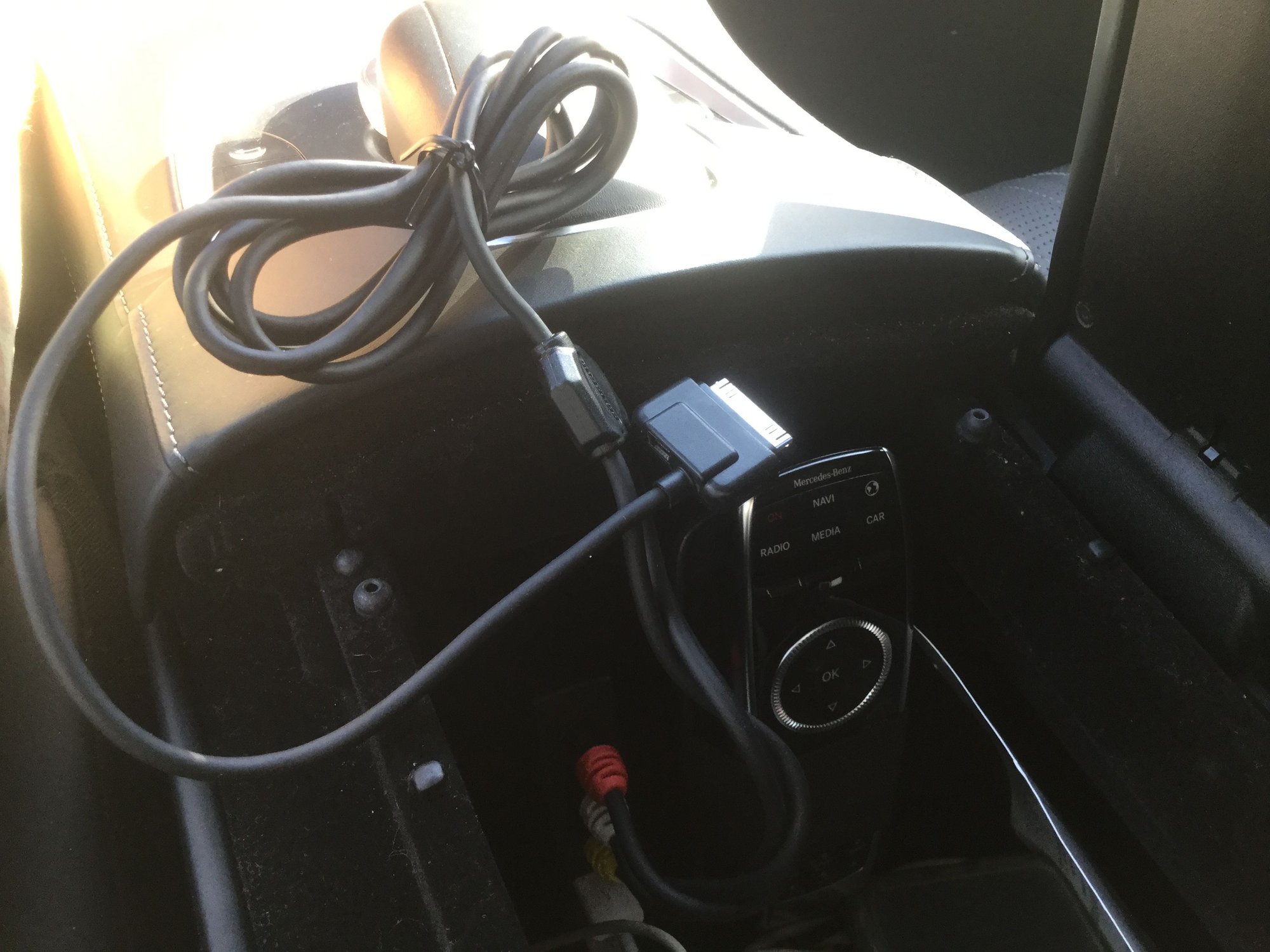

2014 s63 AMG.
30 pin RCA video on old iphone
Not sure if your aware but if you have a old iPhone with the 30 pin connector they have a anolog to digital converter built into phone. New style that was removed. So for 15 dollars you can use a old iPhone or iPad to play movies on your w222
The make is Scosche on Amazon , well made also 15 dollars
