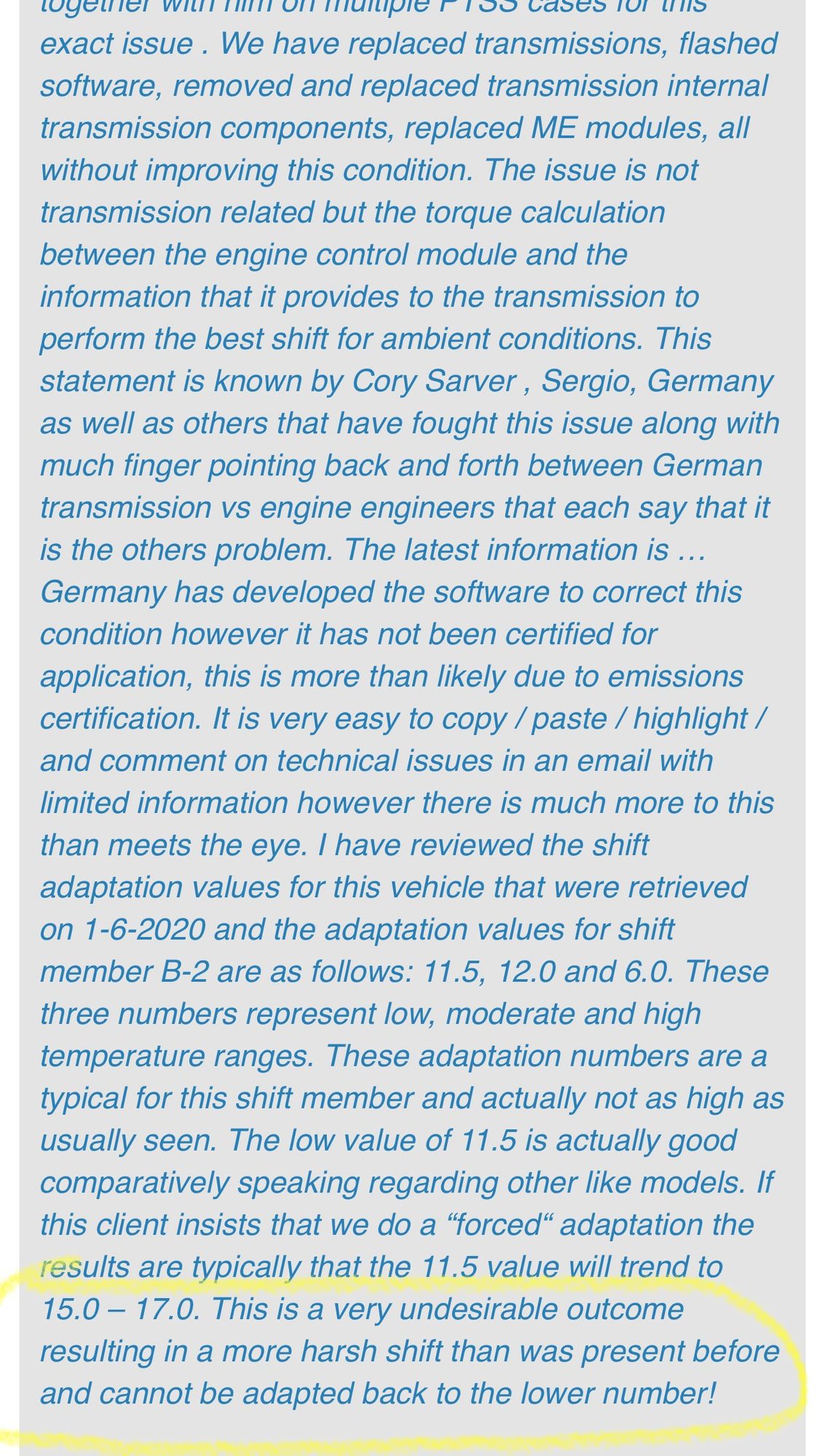

bicycle
Why can’t it be changed back?
Wonder why it can’t be changed back? If you can override the number why can’t you override it again?
Originally Posted by MBNUT1
You all might think this strange I find this kind of response somewhat comforting in that there is complete and forthright discussion of the problem and communication with the transmission engineering staff. It makes sense that they can't just roll out a software upgrade due to emissions certification requirements.
Additionally it echos what my indy has told me when I inquired regarding having the transmission shift quality improved via road test adaptations.
Interesting, where did you get this transcript from? I don't see it in the threads.
That was here somewhere in this long thread, probably as a screenshot, or at least I recall referring to it. I don't think he meant that it (can not) be reverted back ever, but he is saying the car itself won't adapt back naturally as it learns your shifting style to these values and will stay closer to the higher range of adaptation. Anyway I don't think that statement is a concern now. Just ask your dealer to follow the instructions given in this thread repeatedly, and things should be fine as it worked for several of us including me being the OP. Make sure to go to your dealer... No transmission reset or any of that sense proposed by some folks. You need your dealer, a tech with a PC in the passenger side running the adaptation while the car is being driven, and another tech driving the car for a good 30 min trip to find room to go through all gears that need to be re-adapted.
https://mbworld.org/forums/s-class-w...ml#post7970818

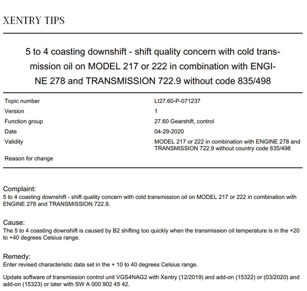

Forum colleagues,
As the original OP of this thread, I'm glad to see that it has helped many of you work with your dealers to reference the correct MBenz bulletins and service notes I shared when I got mine fixed. However, it's unfortunate that the recent few posts have been hijacked by a particular guy promoting his services here instead of sticking to his own thread with single digit user replies. Disclaimer just for clarity: I have NOT used this individual to resolve the issue I originally reported in this thread, nor would I recommend him anyway for a thing like that. The point I want to clarify, he is excessively promoting his long promoting pictures here but he has no connection at all to my experience fixing this issue and other users who posted here over the years with good results as well on this issue under this thread. To avoid any confusion, let me be clear: the issue discussed in my post was resolved by my dealer, not through any third-party service or remote access coders. My personal opinion also is that I would never entrust a critical function like transmission shift point adjustments to someone claiming to do it remotely or overseas or whatever, especially when such work requires live (while driving) forced shift adaptation service. I have done remote coding for my cars for certain features, but things like transmission issues were ALL done through my dealer. Just sharing my story for the records.
Additional note for those with similar issues: If you've been experiencing this problem for some time (especially before your warranty expired), you "can" request that your dealer perform the service as a goodwill gesture. This is exactly what I did as I already reported years ago. Despite being out of warranty at that time, I received the service free of charge because I told them the problem had been ongoing for years, but I had only recently discovered the relevant bulletins.
To summarize and avoid further confusion as tracking original post/repair notes got lost over the years and many pages or posts here: #1) I've reattached a screenshot of the relevant service bulletins for you to present to your dealer, so you can easily find it. This is bulletins (LI27.60-P-071237 APR20 – 222, 217 for the 5 to 4 coasting downshift - shift quality concern) which contains clear instructions for MBenz technicians to address the issue. I’ve also included a PDF of the complete document. Hope it continues to help many of you. #2) VERY IMPORTANT: make sure to ask for "Force Adaptation" as a part of the process. Doing the software updates only as in the screenshot is not enough. See previous original posts on this thread for more on that, or simply also ask for the adaptation to be done while car is being driven. A few of us reported here that #1 and #2 was the ultimate solution (otherwise just reset or re-learning shift points via software re-set will only fix the issue for a few 100s of miles.. you need the adaptation values procedure to be performed by the tech)
Last, I just responded to a couple of you who reached out to me privately and shared my personal after-service notes as some requested (sent), but really the MBenz bulletins + asking for adaptation should be all you need to get the job done anyway. I don't mind sharing my service notes here, which I still have, if that helps anyone.
File Type: pdf
