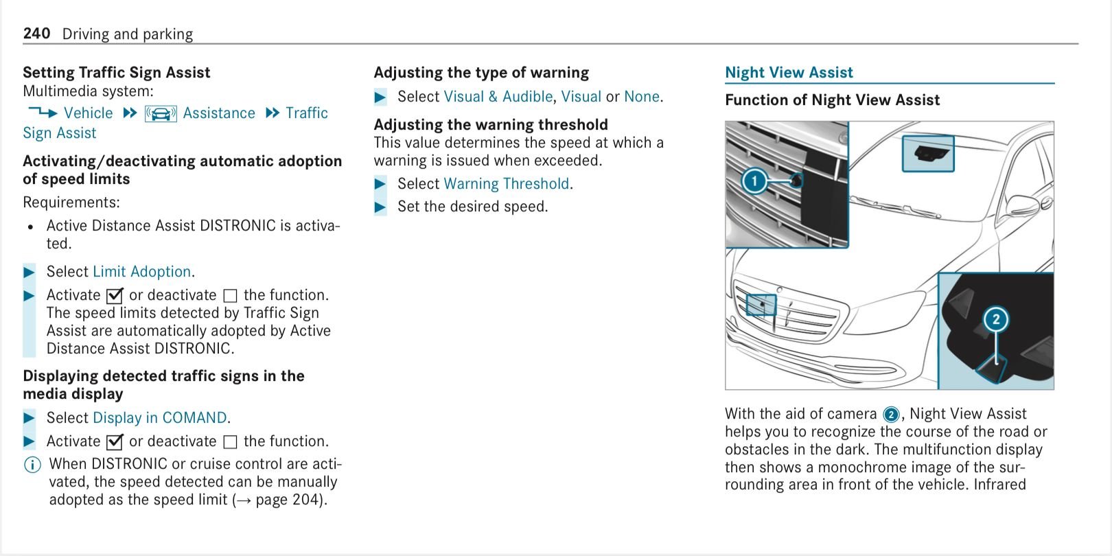

You wrote 'this setting can be disabled' How does one do that ? I'm ignorant about how.
Old Sep 5, 2022 | 08:59 AM
will_atl's Avatar
Joined: Mar 2022
Posts: 409
Likes: 211
From: Atlanta, GA
2020 S450 4Matic, 2022 GLS450 4Matic, 2015 C300
This is from the 2019 owners manual.
