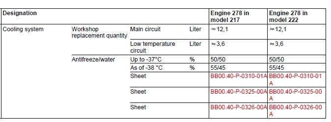

Low temp circuit:

To close the loop on this ... pulled out my reservoir today and there's a molded plastic piece down in there that indicates full. Similar to the expansion tank for the main cooling circuit. My reservoir was completely dry, took about 8 oz of fluid to fill it back up.
