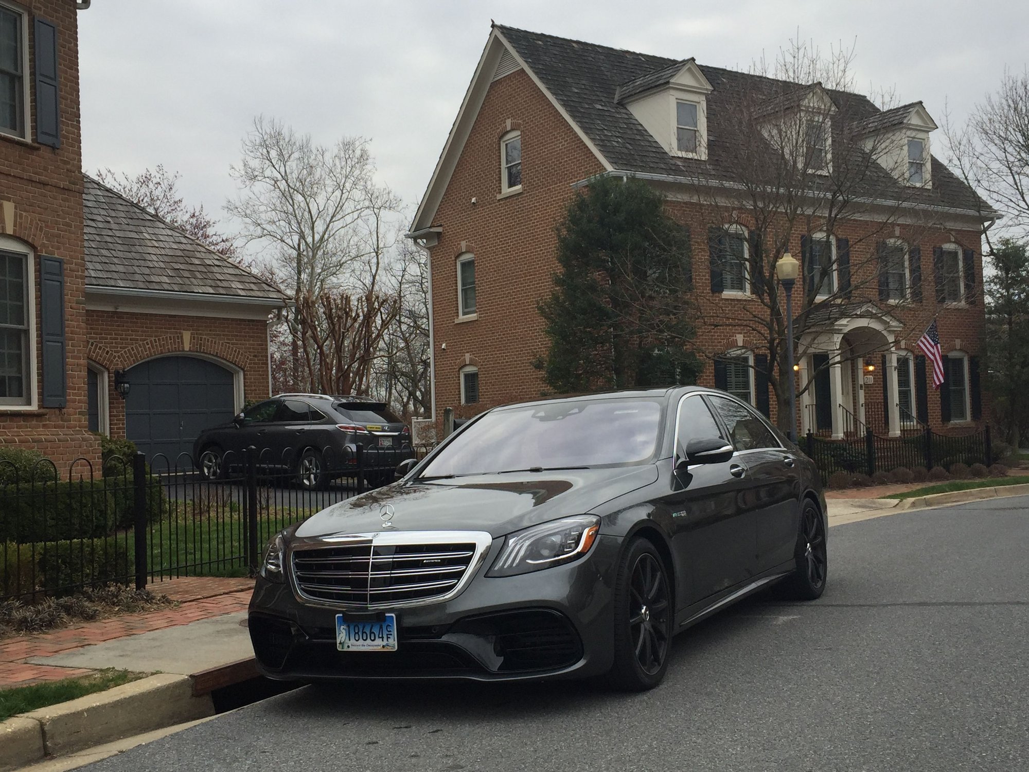

None of that worked for me. I tried in ANY position on my windshield. It was a no go. Once I put it here, never a problem. I never have to stick it out a window again. YAY! Best decision I've ever made, EZ pass, wise. It may be ugly, on the license plate, but it works beautifully.
