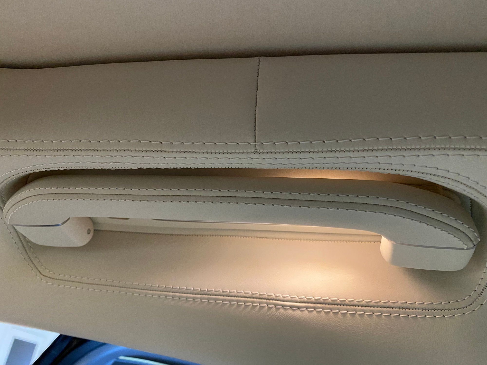

In the S65 in addition to the actual headliner the A, B and C pillars are also leather and all six of these pillars have airbags in them. This will be a big task to do after the fact. If you look for a salvage set it is likely some of the airbags would have deployed making those pieces unusable. The headliner leather is matched to the interior color option so that further narrows down the likelihood of finding a complete set of pieces. The leather headliner also has exposed hand stitching holding all the pieces together. There are 16 separate pieces stitched together this way in addition to the six airbags covered in leather. I would talk to a high end upholstery shop with customization experience. They can get the right leather and have experience recovering airbags. It will not be cheap.

Here is a picture that shows the detail at one of the grab handles above a rear door. I forgot to count the pieces of leather on the grab handles, that makes 19 separate pieces.

Thanks for the feedback. I hadn’t thought of wn upholstery shop but that’s a great idea. Appreciate the picture of your car. The liner and stitch work looks great! I’m also a huge fan of porcelain/tan - my absolute favorite!
