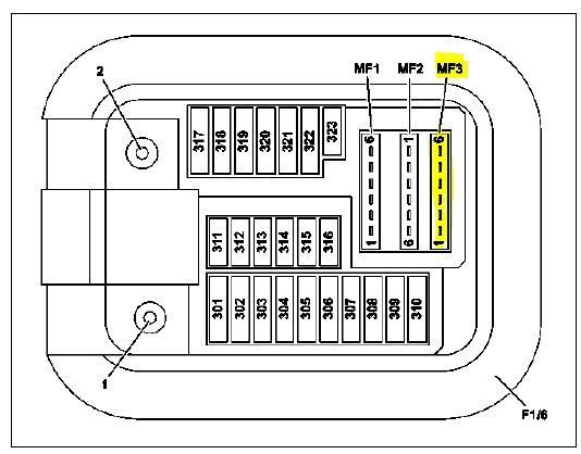

Hi Guys, accidently some champagne was spilled on my rear climate control panel from some passengers, i use it on my limo fleet and it has stopped working, i want to check the fuse before i order a new one, i dont have a fuse chart, can anyone point me to the location for the rear climate control fuse

The fuse allocation chart is located in a recess at the side of the rear fuse box in the trunk. You can find the corresponding fuse rating and fuse type on the fuse allocation chart.

Passenger foot well fuse panel, f340 (5A) MF3/pin 5.

Thanks for the info guys, it looks like my fuse is ok as the rear climate control has now illuminated but is frozen, nothing works when pressing the buttons, i think i will have to try to get an electrician to clean the circuit board, might be sticky from the champagne spilt on it
