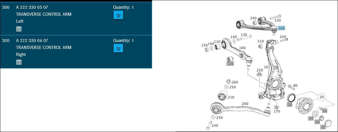

My s550 w222 just hit 80,000 miles my lift upper control arm needs replacement. Dealer is quoting me 6.5 hours of labor. I have done many control arms in the past but never one that requires 6 hours of labor. Can anyone provide me with insight on this.

2014 non-4matic shop 2223300507 or current part # is 2173303900, see attachments.

is it possible to remove control arm without completely removing airmatic strut non 4matic?

I took at look at this a while back, and it looks like the challenge will be getting out the top bolts (# 330 in the diagram) ... not a lot of room around the strut to get to them.
