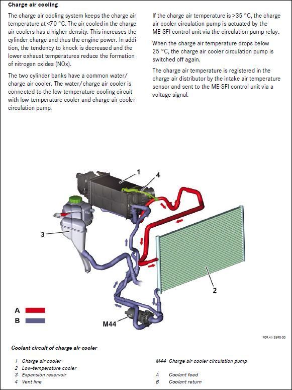

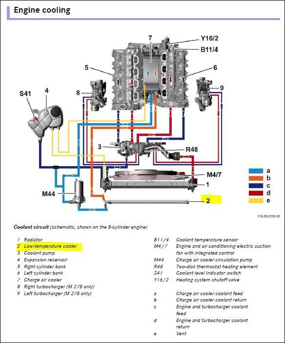

Before replacing parts, replace coolant inclusive of bleeding system see if anything develops. See attachments.
thank you. Sounds like first step is to ask the dealer to refill the cooling systems and road test it
