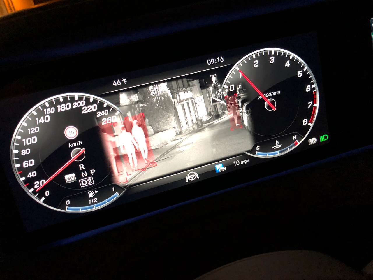

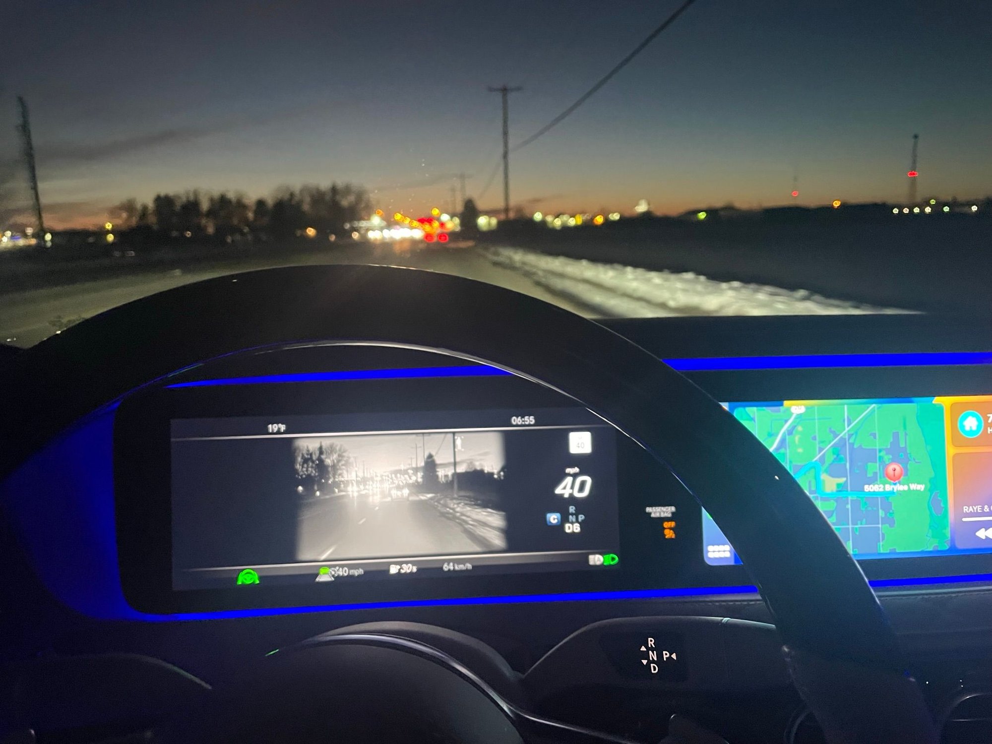

I had the Split-view in my former W550 , and I currently have the Night-vision on my S560. I'd get the Nigh-vision all day long than the Split-view. The split-view is a gimmick, cuts the resolution in half leading to very poor resolution all the time (50% of pixels available to each side, and this mode is permanent; be aware and in fact I would pass on the vehicle only because it has the feature).....It was even discontinued after the facelift.
If interested, you can just get the Night-vision, and then code your vehicle for Video in Motion then you get the best of both worlds. I am learning coding in steps (and hopping soon when I fully learn it to share free instructions and resources on this forum), but right now I still pay to get my car coded for some more complex stuff as a beginner in MB coding, but if interested, Video in Motion is easy coding and am happy to assist if I can. When I had my S550 years ago, I asked RJautomotive to code my vehicle
I have the night-vision and I love it, 100% on all the time in the evening time and beyond.
Nigh-vision shots for you:
