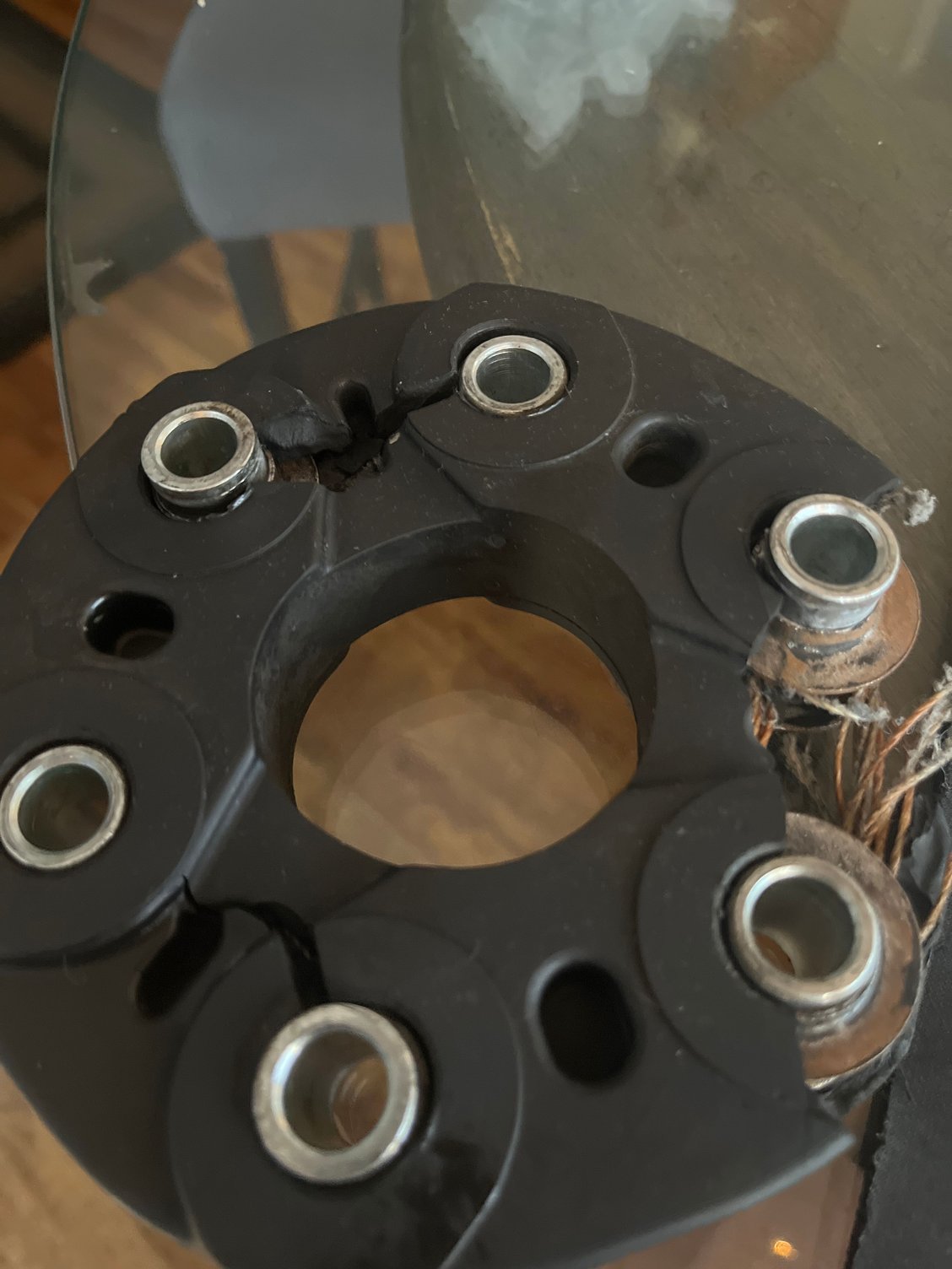

Thank you for taking us along on this journey. So is your plan to replace the cracked flex discs?

Yep, while they’re in there, center bearing and transmission mount as well. Since all they are connected.

To update this thread:
Even after rebalancing the new tires several times, at different locations using the road force balancing, the vibrations didn’t get fixed.
I suspected the driveshaft components and was about to take it in after a vacation. Coincidentally, after I got back from my vacation, the driver rear tire was flat at the airport. I had to air it up and the next day, took it to the tire shop to repair the tire. They dismounted the tire to repair and I requested another rebalancing of all tires.
Lo and behold, the vibration was 100% gone at all speed ranges. It felt like I just got a set of new tires. I don’t know how to explain what fixed it, just my luck perhaps the driver rear tire needed to be rotated on the rim? But I would expect the balancing machines to have caught that. They were the Hunter machines with laser and everything…

Thank you for the update. Happy that you were able to achieve vibration free driving with just an adjustment to your tire. This echos what an indy said during a MB club visit to his shop. He basically said vibrations are almost always the tires (wheels?). This thread was kind of delimma in that it seemed that you had addressed that with the force balancing and the laser inspection of the rims. I guess I figured that eliminated them as an issue but as others have pointed out sounds like not all machines / technicians are created equal.
I am interested because I am going through the same thing.
