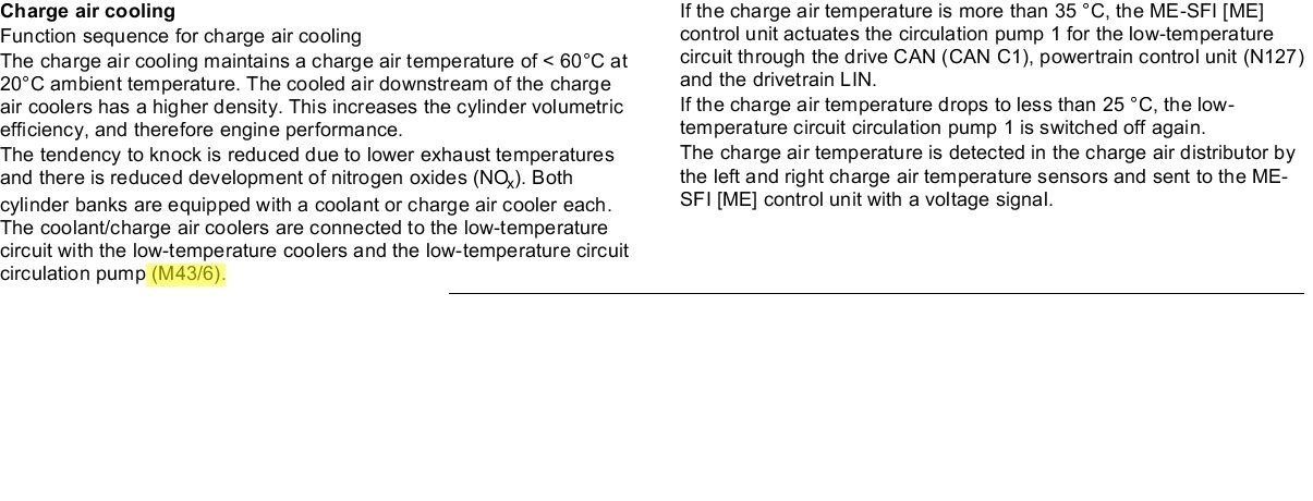

I find that the charge air system ends up hot soaked after sitting a while with the engine at operating temperature. Can’t miss the lack of performance as ME pulls boost to keep things safe until enough time has passed at speed to get all that heat out. I intend to do a naughty bypass of the relay such that the charge cooling pump runs anytime the engine runs + additional heat exchanger in front of the stack and likely another pump to really get things moving.
Did you find the wiring diagram or relay? I'm also looking into this. Found a related one K40/8KN for circuit 87M, but can't find more info on this
