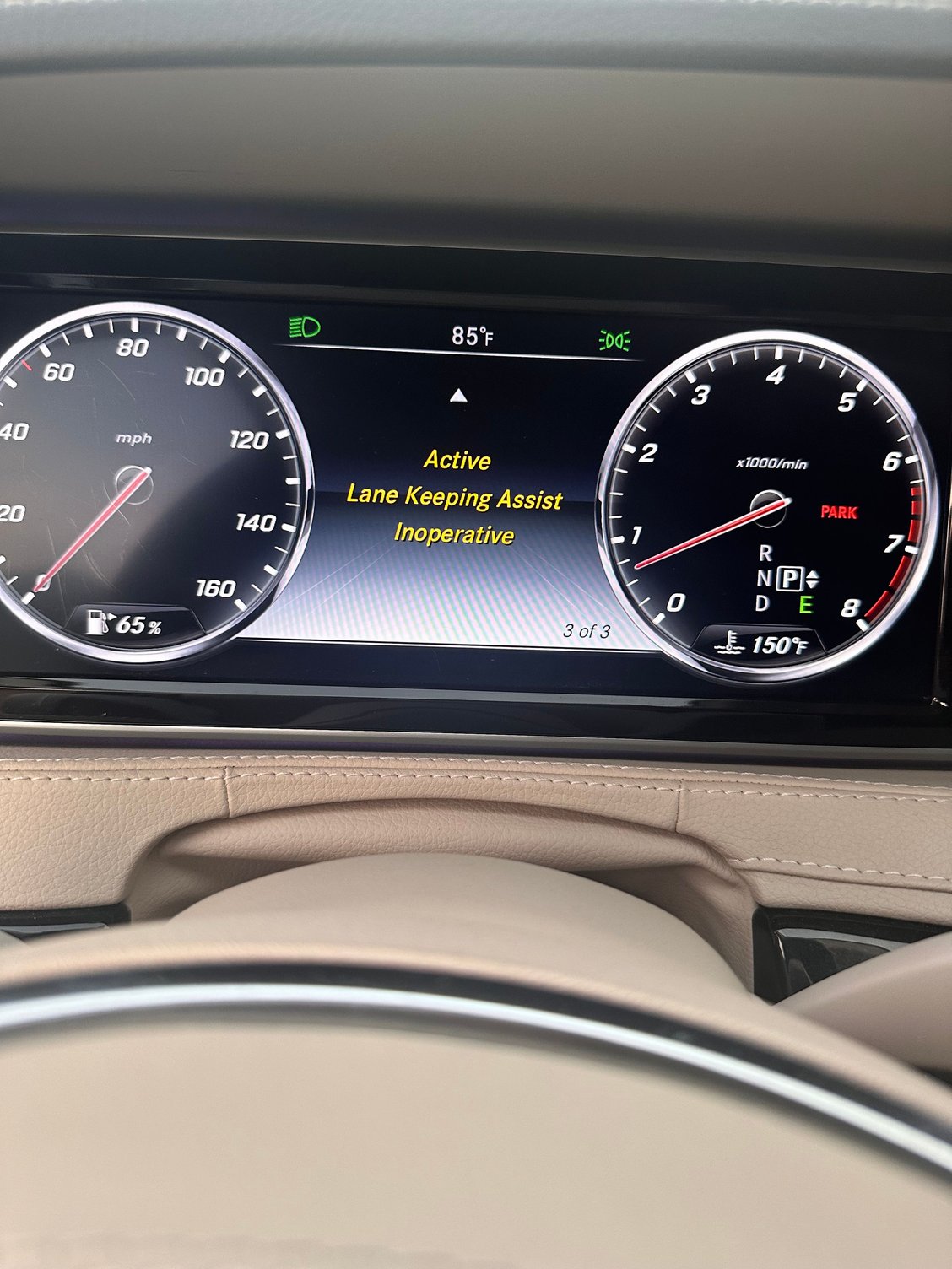

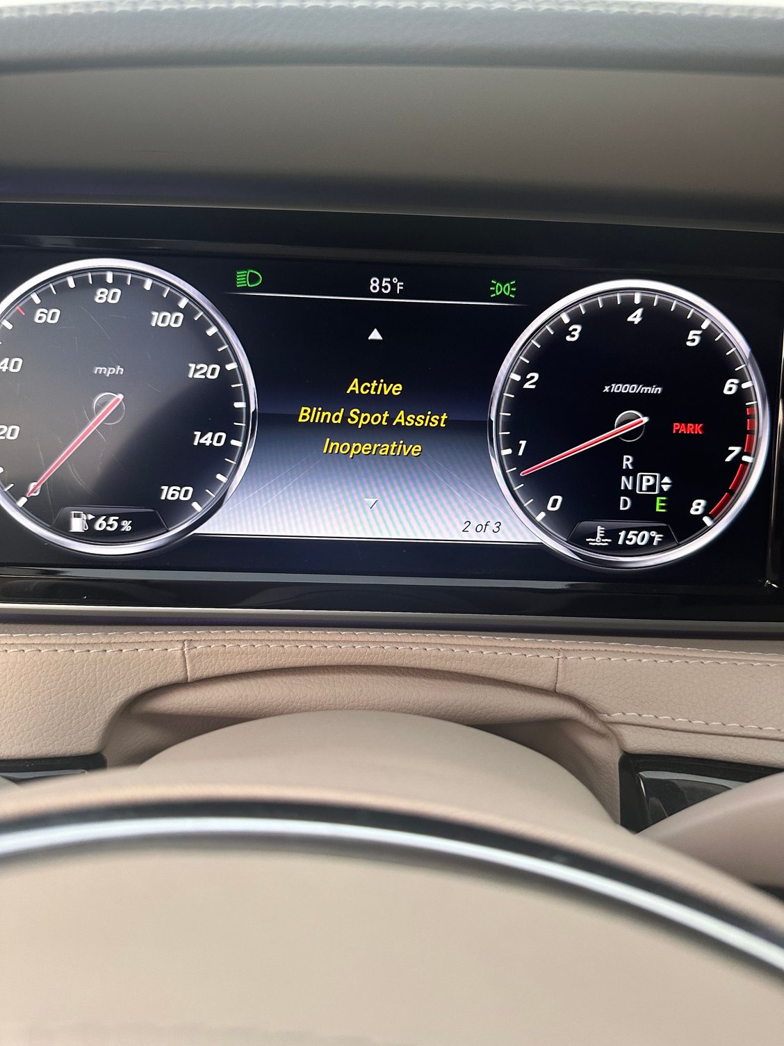

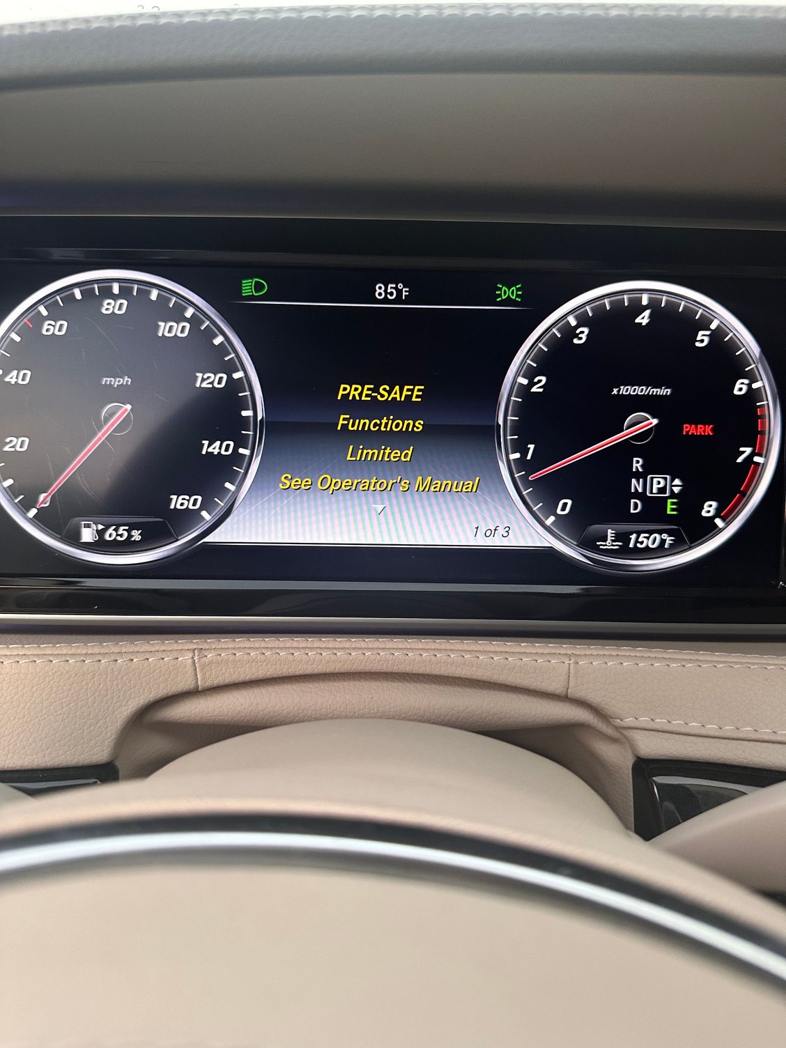

Hi Benz owners, I know this is a very common issue. But i need some expertise on this current issue i m facing with my car. I bought it and it comes with these issues at the moment it looks like a sensor/unit error. I tried it with a snap-on Scanner. However i was not sure should i just buy the unit or it needs cleaning or reset. The picture will show all the codes:U145CFA (Implausible Data Were Received From The Control Unit 'DISTRONIC’ Current, Stored.)
U109800 (The Control Unit 'DISTRONIC' Is Reporting A Malfunction. - Current, Stored)
U145CE4 (Implausible Data Were Received From The Control Unit DISTRONIC. Current, Stored.)
U145CE6 (Implausible Data Were Received From The Control Unit DISTRoic. Current, Stored.)
U145C6 (Implausible Data Were Received From The Control Unit DISTRONIC. Current, Stored.)
is these sensor or unit is in the front of the car or something else, WOULD I NEED TO RECALIBRATE is so how can i calibrate it.
how hard and difficult it is to get to that sensor do i need to take part alot of things to reach it or replace it
most definitely where can i find the right one for my car which will work without any modifications are there any better options out there
one more thing
I also getting fault in the scanner. Which is this one is that mean the circuit is located. Or mi missing some coolant in the low temp reservoir.

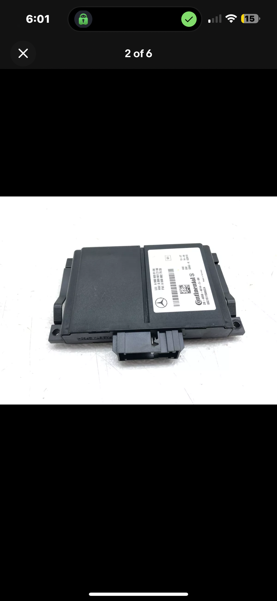

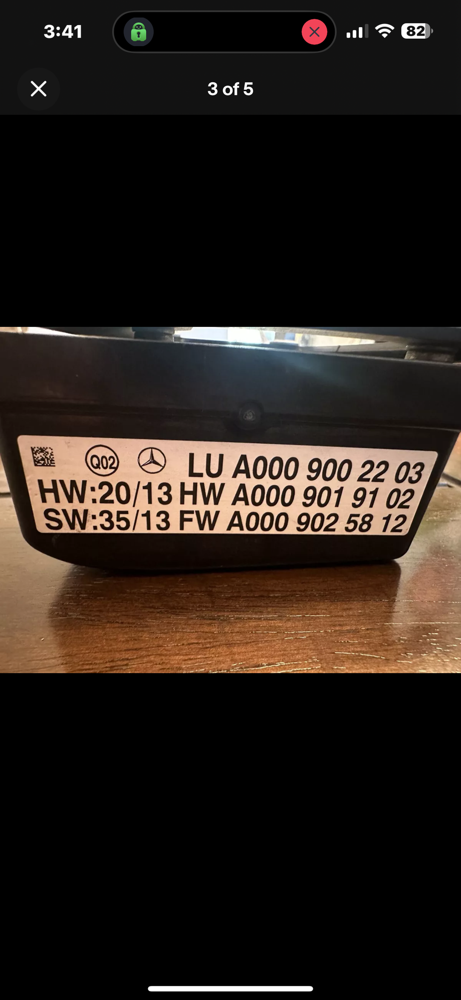

I need to know how the sensor looks and the part number
BUMP!
Please let me know which sensor it can be for my issue
