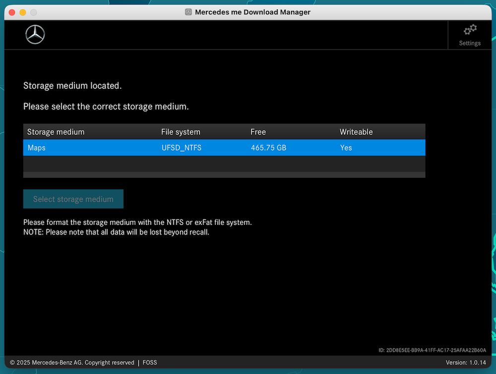

Got an email from Mercedes a new map is available. I've done this before and it's clunky but it works, now I can't get it to select the thumb drive. It sees it, but the Select Storage Medium button isn't active. It's NTFS. ExFat gives an error and won't get this far.
I've removed the thumb drive, reformatted it, reloaded the page, downloaded the latest map loader... all the things I can think of. Suggestions?
Likely not enough space?
It needs 32 GB for all the maps and it has 465 GB free. It's empty and dedicated to map updates.

Originally Posted by dmatre
When I try to update, it fails at the next step:
Someday they'll hire someone who knows programming...
I get that error when using a drive formatted exFat. NTFS gets me to my screen ^.
Old Oct 27, 2025 | 06:33 PM
VII's Avatar
VII
Joined: May 2011
Posts: 975
Likes: 270
From: Fort Worth TX
2020 S560, 2014 SLK55 (Prev. 2016 S65, 2013 SLK350, 2008 CLS63, 2006 E350, 2006 CLS500, 2005 C230K)
USB might be too large try with something 128 or below
You might be running into the same problem I had. My car wouldn't work with a previously used USB stick. I had to buy a brand new USB thumb drive. Ironically; the second time around I was able to find the old one I used the first time, and that USB thumb drive worked. Just my $0.02 cents. I probably have 30+ used thumb drives around the house in varying sizes, and none of them worked.
Maybe not enough space on your laptop...the Mercedes DLM first download on your HDD.
Anyhow, 4xx GB is far too much for such an operation
I've used this thumb drive a few times before for these updates with no problems. Interesting comment above about it may have to be a new drive, odd but interesting.
Has it worked for anyone? Maybe a problem on the MB website?
Old Oct 28, 2025 | 07:04 AM
trigital's Avatar
Joined: Dec 2011
Posts: 1,724
Likes: 493
From: Spain UTC/GMT +2 hours
W213 All-terrain
You can try offline version of DLM
Old Oct 28, 2025 | 08:00 AM
NbyNW's Avatar
Veteran: Navy
Joined: Jun 2007
Posts: 459
Likes: 253
From: SD
Various
Might be a problem with NTFS formatting via my Mac, I'm using "NTFS for Mac" which has worked in the past. I think it's not seeing it formatted correctly as it says "Please format to NTFS..." ExFat doesn't work. Anyone with a Windows machine formatting to NTFS, what do you see here?
My S sees the drive and it works fine. I loaded an mp3 and it played it.
From the interwebs... UFSD_NTFS is a proprietary file system driver developed by Paragon Software. It is based on Paragon's Universal File System Driver (UFSD) technology, which allows operating systems to read and write to file systems they do not natively support.
I got those exact same error messages when using a previously used USB stick. I even reformatted the drive a few times in hopes to solve the problem Problem was resolved when I used a brand new stick.
Big thanks to @carlosinseattle for suggesting a new drive. Crazy as it seems it worked. Ordered a five pack from Amazon and formatted to ExFat and it worked. Just have to load it to the car.
Old Nov 15, 2025 | 04:23 PM
dmatre's Avatar
Joined: Feb 2003
Posts: 1,416
Likes: 342
From: Charlotte, NC
Had: 1987 300TD, Had: 2004 C230 Sport Sedan, Have: 2014 E350 Sport, Have: 2019 S450
Quick update: after trying everything else, I tried using a new USB drive formatted ex-FAT.
Download/update worked correctly with new USB.
Thanks to all here for the correct info.

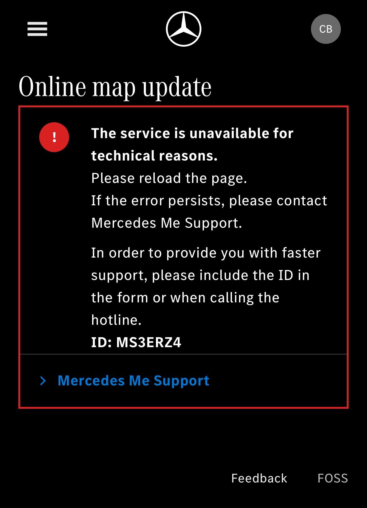

Can anyone offer a link to get to this site? Appreciate any help offered!
1st: Create an account at the MercedesMe website.
2nd: https://www.me.mercedes-benz.com/pas...?mapupdatevin= (add your VIN number after the '=' sign)
3rd: Follow instructions after that
Old Jan 8, 2026 | 09:38 AM
cdmotor1's Avatar
Joined: Jan 2021
Posts: 95
Likes: 39
From: Southern Delaware
2019 Mercedes Benz S560 4Matic
Thanks @dmatre . Clicking on that link gets this result:

Old Jan 8, 2026 | 02:29 PM
dmatre's Avatar
Joined: Feb 2003
Posts: 1,416
Likes: 342
From: Charlotte, NC
Did you create your account first? I just logged in and went' to the map update (which shows that my car is up to date) without problems.
