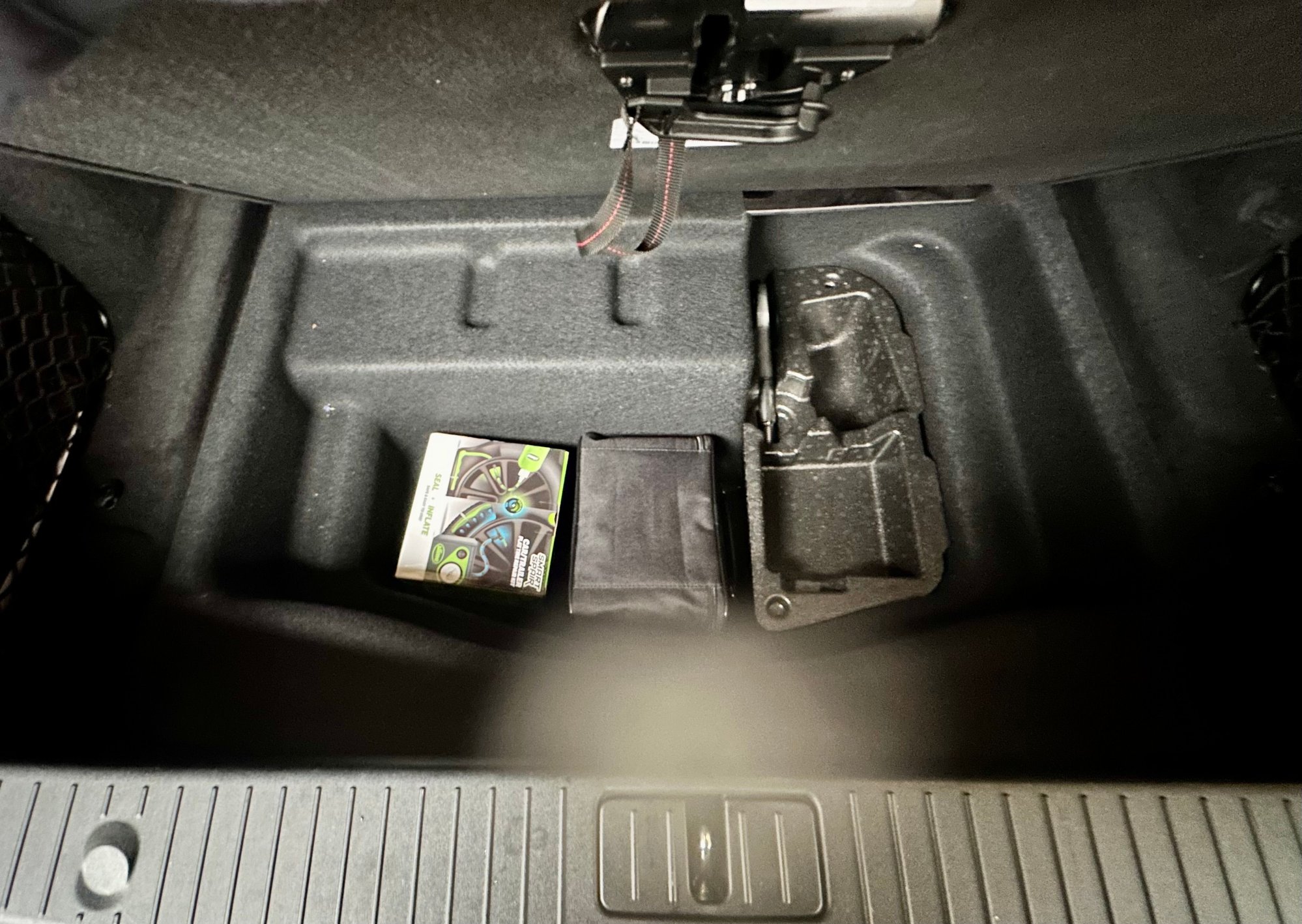

Hey this thing arrived today and it’s a perfect fit on the left or right side bungee area of the truck. Many thanks for the suggestion. I’m loving the non-run-flat tires and now I’m less concerned (still have tow if needed).

If your car is RWD, then it can likely be towed conventionally. But I would still insist on a flatbed.
Regarding that tire goo and pump set, this is what MB puts in their cars that don't come with RFT's or spare tires, so it's a good thing to have when switching to standard tires. Just keep in mind that if you do have to use it, it will likely fry out the TPMS sensor for that wheel and that will have to be replaced when the tire is repaired or replaced. When you lift the the trunk shelf, you'll notice that there is a good amount of storage where the spare tire would go, so you can store the pump and a set of jumper cables in there and not intrude into your normal trunk space.
Okay we will always make sure it’s a flatbed IF that ever comes up.
Great tip on the storage under the trunk shelf. Fits perfectly and I found an older smaller one in there which I will leave as a backup in case of failure.
Also noted on the TPMS. Makes sense. That’s a ton cheaper than replacing a wheel. 😁
