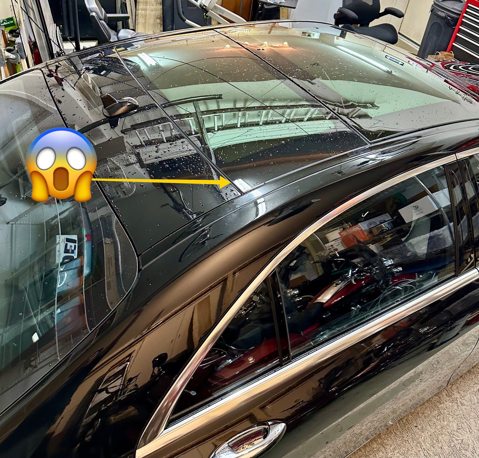

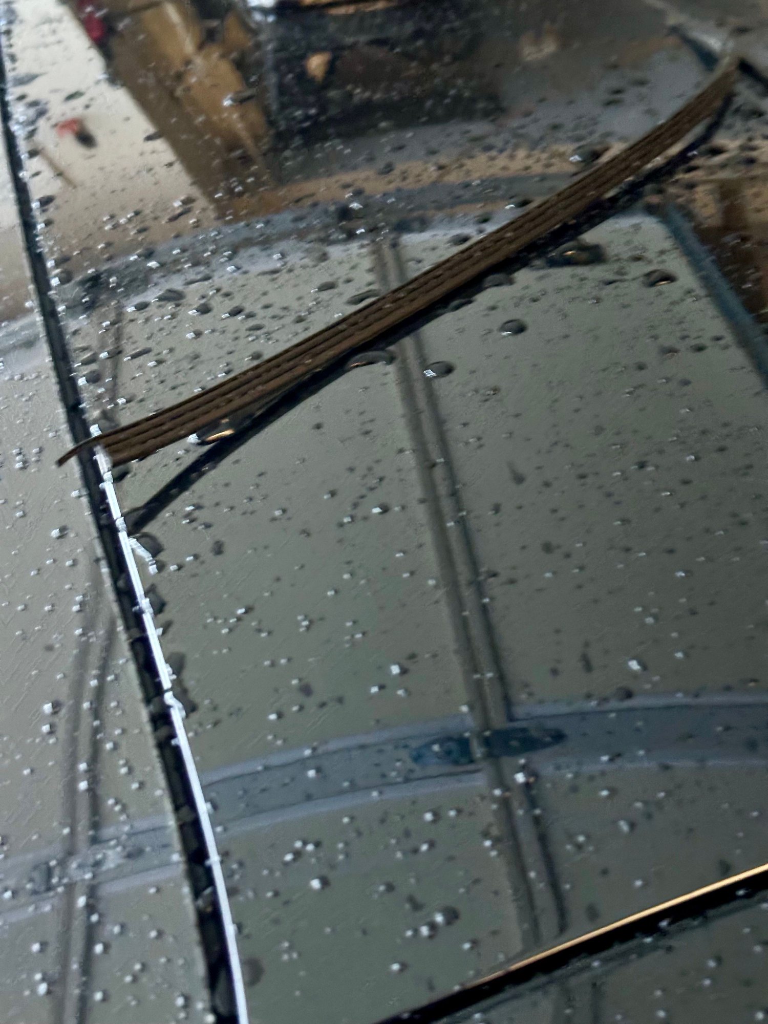

This is a terrible photo and I’ve already slipped this piece back into place. This is not the sunroof area but further in the back over the rear - I guess the rear moonroof?
I will brave the extreme weather conditions outside and get a better photo pointing out where this is exactly…
Barely made it back!
There are no leaks or anything that I can discern.
Any recommendations on how to fix this? My first thought is Elmer’s so help an idiot out please.

Sorry to hear about it, I'm not sure if that trim needs to be glued back ( if it was) but if it needs then you can use this :
3M Black Super Weatherstrip and Gasket Adhesive, 08008, 5 fl oz, 1 Per Pack from Amazon.
Good luck !

That trim it is not glued, this is where I have used the 3M stuff, one of corners of it was starting to come off.... well the, 3M fix it !

Second vote for the 3M weather stripping glue. The exact same thing happened/happens to my car. It first occured a couple years ago on my S550, then again on my current car a year ago, and I just used a little. Then it happened again after going through an automatic car wash, that was only a couple weeks ago and I used it again, this time more liberally. I had a tube laying around from using it on some other projects so I was familiar with the glue.

Question - do you just lightly put some on the entire length of the loose weatherstripping and stick it back in place? Is it better to apply a bit more at the end and let that keep the rest in place?

Mine was loose only at the end but, if I would be you, I would put some on the entire length !

Like most all adhesives, the cleaner the surfaces when appying the better the result. I did a hack job the first time, which is why it came loose the second time. I think it will come loose again because I didn't take the time to clean out the channel before using the glue. I plan to do it well in the Spring when the weatehr gets better. If you want to do it right, pull it loose several inches beyond where it's currently loose then clean the channel thoroughly. You can start with a mild cleaning solution, then use some alcohol to get it completely clean. The glue works best when it gets a little tacky, so apply the glue to the channel with a fairly generous bead, then wait 2-3 minutes before you press in the rubber strip. Some glue will ooze out of the edges, you can use a paper towel and more alcohol to remove the overflow.

Update - this stuff worked perfectly. The weatherstripping is kind of hooked into this slot so it wasn’t extremely easy to get out at first. But now that it’s in there with this 3M goop I’m pretty sure it will be in there forever.
Thanks everyone. Crisis averted.
