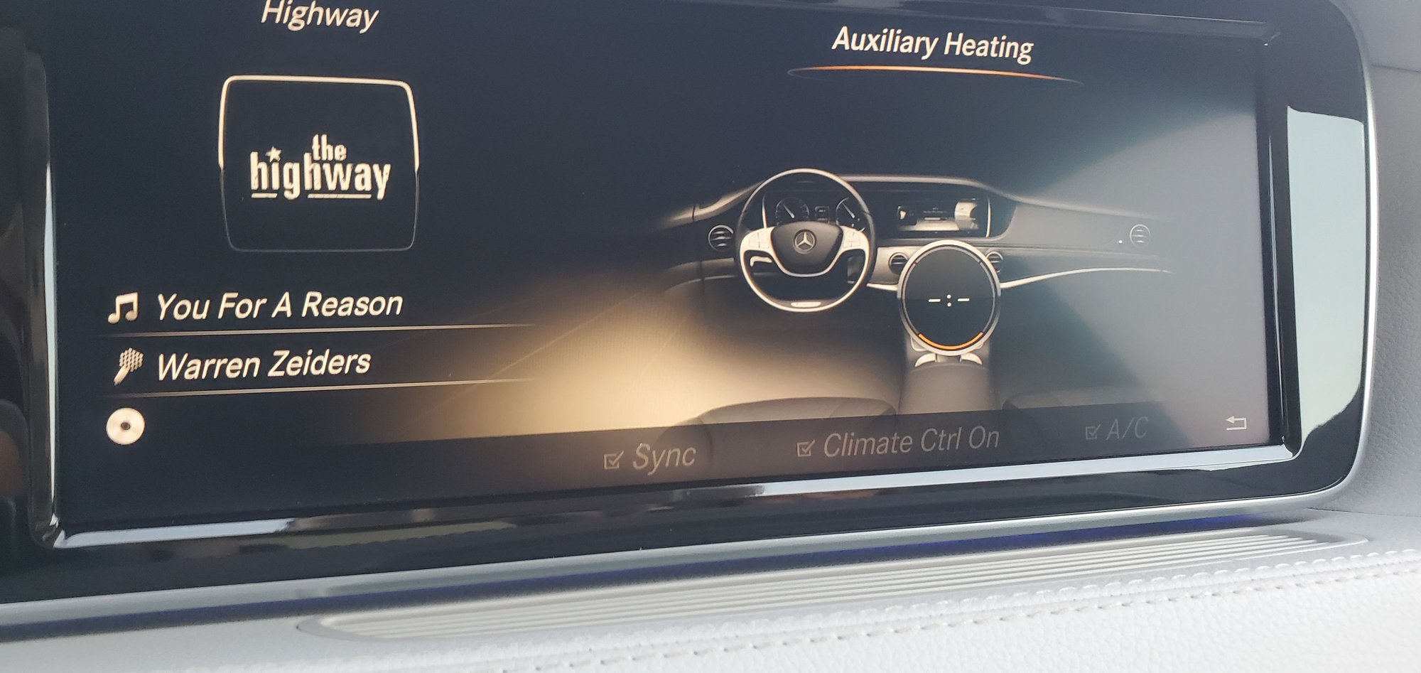

Took a 200 mile road trip today and on the way home, I noticed that when I changed the temperature that the settings weren't showing up on the bottom of the screen like they always have.
Selecting Menu for climate control showed one option - Auxiliary Heating. The AC still worked fine but I couldn't see any of the settings.
I took a few photos of the display and am curious if anyone else knows what this setting is and how do you enable/disable it. It shows 3 levels and when I select one of them, the clock/timer appears...
https://cimg5.ibsrv.net/gimg/www.mbw...7bf328203b.jpg
https://cimg2.ibsrv.net/gimg/www.mbw...9bb0de2577.jpg
https://cimg1.ibsrv.net/gimg/www.mbw...bd5b7c7c9f.jpg
Hopefully this helps: http://mbworld.org/forums/e-class-w2...questions.html

Appreciate the quick response but mine is a US spec car without an additional fueled heater which sounds like something a Euro spec may have.

I believe it is some kind of glitch as I've owned the car for a year now and have never seen that. After getting back home, I can't get it to appear again and the temperature controls now show up like they're supposed to.
I may replace or at least order a new auxiliary battery as I've heard that they can cause things to start acting up. Haven't heard of one making options appear that aren't installed on the car but I do live in the land of aliens so I reckon anything can happen. 😀

You likely had a temporary communication error from the HVAC unit. Monitor and if recurring inspect wiring.

That got me curious, were there any codes in the computer stored?

I'll check tomorrow to see if any codes were stored.

Sounds good, hope everything checks out. Might need a scanner that can read mb specific codes. Very generic ones might not read everything. Do you have XENTRY?

I've got a ThinkDiag 2 I believe.

I see, that should pick things up.
