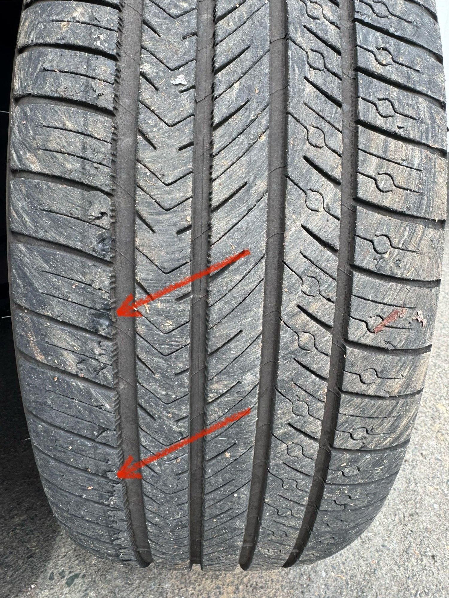

Inner tire tread damage
Hey guys,
Asking the tire gurus on this tire wear issue I’ve just now discovered. I have Michelin Pilot All Season 4s installed, on stock 19 inch wheels, so staggered setup and no rotations.
It’s about 32k miles on these tires and they’re at the last legs, almost to the wear bars. I was inspecting them and they seem to wear across the treads evenly, end to end. However, I noticed damage on the inner tread, the rubber seems to be breaking apart, just on the inner tread. See attached photos and red arrows pointing to the chipped rubber. These are the front tires. Both sides have this on inner tread. The car was aligned by dealer about two years ago, it still drives straight. I’ve had experience with inner tire wear when alignment is off where the inner edge becomes bald before other edge, this appears to be different so I’m not sure what’s causing this. Getting new tires this Thursday, going with Continental DWS 06 Plus this time around, since I’m not happy with the Michelin’s comfort/road noise. I’ve had the same tires on the E and C class and was happy, but on the S, seems so loud, maybe the weight of the car.. anyways, if anyone has an idea what is causing this, please advise. Thanks in advance!

Is your car 4Matic,
It looks like damage done by spinning the tires (as if accelerating hard across a bit of gravel).

Nope, not a 4Matic. It’s odd, I drive like a grandma 99% of the time haha, I don’t even corner hard or anything like that.

Maybe damage from turning your wheels when against a concrete park stop?

I just had a similar problem on my 2017 SL550, a Michelin Pilot Super Sport 285/30ZR19 with just 13,000 miles on the tire. The inside tread is showing wear bars. I'm a 77-year-old guy driving in Florida, stuck in traffic 40% of the time, and when I am driving, the car is NEVER abused. The same model tires 255/35ZR19 on the fronts were installed at the same time as the rears, but the fronts are showing little, if any, tread wear.

Those look like cuts to me. It could be from gravel, or something metal left in the road. Think of the Concord crash when it ran over a metal strip on the tarmac, that's what your tire looks like, but very minor in your case. 99% of the time if it's due to the car it will be around the entire tire, not just in small places.

Replies to the above: No, never rotated because the factory 19 inch wheels are staggered setup.
Doing research, I thought it was damage from road too, but I find that very unlikely, being it is only the inner tread that is damaged, on both sides, all the way around the tire. If you look closely, it almost looks like there's a line next to the cracks, as if it's scraping? But there isn't any rubbing noises I've heard or scraping. Maybe a defect in the tires? The "chunking" or chipped tread goes all the way around the tire, but not across the whole tread, as you can see in the pic. If it was gravel, wouldn't the other parts of the tire also get damaged? I'm going to see if the tire shop (America's tire) could chime in when I take the car in, perhaps its a defect and I might get some pro-ration back under their "road hazard certificates".

The guys at America's Tire (aka Discount Tire) can't definitely say what's causing it. They mentioned I ran through rough gravel? I said I had the similar thoughts, however, it's consistent wear in the inner tire on both sides and not across the tire, to which they agreed that would rule out rough gravel. They said likely culprit would be suspension related and I'd have to take it to a shop that can diagnose it.

I'm looking at that picture and that tire is nowhere near wear bars?
I would say this is toe related but if you got good life out of tires then that would not be it. Would be more inclined to say manuf defect.

It's awesome that there are aftermarket kits for adjusting camber. However, if this is camber issue, then wouldn't all the W222s suffer the same issue with the tires? I've had camber alignment issues where there is excessive wear in the inner treads, but it's obvious as you'll sell it getting bald on the inside more than the outside. Looking at my tires, its barely wearing faster on the inside, and this is what I found normal camber with all mercs I've owned. They tend to run a little negative camber for better handling. My issue doesn't seem to be a negative camber issue, like the post above, I am leaning towards manufacturer defect on the inner tread. The rear tires don't have this issue and worn beautifully across the treads. The Michelin Pilot A/S 4 tires come with 45k mile warranty, but only 30k miles if staggered and no rotations. Granted I have 32K miles and still some life left on these tires, I think my alignment is pretty solid.
I'm now looking at the the tread design and I believe it's just the nature of the tread, once it's worn down. This is a design defect in my opinion. See below picture. The left arrows point to a thin "sipe" that goes all the way around the tire. On a new tire, this is very evident and useful. See my worn down tire, that "sipe" or groove is worn completely flush, and I think the "blocks" to the right of that groove is a weak point, so it break off easily. Let's see how these new Continentals hold up, they don't seem to have a weak point in tread design. So far I do love the more cushion and quiet feeling, hopefully it stays that way.

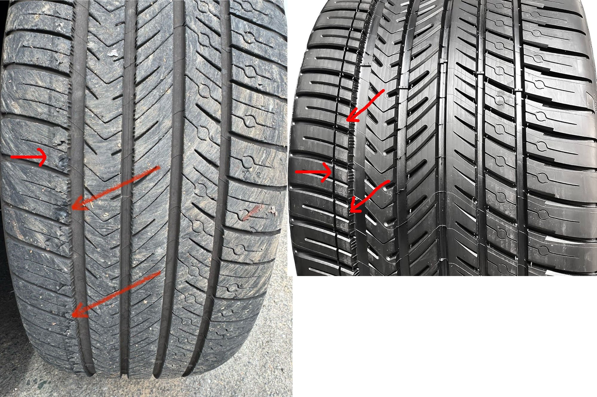

In looking at a new version in comparison to yours it looks like it's a load problem. Hear me out; it looks like overinflation, or underinflation. I realize you're running 19's staggered. 19's are going to have a lower load ratging than 20's on the same tire, and your fronts are not as wide as the rears. Take a look at the load rating and tire pressures.
You still have tread left at 32K miles--a tread that is worn rather equally across the footprint.
There is no indication of too much or too little camber, or toe for that mater.
So, I see no alignment issues.
It could have been something as simple as running across a bridge paved with water-dispersant steel road surface that "got" a from tire without "getting" either rear tire.

I don't think it's a camber issue, nor did the tire shop say it's camber. Look at the bottom of the picture, you can see the wear bars on the tire. They're pretty much identical across the whole tire, maybe a hair lower on the inner tread, but not to the degree where you'd think it has camber issues. Remember, from factory it comes with negative camber, a lot of BMWs have it worse.
Anyways, I can't take anymore pics of the tires since they're gone now. Over inflation will cause the inner tread to be worn down first, outer edges worn if under inflated. I run +2 psi higher than the gas door's PSI and am adamant about re-checking my tires every season (I have them balanced and the shop airs them correctly).
The tire shop said suspension and described what would be more consistent with what's called "cupping"...but this was a uniform damage on the inner tread.
