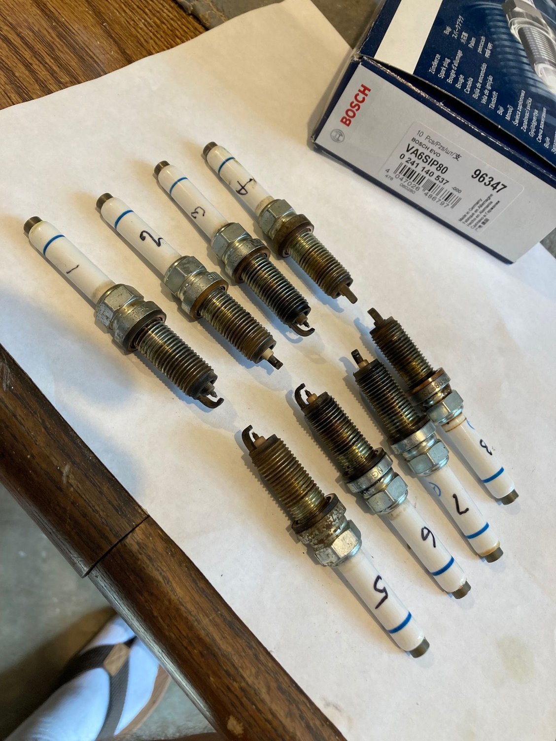

Plugs at 36K miles. Numbers 2, 6 and 7 had quite a bit of oil and are mostly cleaned up in the picture. I thought the change interval was purely based on miles, but these were six years old in my case ...

I had mine changed in December at 50k miles and almost 10 years old. The originals all still looked decent and probably could have gone at least another 25k miles.

Same - had mine done last fall as an early 60k service. Mine were 10 years old as well and my tech thought they still looked fine.

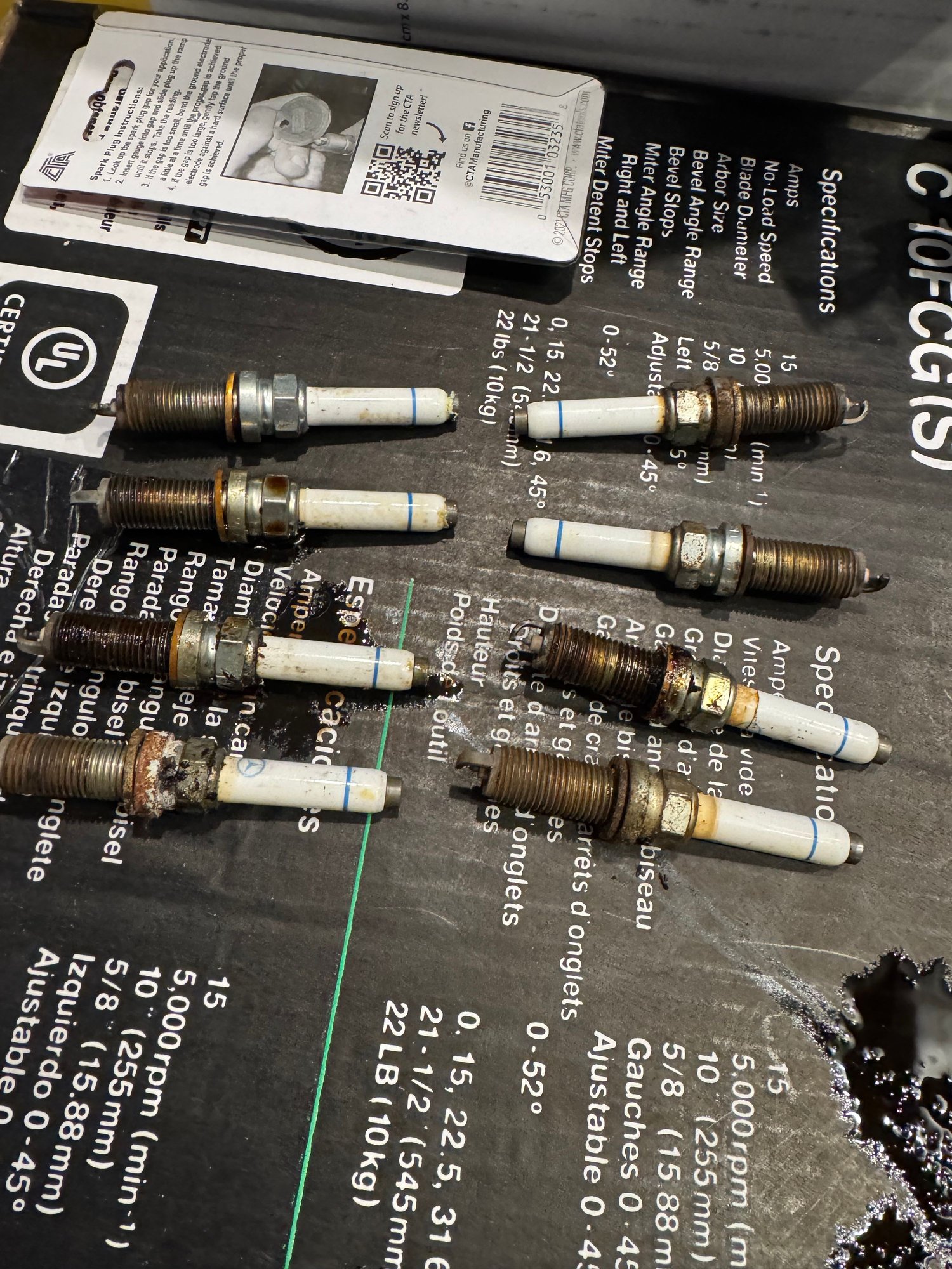

Here are mine after 2.5 years and 50k miles.....This was done at 92k miles...

Vinflouen, did you have some oil on yours? The white insulator areas look like they might have?

Here are mine, done at 6 years and 45K miles. Still looked good. 2019 S63.
