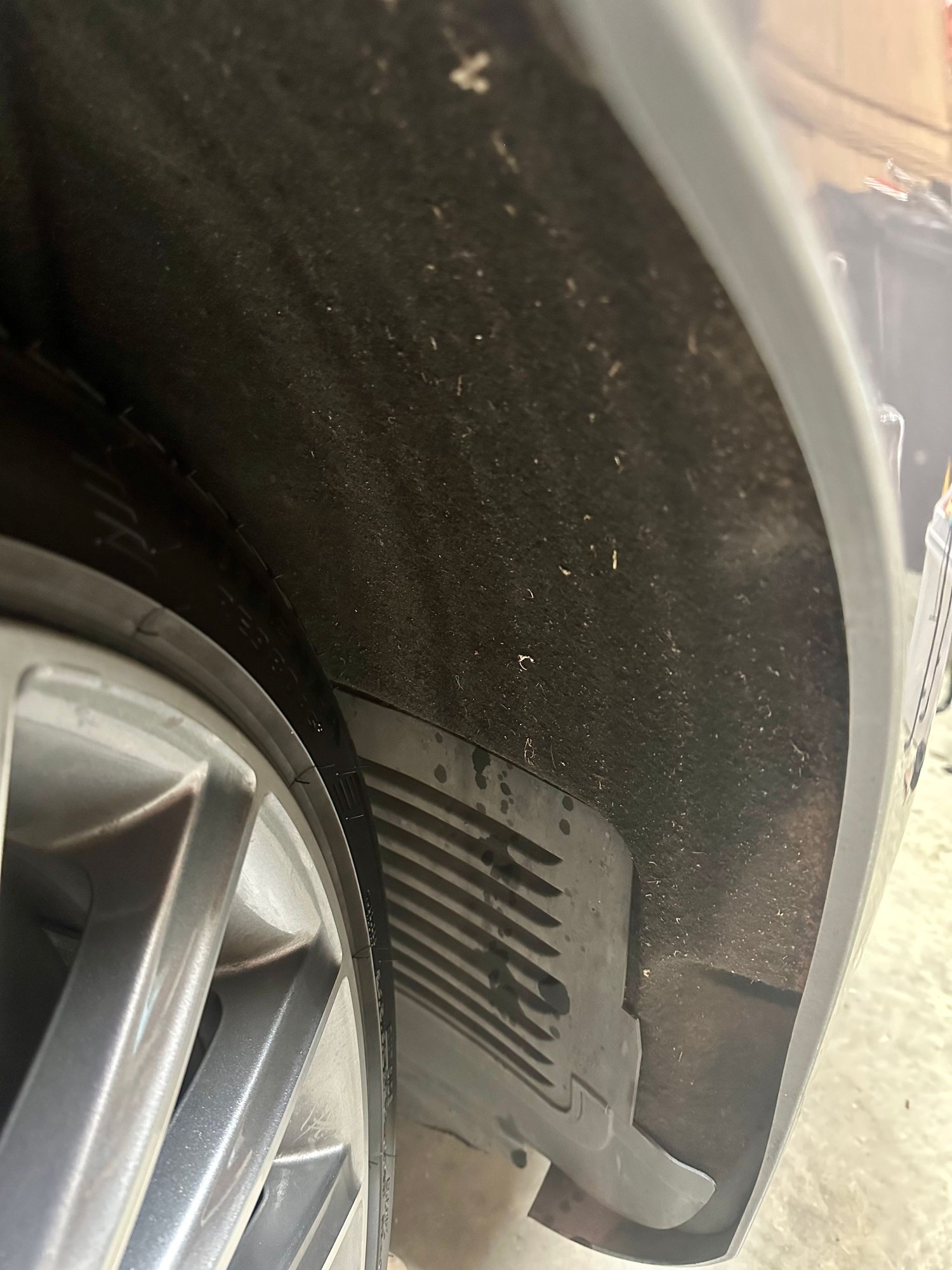

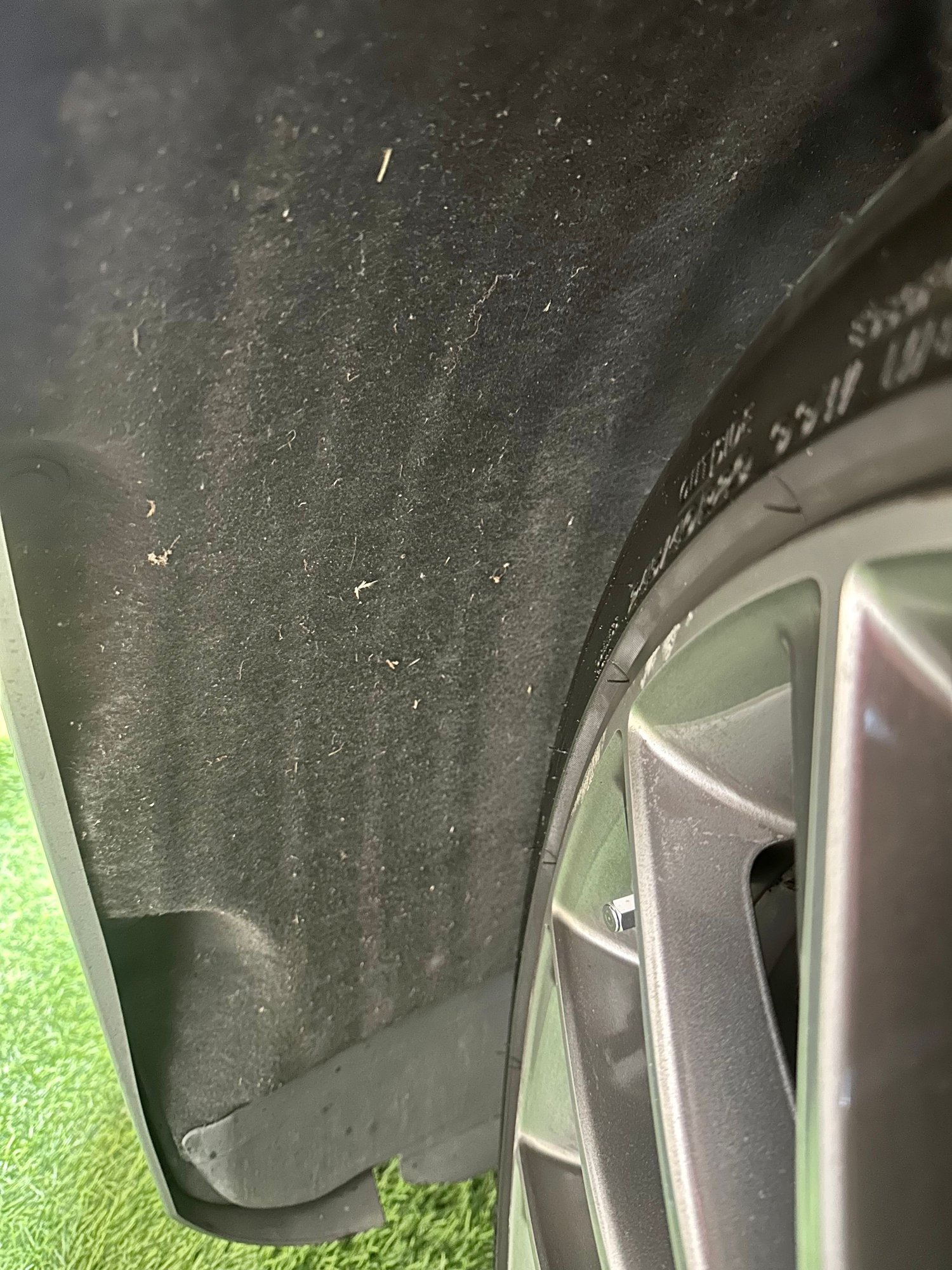

Noise When Going Over Dips
Is this a normal noise when hitting a dip at about 45mph? It also makes the noise with the suspension raised. This dip is in my neighborhood and I hit it daily.
The car only has 35k miles on it. I think the tires are rubbing the inner wheel well covers. The dealership says they cannot recreate the issue and the suspension looks good., No codes.
Any help is greatly appreciated.

Originally Posted by jcat
any sign of the tire rubbing the wheel well liner? That definitely doesn't sound normal.
Yes, there are striation marks. How could Mercedes miss this when a car is brought in for possible suspension issues?
The photo just shows normal lines from wheel slinging dirt and water. it is almost impossible for the wheel to hit the way you show. Trust me if it did, you would not have the simple squeak. I would agree with Tom.

Those "striation" marks look more like ribs in the wheel liner. Noises like this are typically a worn suspension component or possibly a strut. I had an airmatic strut that would "clunk" over certain speedbumps at certain speeds. A good alignment shop should be able to diagnose this.
I'm glad you nailed the recording. Hopefully someone will chime on with the proper fix as I'm sure this in common, It started on my car about 45K.
I never thought about the tires slinging water and dirt leaving a pattern. This makes sense.

Marks in wheel liners? The tires toss off water with dirt in a pattern that mimics the tire’s void spaces. Utterly normal.
