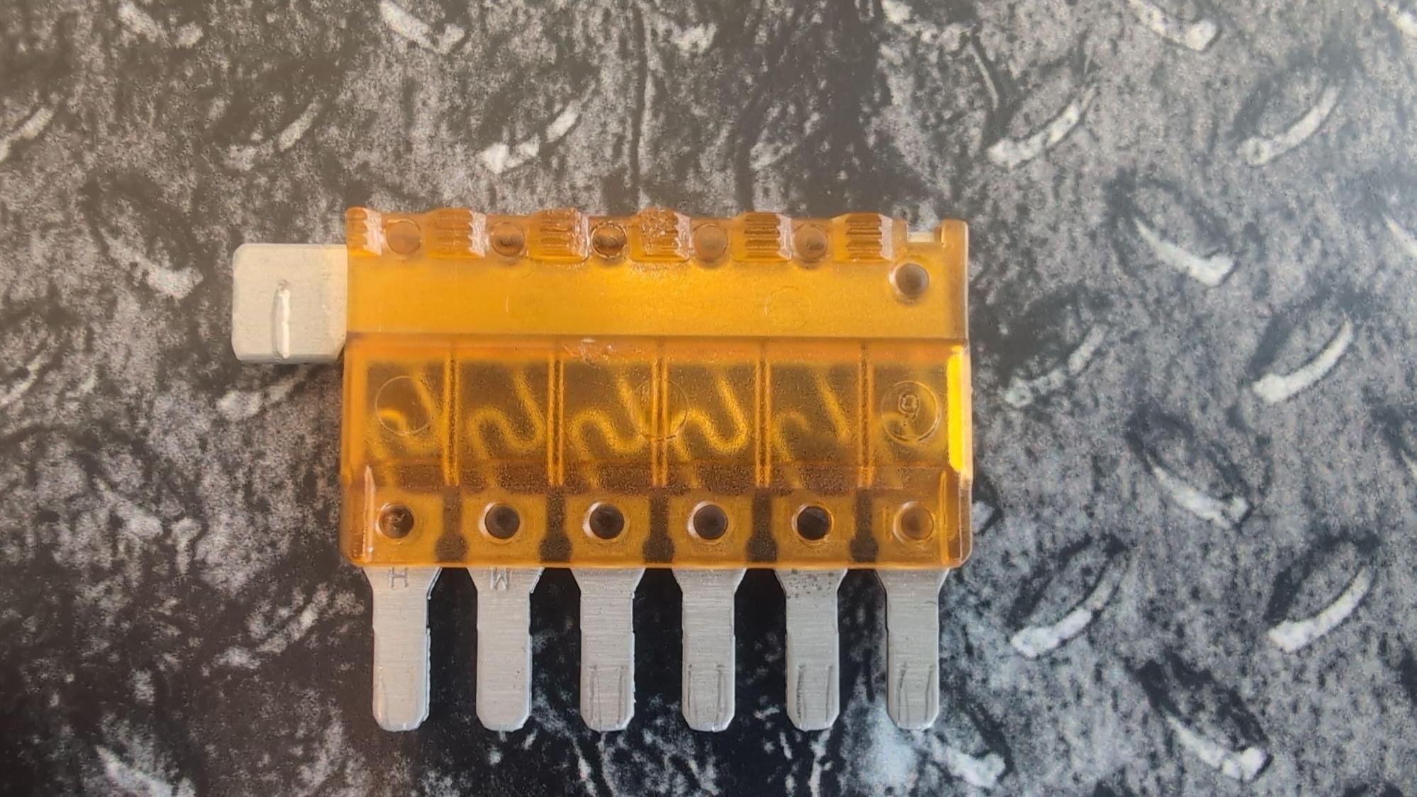

Fuse in the pass footwell.
Tech happened to have a good fuse, replaced it, and USB connector works.
If you're having issues with your front USB module, and you found a coin or foreign material in the SD clot like I originally did, you might want to check this fuse.

In all electrical problems, the first place to look is the fuses, and/or circuit breakers.

This but I will also add check the battery and plug in a scanner as well.

I did scan with Xentry, but didn't make the correlation with the rear module setting a code, while the front didn't set any codes. I was focused on the front module. Apparently, both USB / HDMI modules run off the same fuse.
Either way, seems like @trigital was right. Should have checked fuses.
