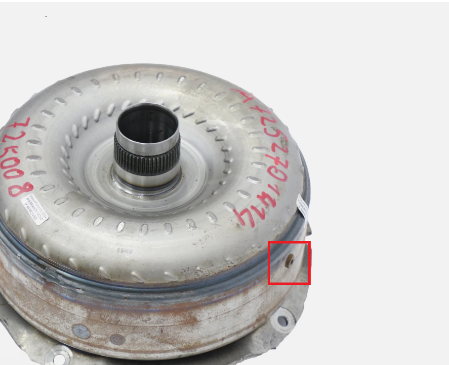

OP how are you draining the torque converter?
I’ve looked for a drain plug in my torque converter and don’t find one.
Reply 0
Oct 4, 2025 | 03:49 PM
It is there.
Bell housing should have two rubber plugs, round one right on the bottom and a square one a little off to the passenger side.
Turn the crankshaft pully to find the drain plug.
Reply 0
Oct 4, 2025 | 08:49 PM
what he said above.
pull the rubber plug off, in front of the trans, use a screwdriver w a cloth on it and spin the TQ, it will appear.
t27 will get it out.
about 4-5l comes out from there
