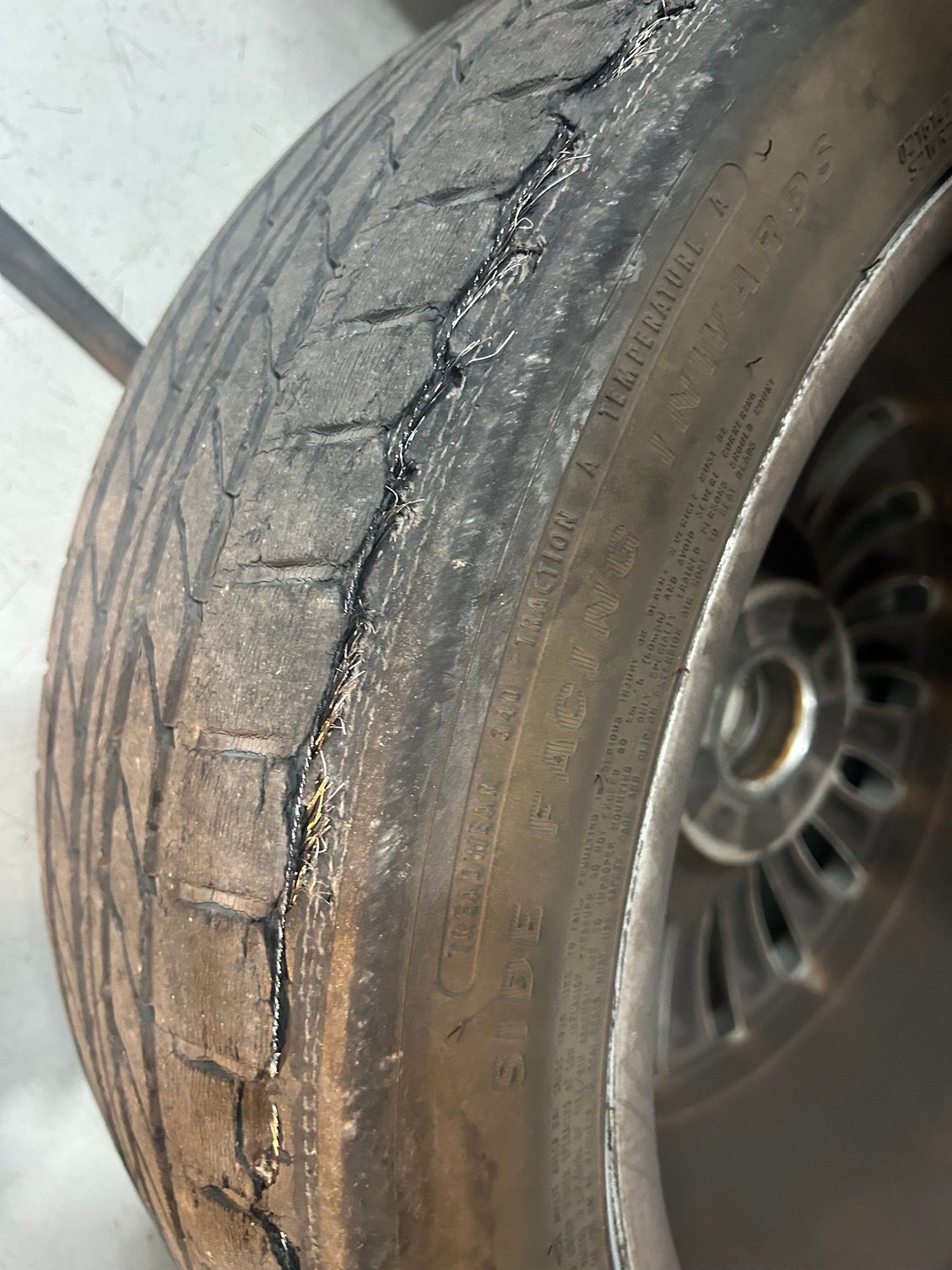

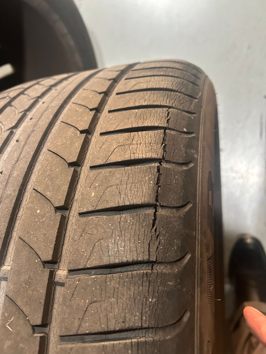

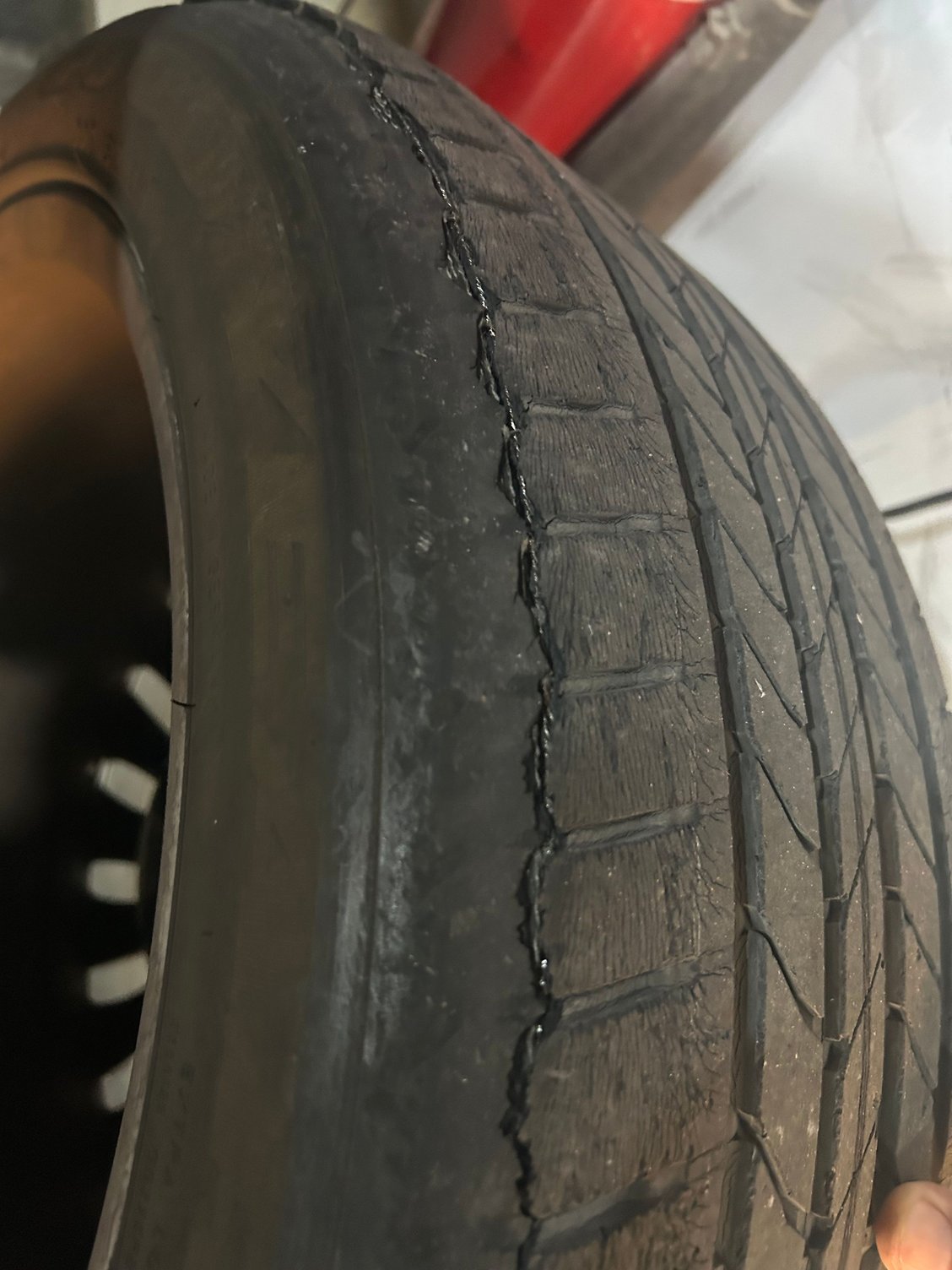

Hello fellows
Have any one encounter tires wear from inside, all 4 tires? Is it common or normal? W222, S560
Why the wear is not even?

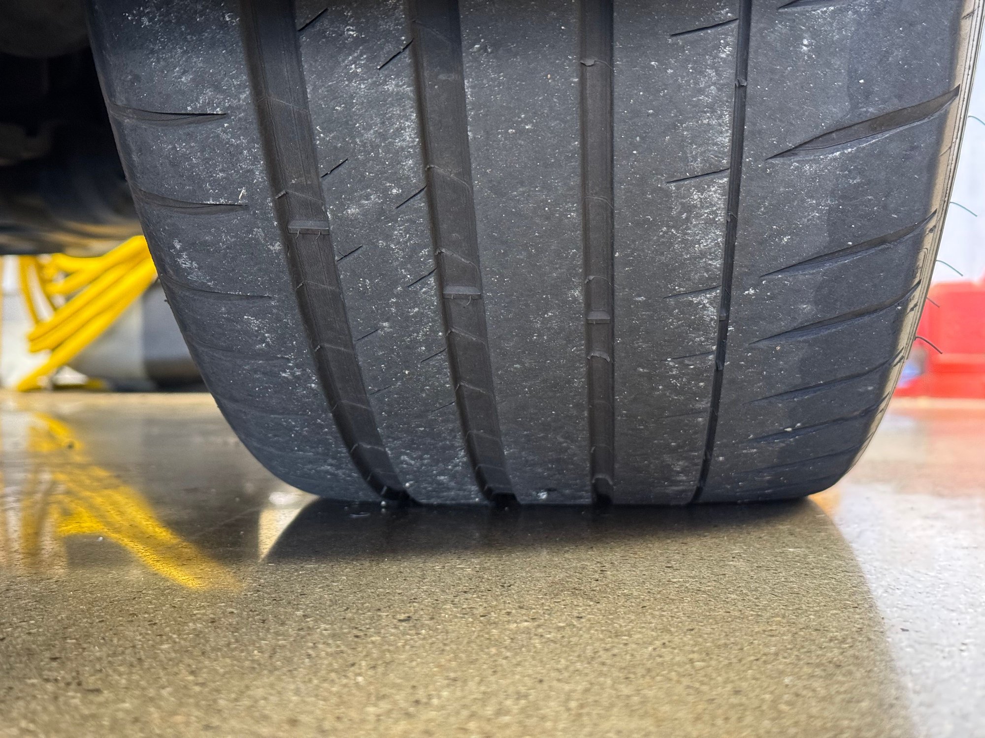

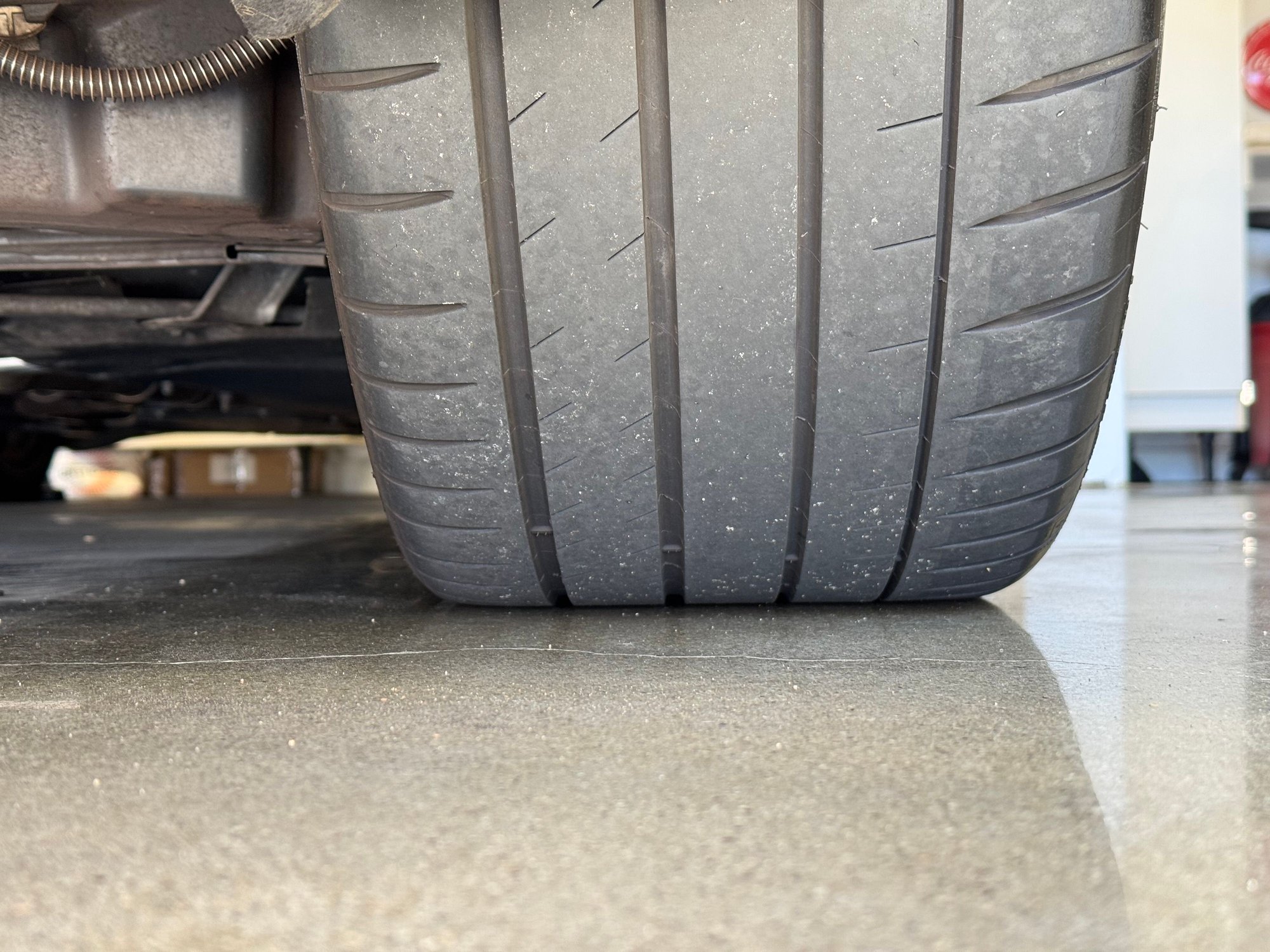

No reason the tires should wear unevenly if properly aligned and inflated. The dealer will also check for any suspension fitting wear that indicates repair is needed. Here is what my front and rear tires look like after 10K miles. They will need replacing in another 6k to 8K miles. Total vehicle miles is 54k. The wear is very close to even across the width of the tires.

OP one need not look too closely to see that your tires are separating at the shoulder, age cracked and ready to go kaboom at any time.
Treadwear doesn’t look bad considering age.
I suggest a fresh set of tires, good look for any suspension pivots that are worn and an alignment.

The tire wear pictured is most likely from an incorrect toe setting. If the negative camber is large enough to cause that wear then something is worn out or broken. The factory spec for camber is 1/2 degree negative for the front and 2 degrees negative for the rear. That is not enough camber to cause any inside edge tire wear. The pictures of my tires posted above clearly show that amount of camber produces no inside edge wear. What is a problem on these cars is the inability of the suspension to hold the adjustments. I find that my W222 needs to be re-aligned once each year to keep the toe settings within factory spec and I only drive it about 4K miles/year, 90% expressway.
There are cars here in SoCal riding on 15 degree negative camber, front and rear. Tires on those cars I have seen up close show inside edge wear but still not as bad as on the OP's car. Put K-Mac adapters on your car if you want, but they should only be necessary if the car is lowered or has wheels offset enough to be flush with the openings.
All my comments are relative to W222's with MBC. The AWD cars with Airmatic can have a different set of issues. In general it is much more challenging to get even tire wear. One of several reasons we decided to get rid of our E63S 4Matic. The K-Mac parts may be the only fix for many of the AWD cars. Some dealers will not perform alignments after the mods so be sure you have a first class alignment shop.

Looking at the first photo, there are a lot of "cracks" and I'm not so sure these are because of bad alignment and so on.
At that mileage they should not look that way unless they're old, which they're not or they're a ****... brand or they're used in a very hot climate.
Just my.02

I see, you have the V8 with Airmatic and AWD. That car came from the factory with 20" wheels and 245/40 fronts and 275/35's rear. All are EMT (run-flats.) Were it my car I would ditch the RFT's and put on the correct size for a 5,200lb car which are the MB AMG spec tires. These are 255/40-20 front and 285/35-20 rear and are not run flat tires. This MB spec tire has a (Y) speed rating and AA traction rating. The correct tire pressures to use with those tires are 44 front, 38 rear for normal driving with two people in the car. Make sure the car is correctly aligned with the new tires on the car. The AWD Maybach has almost the same suspension as the E63S 4Matic. We had to get the wheels realigned on our E63S every 6 months to get reasonable tire wear. The dealer comped us for the second alignment in the same year. We finally got rid of that car because of the constant realignment needs and the AGM batteries that failed at least once/year (4 batteries in 4 years.) I so much prefer the Lithium Ion battery in our S65's. Staying with the smaller sized run flat tires on the Maybach is a loosing battle in my opinion.
