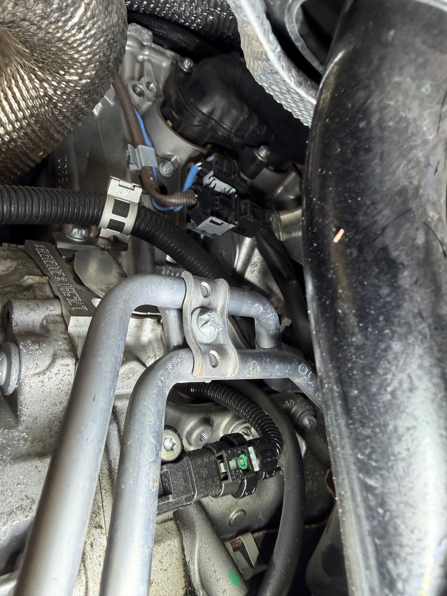

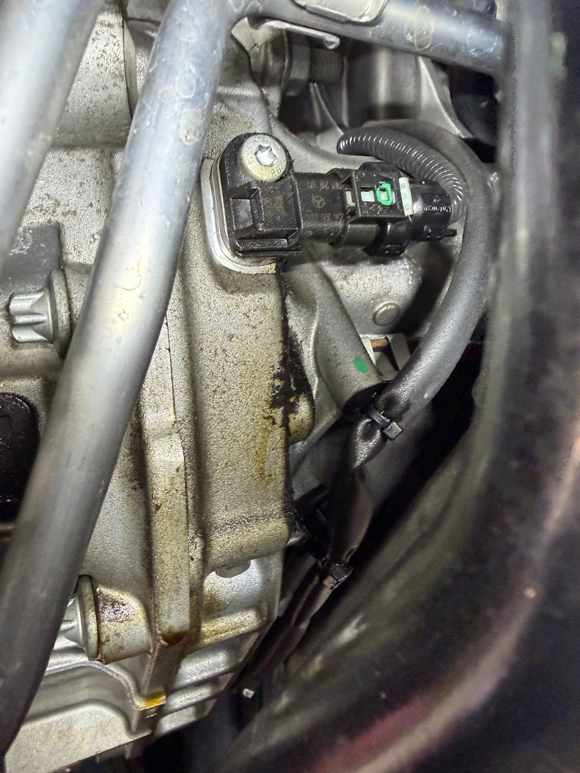

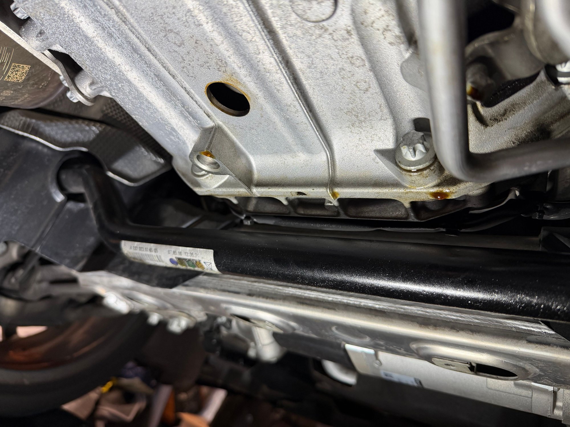

So I got under there to do the trans fluid and got some more photos.
I looked up, and I don't see a hint of oil. I think it's probably leaking from the rear main seal... what do you guys think?

Old Nov 17, 2025 | 02:50 PM
carlosinseattle's Avatar
Top Answer: 1
Joined: Aug 2007
Posts: 1,764
Likes: 764
From: Pacific Northwest
2001 S600 V12 Sold, 2011 Jaguar XFR Sold, 2017 S550 4-Matic, 2018 S63 AMG Sedan
Yours looks like a fairly significant leak. I thought that if the valve covers leaked bad enough you would smell buring oil on the exhaust, but not 100% certain. But like you said, the area above looks super clean, so I doubt it's the valve covers. Yours looks like a leak from below, most likely the RMS based on the quantity of oil and how it's all over your sway bar, I say that because it looks like the wettest part is between the engine and transmission. Maybe you could have an oil line leaking somewhere, that might be best case scenario. But like he said above; it's time to write the BIG check. Hope you have a good indy, or better yet, a warranty.

Old Nov 17, 2025 | 03:28 PM
SW20S's Avatar
Active Streak: 30 Days
Joined: Jun 2015
Posts: 8,805
Likes: 4,468
From: Maryland
2024 S580
Did you pull the back two plugs and look for oil? If there is no oil in there its the RMS...
