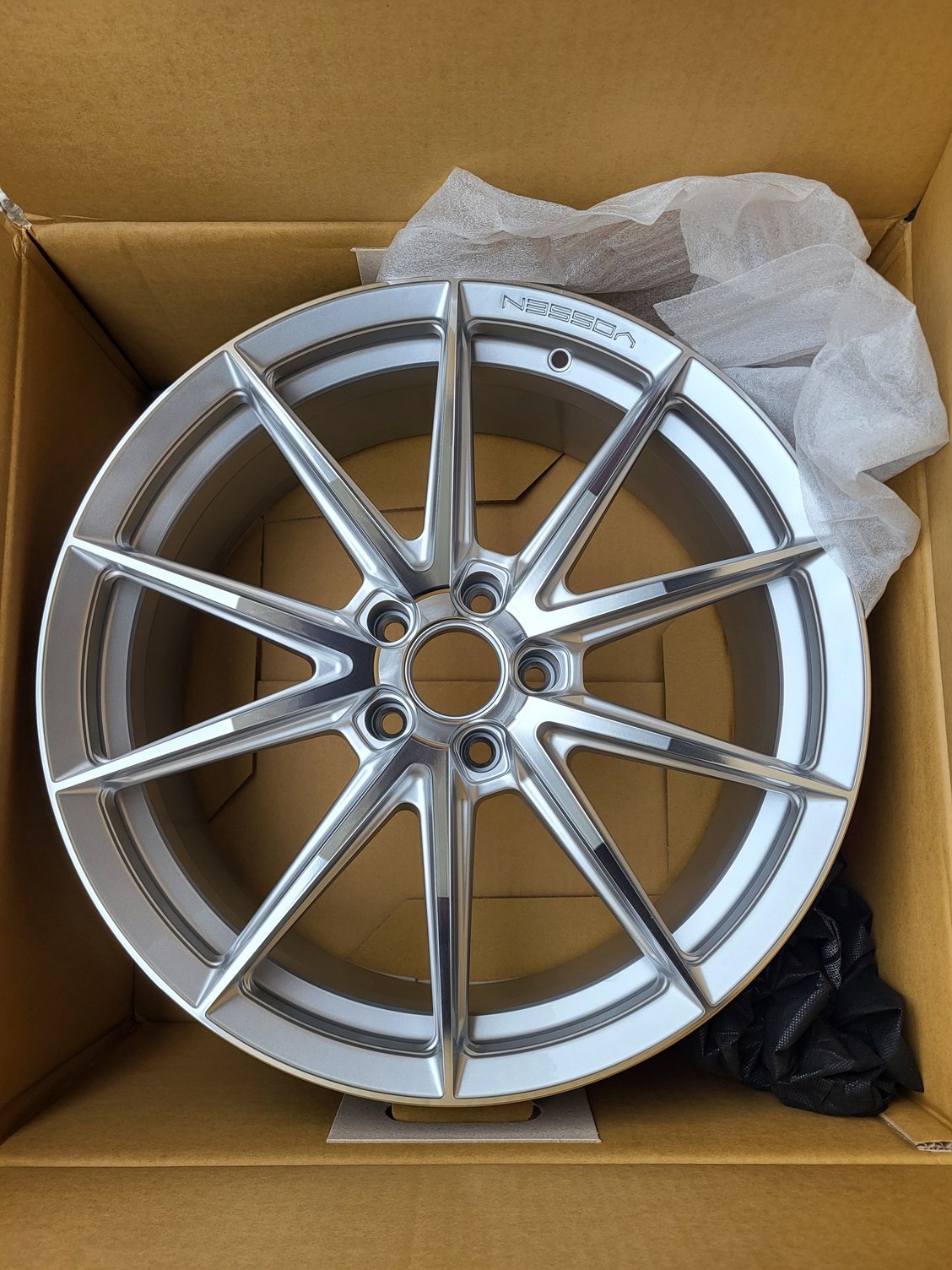

Wheels arrive this Thursday. Probably get them put on over the weekend. I'll throw up some pics when it's done. I think it's going to look really good.
