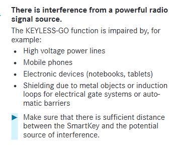

Maybe the car cannot detect a nearby Smartkey due to some interference (eg you have your house key folder or a mobile phone in the same trousers' pocket as the Smartkey)?

There must be some interference. I always have my phone with me. It would be silly if a mobile phone nearby would cause the smartkey to not work most of the time. Car is usually parked on my driveway, maybe 10-15 yards away from key hanging in my kitchen, or in my office parking lot maybe 20 yards away from my office desk.

Examples of possible interference according to the W223 User Manual
Also, check for a weak Smartkey battery too
