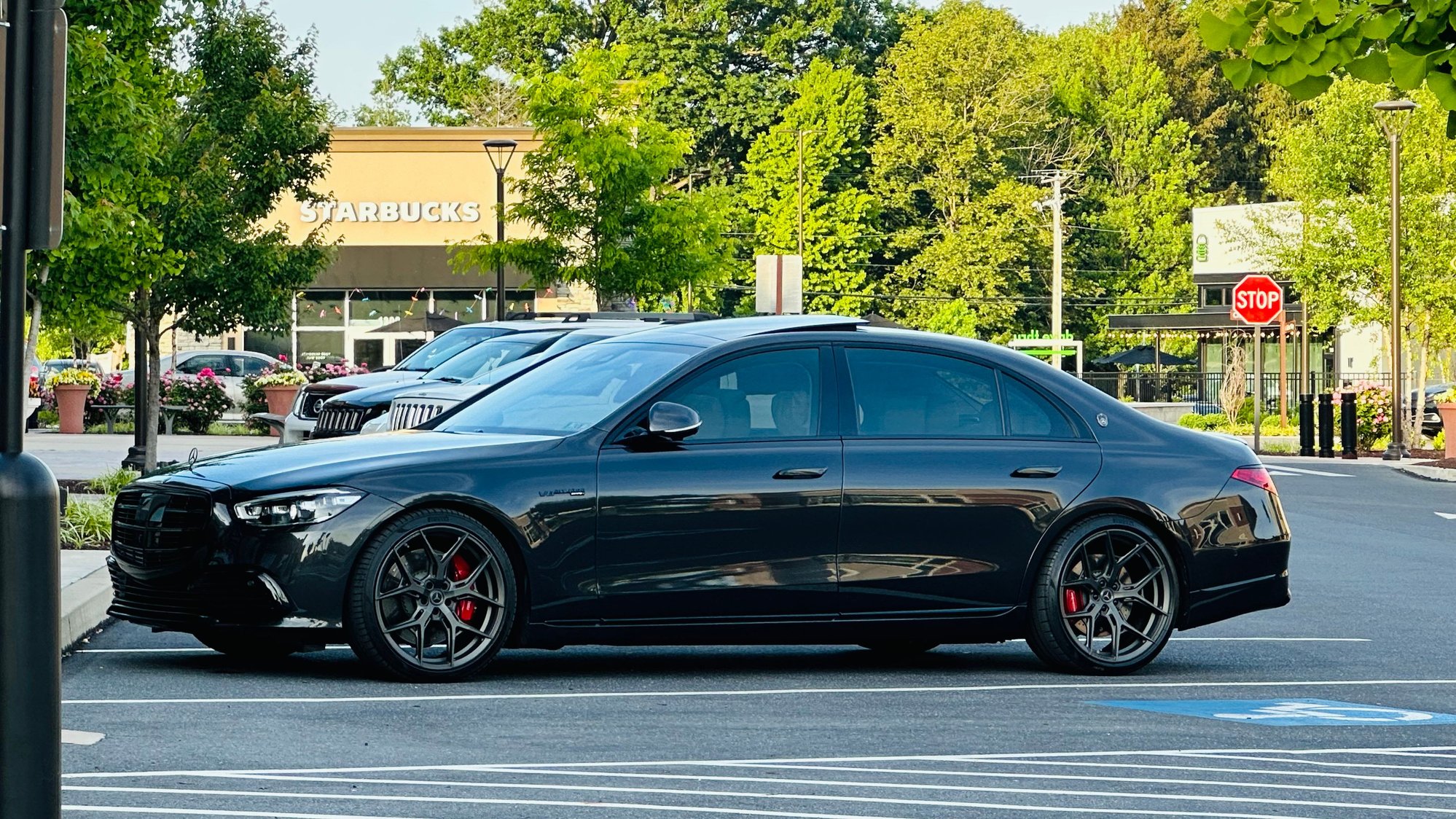

Quote: @Slammed63 : Did you pick up the new ride and lower it already? I opted for Ghost Link brand lowering links in place of OE. Stock 21's lowered in Sport+ mode.
do you remember how low you went? They said preset the front links are 5mm longer than stock and 4mm longer in the rear which is 1 inch lower. Your setup looks clean.

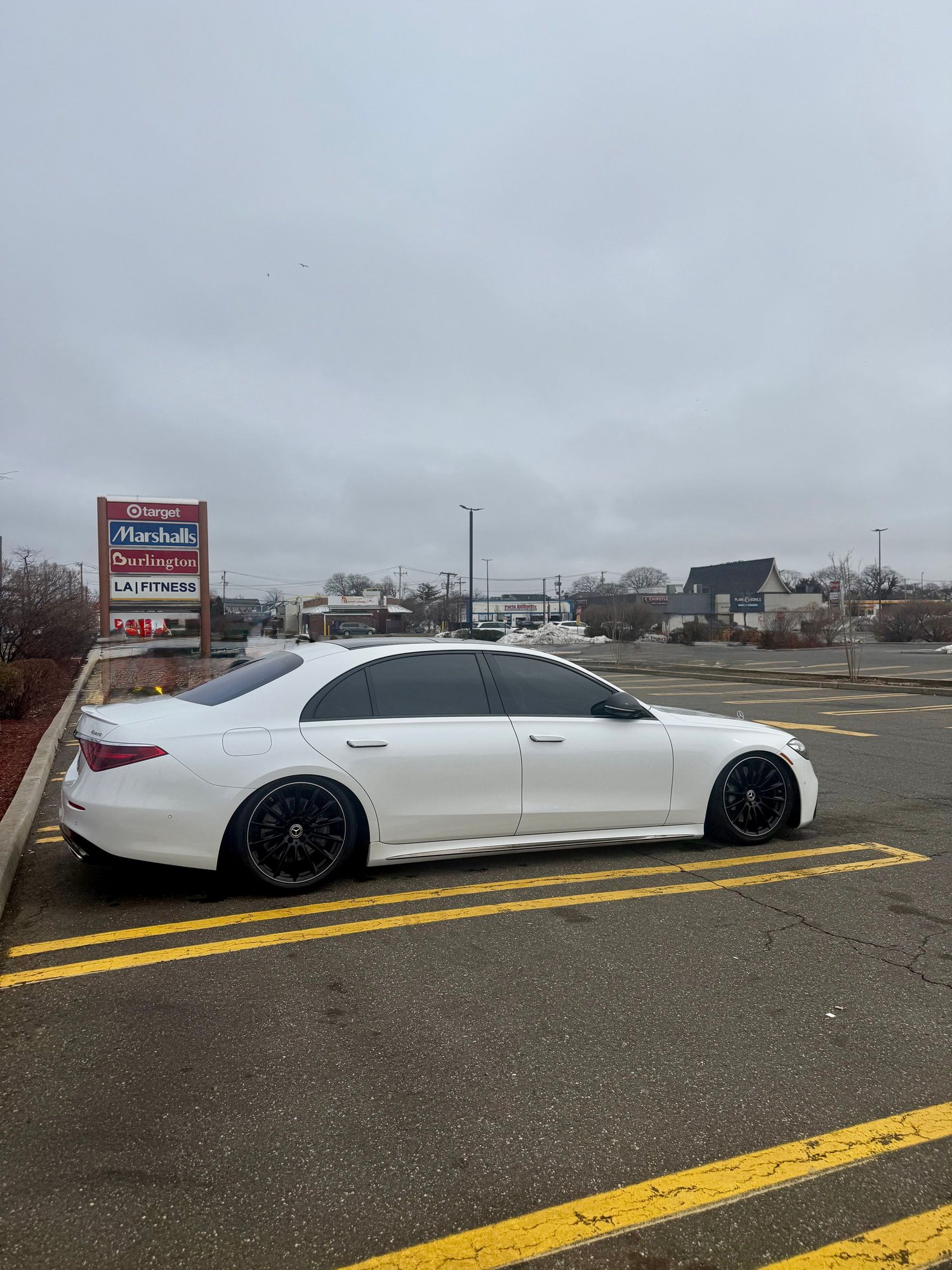

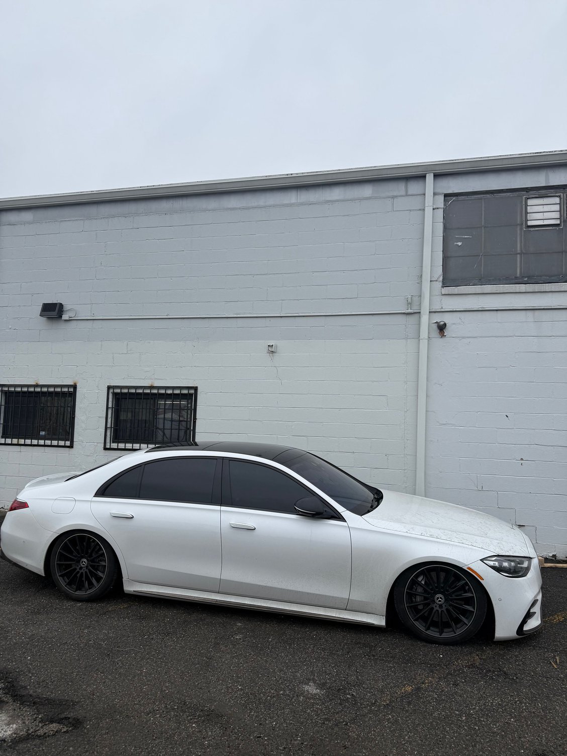

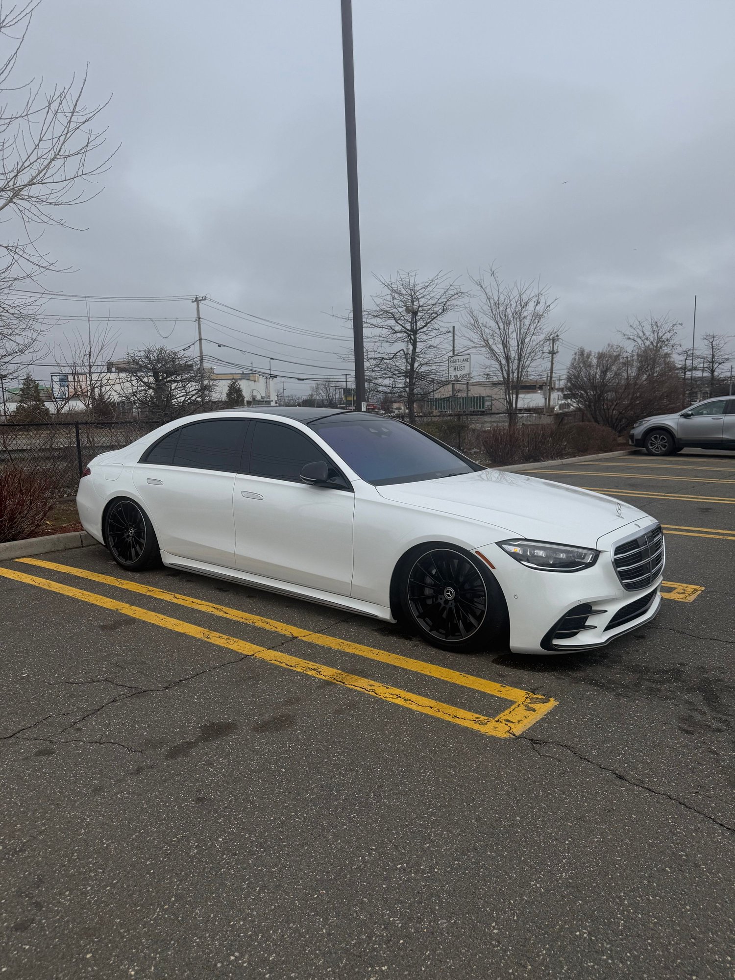

Lowered with mwm obd module
Hello all,
here is my 2025 S580
lowered with MWM obd module.
over all 100% happy. Quick shipping and easy install. No parts to change.
for the pics i dropped it down to -70mm over stock which is the max.
right now im driving around with -50mm and paired with the raise vehicle button in mbux it works great for daily driving in NYC

Mar 9, 2026 | 05:31 PM
  #44
Do you drive it around this way?
I like lowered sedans, but this is too much. I think the car would like awesome with spacers, and slightly (less) lowered height.
Reply 2
