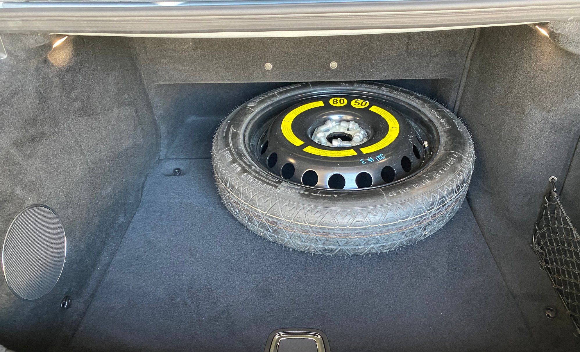

My 2020 S560 trunk with a W221, 19” compact spare. Jack & tool kit under the lid. I will do a test to see if this spare will fit my new S580, but I do believe it will. Run-flats or conventional tires, venturing out on longer road trips, out of larger metro areas, a spare is just a common sense necessity, at least to my way of thinking.

Yeah, that would be interesting to know if I could put a spare in. It would certainly impact my willingness to stay with the runflats. I will say, when I had my first tire failure, it was comforting to know I could still drive it to the dealer even as the air was running out. But, the cost is a less than ideal ride quality.

Did you try the spare on? I'm trying my W221 spare on tomorrow. Hope it fits.

My 19” compact spare, out of a 2012 W221, fits the rear only, which is OK. If I get a flat in the front, remove a rear, put it in front and use the spare in the rear. A hassle to be sure, but about .00001% of the hassle one can experience without having a spare and being stranded. I would never attempt to change the wheel on my own, unless there was no option for AAA or MB Roadside Assistance and I can’t imagine being anywhere like that. I will probably carry a “TireFit” kit as well, that can be used in the case of a simple puncture, as I have changed to non-run flats, see new thread.

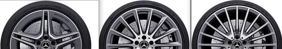

Perhaps Pirelli does have softer side wall, but I suspect the fact that a 21'' has so little side wall that its fate is doomed when it comes to potholes.
We all know but I still make this side-by-side pic to show a good clear visual comparison. 19'' vs 20'' vs 21''.
