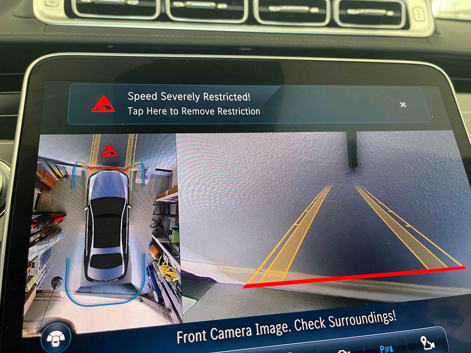

Hopped in my 223 today and much to my chagrin, the drivers display is black/unpowered and my center display shows an alert saying “speed severely restricted”.
Has anyone else encountered this? Wondering how long I’ll sit in the service lounge waiting for it to be repaired…

I had this but its a safety thing in the garage and not something to worry about. Just click the restriction button and it will go away and you can move forward or back as needed.

Gotcha RE: the speed restriction warning. My primary concern is the black drivers display. I think the speed restriction is a symptom of the drivers display not functioning…?

Hmm thats interesting. My front driver's screen is still working when this happens when I get too close to the wall in my garage and want to move slightly forward. I am going to find out how to turn this feature off.

Just for the record, MB service says “a computer shorted, should have new part in 3-4 days”.
So, not a platform-wide problem 👍.

Just for clarification, the speed restriction has nothing to do with the display. That's the Drive Away Assist which limits the speed when you first drive off and it detects obstacles nearby. I get this pretty much every time I pull out of the garage. It's not unique to the W223. They've had this for a while in other models.

Yup I gotcha - purely coincidental 👌
