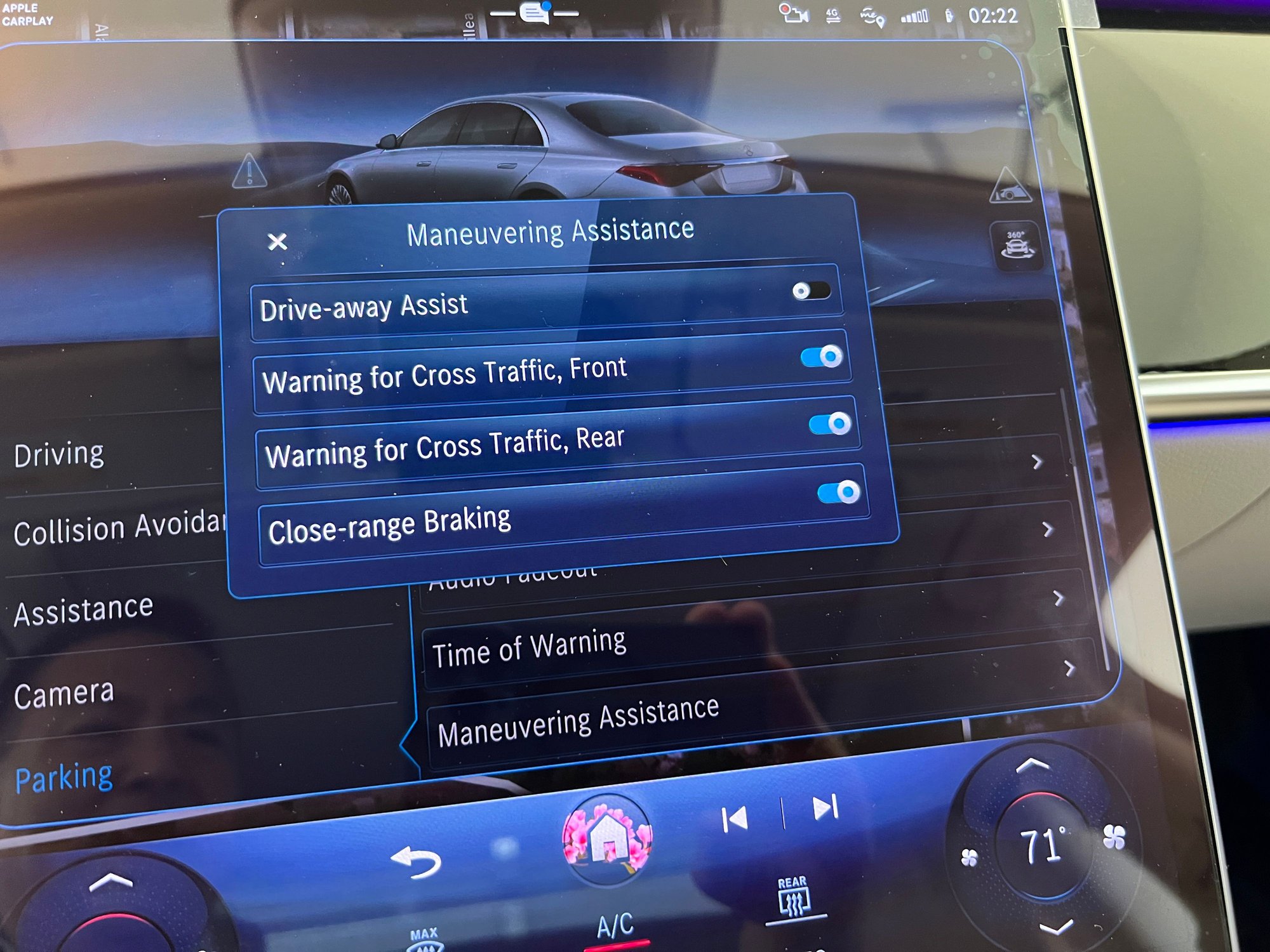

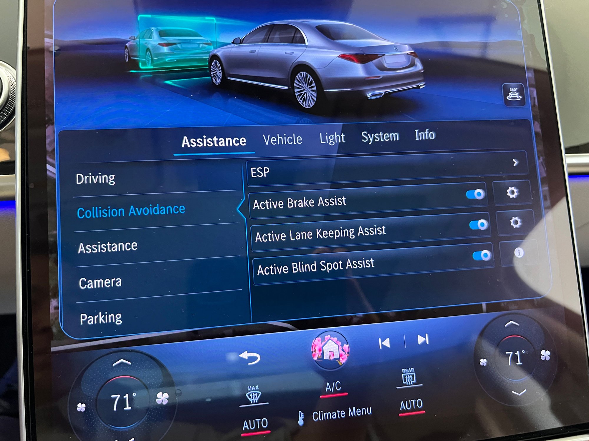

I know there’s another thread that was just created but I am also experiencing issues while backing out of my garage. It would slam on the brakes occasionally while backing out due to what I assume are close proximity items like the garage itself.

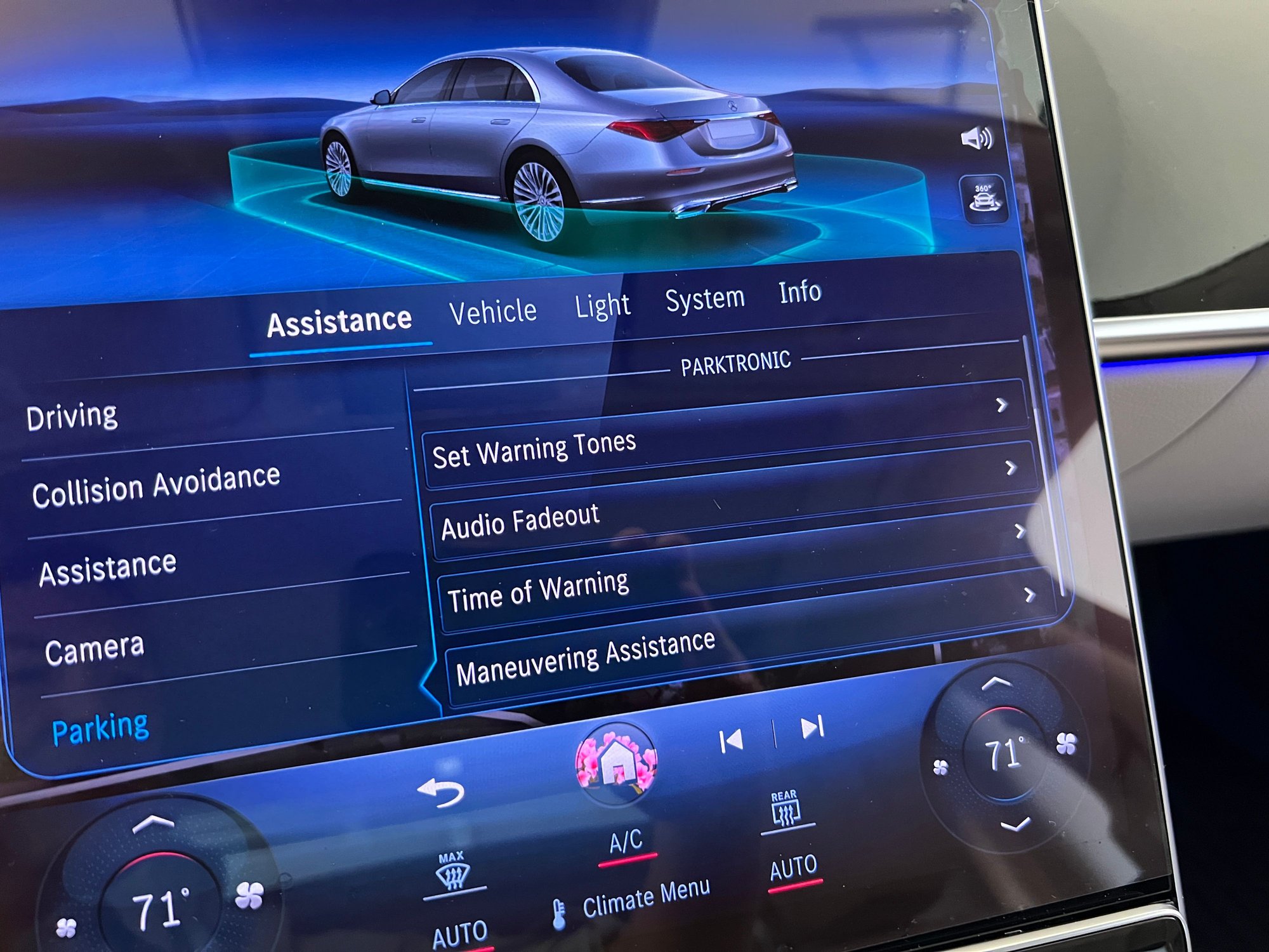

My question is this: which setting actually triggers this because I see two settings that, at least to me, could possibly trigger them. What’s the difference between the two? Does one work only while under a certain speed because how does it know I’m manually parking versus just going slow?
Collision Avoidance Submenu
Parking assist submenu (maneuvering assist)

For backing out, the responsible settings would be Cross Traffic, Rear and probably Close-range Braking under the Maneuvering Assistance settings. I would recommend you turn on Drive-away Assist, which you currently have turned off. Drive-away Assist briefly reduces the speed to 1 mph if it detects a nearby obstacle instead of slamming on the brakes and bring the vehicle to a complete stop. I park fairly close to the wall in my garage. The parking sensors go nuts, but it never slams on the brakes and only keeps me from going faster than 1 mph, which is enough to ease out and past the garage door frame.

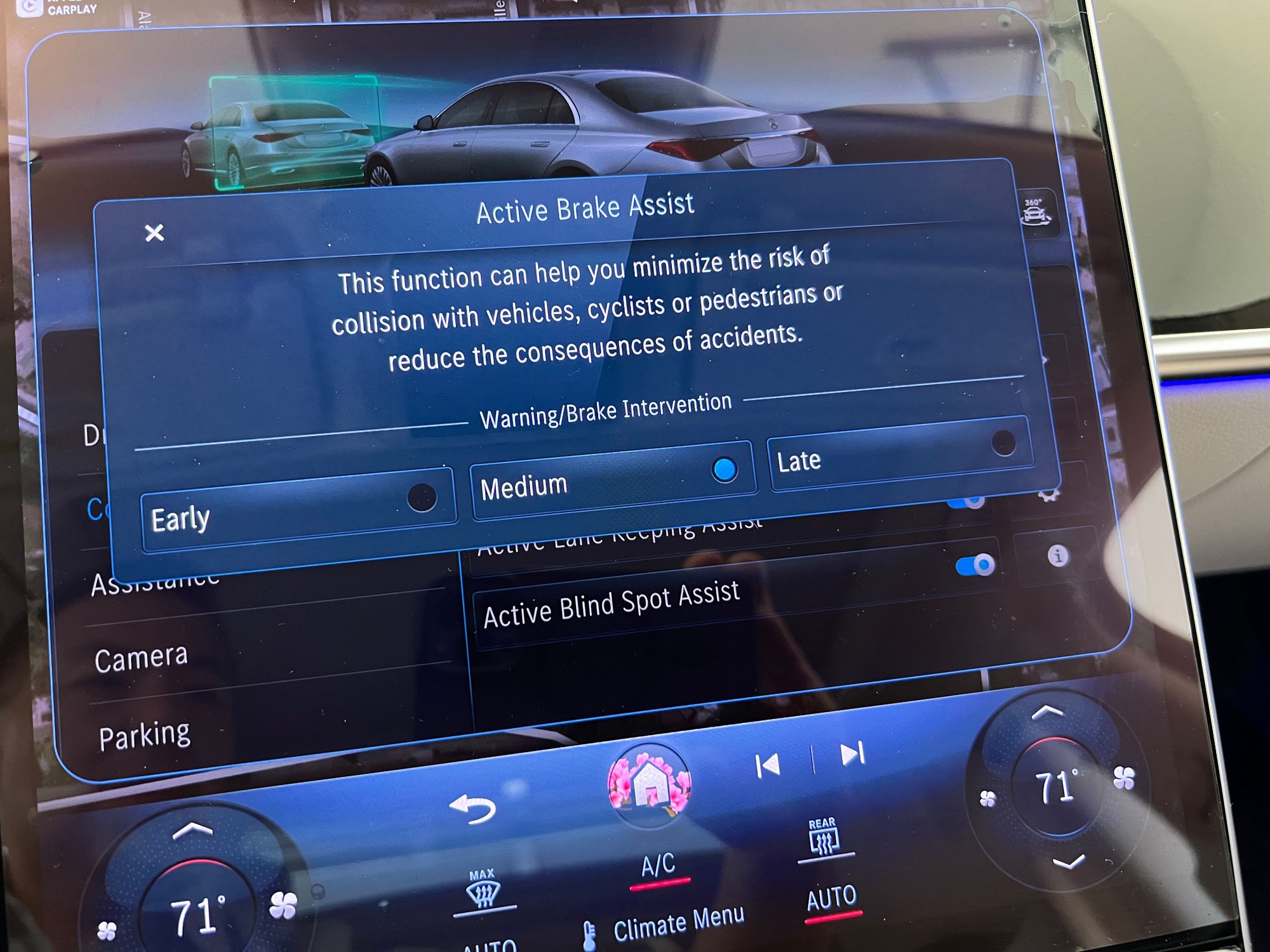

What about the EARLY, MEDIUM, LATE one for collision avoidance? That doesn’t slam on the brakes near close objects while backing out? That was the suggestion made in the other thread.
If it is close-range braking, then it’s just all or nothing? There’s no way to turn down the sensitivity?

Nope, that's for forward collisions.

Also, the braking that I experience backing out of the garage is the “Close-Range” braking feature because I finally paid attention to the message that popped up when it happens. I ended up just turning it off.
