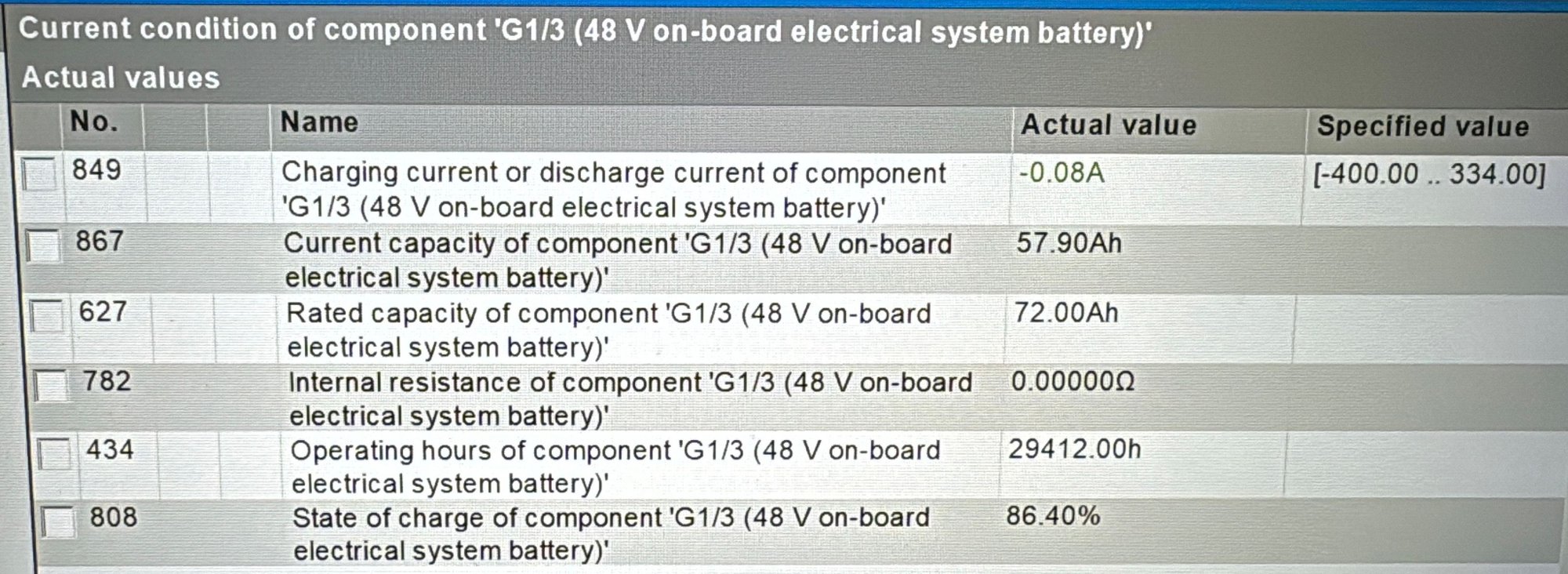

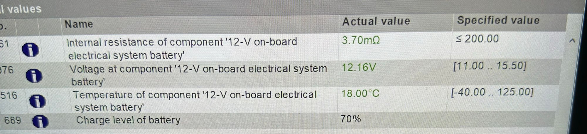

I left the car at charge at night and what i see on xentry was pretty weird. The car only charged the 12v battery to 70% (it was like 65% when i started the charging process)
And my 48v battery was at 70 or 73. After the charging procsess it was 86.5%
Soo.. What might be the problem? I really cant charge my 12v battery just due to this weird problem.

Originally Posted by wildta
Let us know what happens with both state of charge %s when leaving it on longer than overnight. I'm surprised that the DC to DC would increase the 48v beyond 80%. I would just assume that the BMS would keep the 48v around 80% for longevity, and then only charge the 12v to 100%.
it ends up like this

SOC vs volts?
Originally Posted by Diesel Benz
Just to clarify, I was hoping you would have access to Xentry diagnosis prints like TSA shared. He felt he had a problem but his car may have behaved just like yours, perhaps there is none.
The MB app just shows "charged" for the cars in our family, I've never seen it show "fully charged" even after the car battery had been fully charged with a CTEK. I don't think we would know if Xentry would show 70% or 100% SOC in this case.
I was curious how Xentry rated the SOC at 70% while the voltage is 12.16. I thought 12.16 would be less than 50% SOC?
I did not pay attention to the voltage figure. Not sure how low the battery voltage could be when loaded, assume engine was not running but diagnosis ongoing meaning most of the car fully active. There should be an amps reading too but I did not find it from the posted figures.

Well, my device also shows “fully charged” but it’s nowhere near to full. It gets stuck in 73 or 70. As it shows on xentry.
I have no idea about it.
and in that photo my charger is also hooked up to the car. I sometimes don’t even think it’s charging. It’s 10amp or so but it’s not charging at the full 10amps. It makes no difference with on and off the car while the car is in accessory mode.
