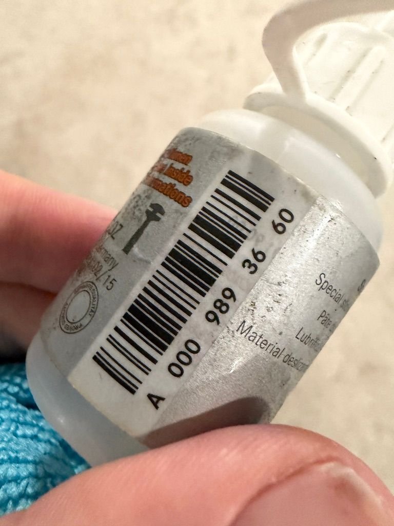

My seat base had started making some noise again, I highly reccomend you pick some of this up if you have issues like this:
https://www.pelicanparts.com/More_In...nlo1hYOp2RlDYH
This is a lubricant that you can put down into the cracks in between the plastic parts of the seat base which quiets the creaking. Works incredibly well and wipes right off the plastics and all without being greasy. This works between any plastic on plastic creaking also, just put it in the seam and then manipulate the materials and make them interact to work it in and the creaks just disappear. The dealer left this little bottle in my S560 after working on its seat years ago and I have kept it.

Genuine OEM Anti-Seize Agent | 000-989-36-60 | Fits Select Mercedes-Benz Classic USA Parts Store
