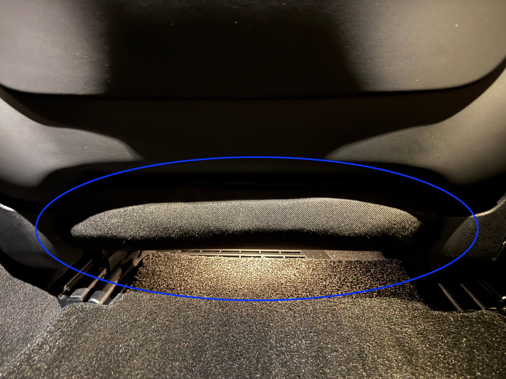

Like many others here I have had issues with a creaky drivers seat. The car was just in for the 10k A service and I brought this up. They kept it for 3 days, ordered a special "lubricant" from MB and lubricated everything and its "all fixed" well, of course I get back into it and immediately its still creaking and has not improved at all. So, I decided to really dig into what was causing it to creak. Turns out its really simple.
Behind the seat there is a piece of fabric that finishes the look of the lower seat:

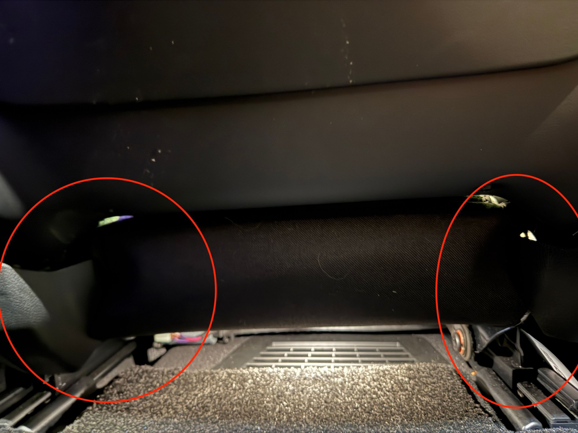

This fabric causes tension on the plastic trim coming around the back of the seat base in these areas:
So, I shoved the fabric back into the seat and pushed it on the sides beyond that plastic trim so now its in front of it and no longer interacts with it:
Creaking is 100% gone. Even in a parking garage this morning with no radio and no HVAC on listening, there is no creaking at all. I'm astonished the dealer is so stupid they didn't see this.
Those of you suffering from this, try it!

Thanks! This is why I like forums like these!
Aside from the usual "bashers" - this type of thread is always helpful!

I’m astonished the dealer didn’t find that, and I wish I had looked at it much sooner!

I followed the instructions provided by @SW20S and while the driver's seat squeak is better, it's still there on some turns, or while adjusting my seating position in the seat. Maybe I just need to rinse and repeat the steps?
Old Mar 18, 2025 | 01:14 PM
SW20S's Avatar
Active Streak: 30 Days
Joined: Jun 2015
Posts: 9,062
Likes: 4,565
From: Maryland
2024 S580
The plastic around the base of the seat also makes noise, but remember mine had just been lubricated by the dealer so thats much better. You can try getting some of that Krylox and putting it in those plastic seams.
Mine isn't SILENT, but its 95% improved.
